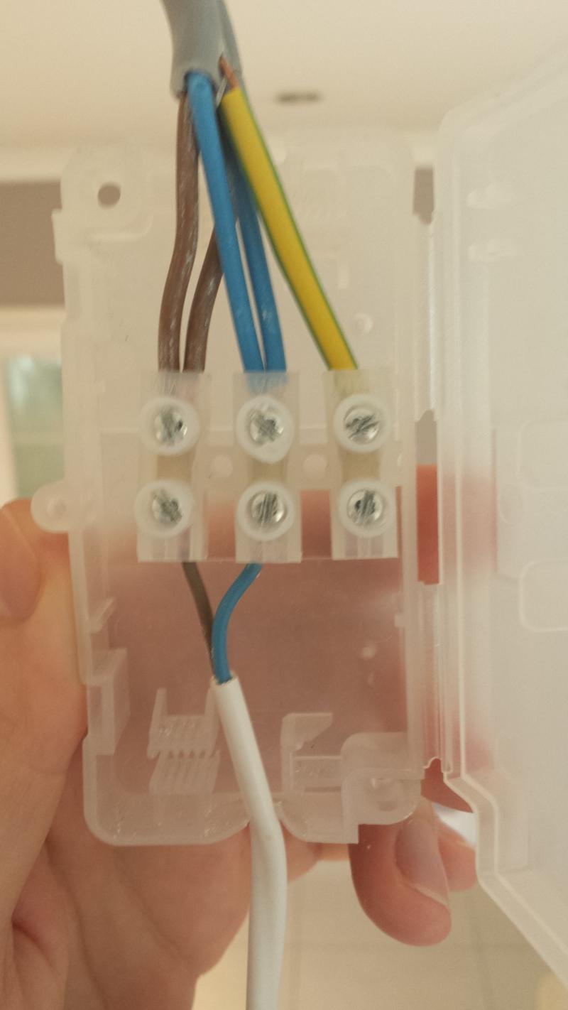

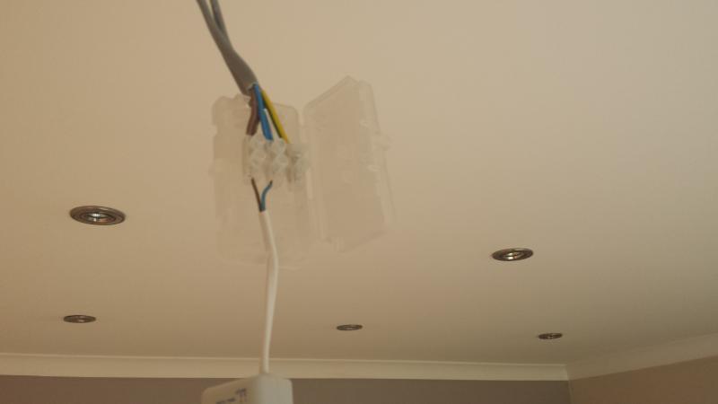

I know there are countless articles on this topic across the web but am really getting differing views/ opinions so figured best I post here my exact issue/ set up.

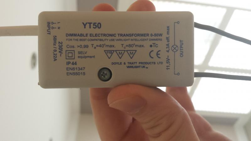

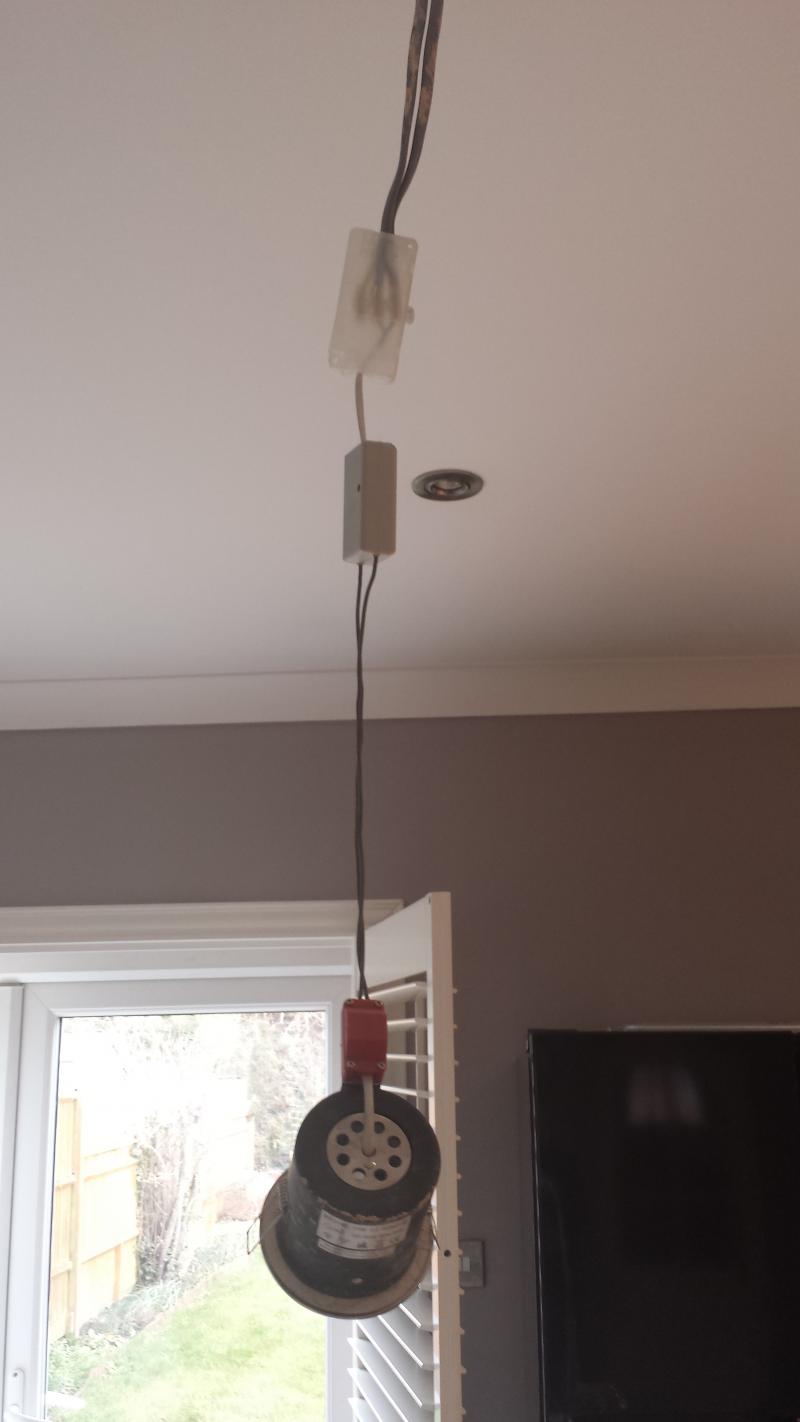

Basically I have a total of 23 MR16 Halogen downlighters controlled with one dimmer for 12 and one for 11. I have decided to change them to LED's but have numerous questions/ queries. Attached are pictures of the current wiring I have. I have read about LED Drivers if you have electric low voltage transformers, which I am pretty sure I do have (see pics). But then it gets confusing as to what type I need as I have dimmers and finally the cost I should be looking at per light.

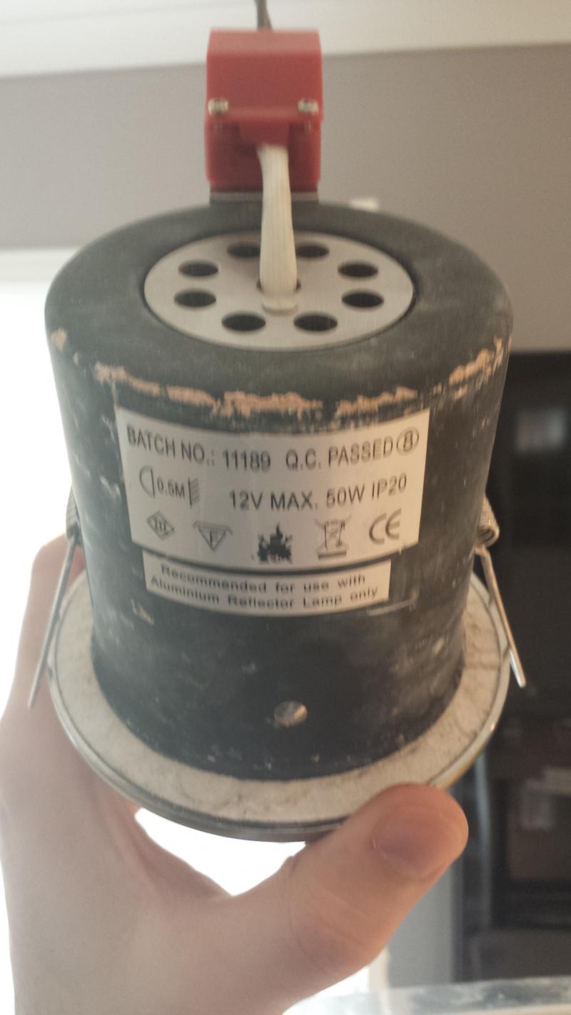

So, to replace (judging by my pictures) the halogen lights I would need to remove the white box (Transformer) with an LED Driver that is Dimmer friendly, leave the chocbox in place and just wire that to the new transformer and then the transformer into a new downlighter? Can I keep the downlighter? And should I change to GU10 whilst in the process?

However the round fitting you show are likely a simple transformer and will work OK with LED lamps.
The electronic unit does not show a minimum amp or watt so may work but likely will not.
With 12 volt LED lamps a DC 12 volt power supply is the safe bet. For some reason some manufacturers call them drivers although a driver should control current not volts. It is so easy there for to end up with the wrong item to me GU10 is the way to go.

In the end I ditched the halogens, swapped the holders for GU10s, added a cpc to each of the metal cases, threw away the transformers (1 per light) and fitted 230V GU10 LED lamps. I think each one is 6w and they do a better job than the 50w halogen things they replaced. Went for warm white as we initially tried one warm and one cool white to see. Wife chose the warm white but it still seems less yellow than the halogens.

Many thanks to you both for the reply. Apologies for my ignorance but will try to break it down for myself! I think the consensus is gu10's which is what I thought. So that does mean I can get rid of the transformer but would mean new light fittings?
And therefore which ones would work with dimmers?
Oh and what is "CPC"?

If you go with 230V GU10 lamps then yes, you would get rid of the transformer. The easiest way is to replace the light fittings as to re-use the ones you have for 230V will require adding an earth connection to the metal parts, changing the lampholder and any wiring within them to 230V rated flex. I managed to get some GU10 lamp holders with enough cable on them to remove all of the original wiring from the light fittings.

So, could replace all the units, I am seeing them for about £9.50 each, discount for buying more than 10. And with my pictures I could wire these straight from the choc box to the new unit, remove the dimmer and install a seperate switch.

Just to clarify, when you describe the wiring etc are you saying that I would need to replace my current wiring or only if I was to keep the current lights?
The wiring I was referring to is the wiring inside the light fitting, if they are currently 12V units, the internal wiring may not be rated for mains use. If you are replacing the fittings then no need to worry.
With new light fittings, I would just take the T&E from the connector block in your last picture and put that straight into the connector block on the new fitting.

1) what is t&e?
2) is it not best to get fire rated ones? Then again I imagine the heat led ones project is a lot less than halogen so no need?
"Fire rated" lights are ones which contain intumescent components which swell up when there's a fire so as to delay the spread of the fire through the light.
You don't need them unless you're in a flat, or have more than 2 floors - basically if the ceiling needs to be a fire compartment barrier. If you are worried about large holes in your ceiling then go out into your hallway, stand at the foot of the stairs and look up - you'll find a hole much larger than anything your lights have made.
Being fire rated says nothing about how hot the lights themselves get and it does not mean that they can have insulation piled over the top of them. Yes, LED lamps produce less heat than incandescents, but they are extremely intolerant of what they do produce, and it has to be got rid of. You must follow the makers recommendation on clearances.

I'm thinking the basic £10 fire rated ones, on switches not dimmers is the way forward for me, but then could replace the switches to dimmers if once installed we prefer.
