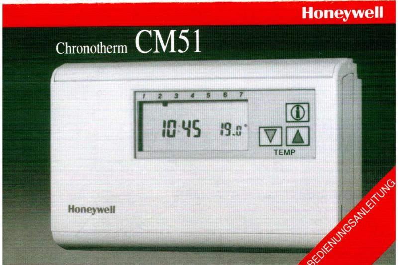

replacing Honeywell CM51 with CM907
5 Jan 2010
671
49
Norfolk
Have you installed a Honeywell CM 907 Programmable thermostat ?
I am replacing Honeywell CM51 Programmable thermostat with the above as a direct replacement .
I have a oil boiler : do I need to go into the Installer Parameters category 2 and set :
min boiler on time ot 4
Cycle rate cr 3
any info as to what these settings do ?
What happens if I get these wrong ?
As my last programmable CM 51 did not have these additional settings.
Many thanks for any help

Never heard of the CM51, do you mean the CM61? If so, this does have the Ot and Cr Parameters.
As for what they do, read Honeywell's FAQ on TPI Functionality.
Yes, you should set them to the correct values for an oil boiler will
Nothing will happen if you get them wrong, except it will take the controller longer to achieve the correct settings for the house. The values you set are just a starting point and they can be altered by the built-in logic of the controller.

The CM61 is a one day prog CM51 7 day prog
I will follow what the book says, have to ask these questions. :oops:
