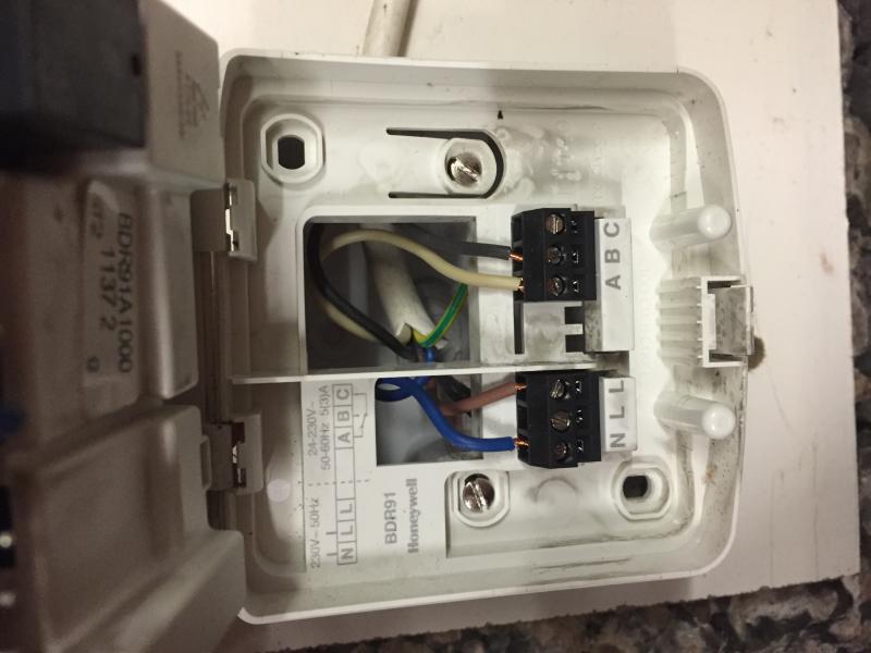

My first attempt at wiring...I'm a bit at a loss with it though! Any help welcome...here is my existing Homeywell BDR91 receiver which I need to replace with Nest Heat Link:
//www.diynot.com/network/Medicinenoise/albums/23500/87972
Here is a picture of the Nest Heat Link manual:
//www.diynot.com/network/Medicinenoise/albums/23500/87974
I'm troubled by the fact I have 2 wires going into each of the Honeywell N and L slot...do I just take them and put them in the N L slots of the Nest?
Secondly I'm unsure of where the A and B go into the Nest Heat Link...looking at another post it seems A>2 and B>3 but I'm really unsure...please help!
Cheers!

Hello
I have the Honeywell wireless thermostat with this receiver. Please see image below of the wires going into the Honeywell receiver.
Can anyone confirm where I connect the cables on the Honeywell into the Nest Heat Link?
I can see that I only have a connection at terminals A and B - where do I connect these cables on the Nest?
I guess the blue and brown, live and Neutrals go to the same terminals on the Nest Heat link, but do I need to provide a second live link?
If I then want to hardwire the Nest Thermostat into the Heat Link how do I do it? I see they supply a USB cable, but is there a cable supplied to connect it directly and if not, what cable do I need?
Many thanks! :)
Edit - just to confirm after re-reading the above:
The terminal marked A on the Honeywell that has the yellow wire goes to 2 on the Nest Heat Link
The Terminal marked B on the Honeywell with the black cable in my setup goes to 3 on the nest.
Then just wire L and N in the same way as I have on the honeywell, naturally blue to Neutral and Brown to Live.
Does it matter that I don't have anything connected to the second live terminal or do I need to bridge it?

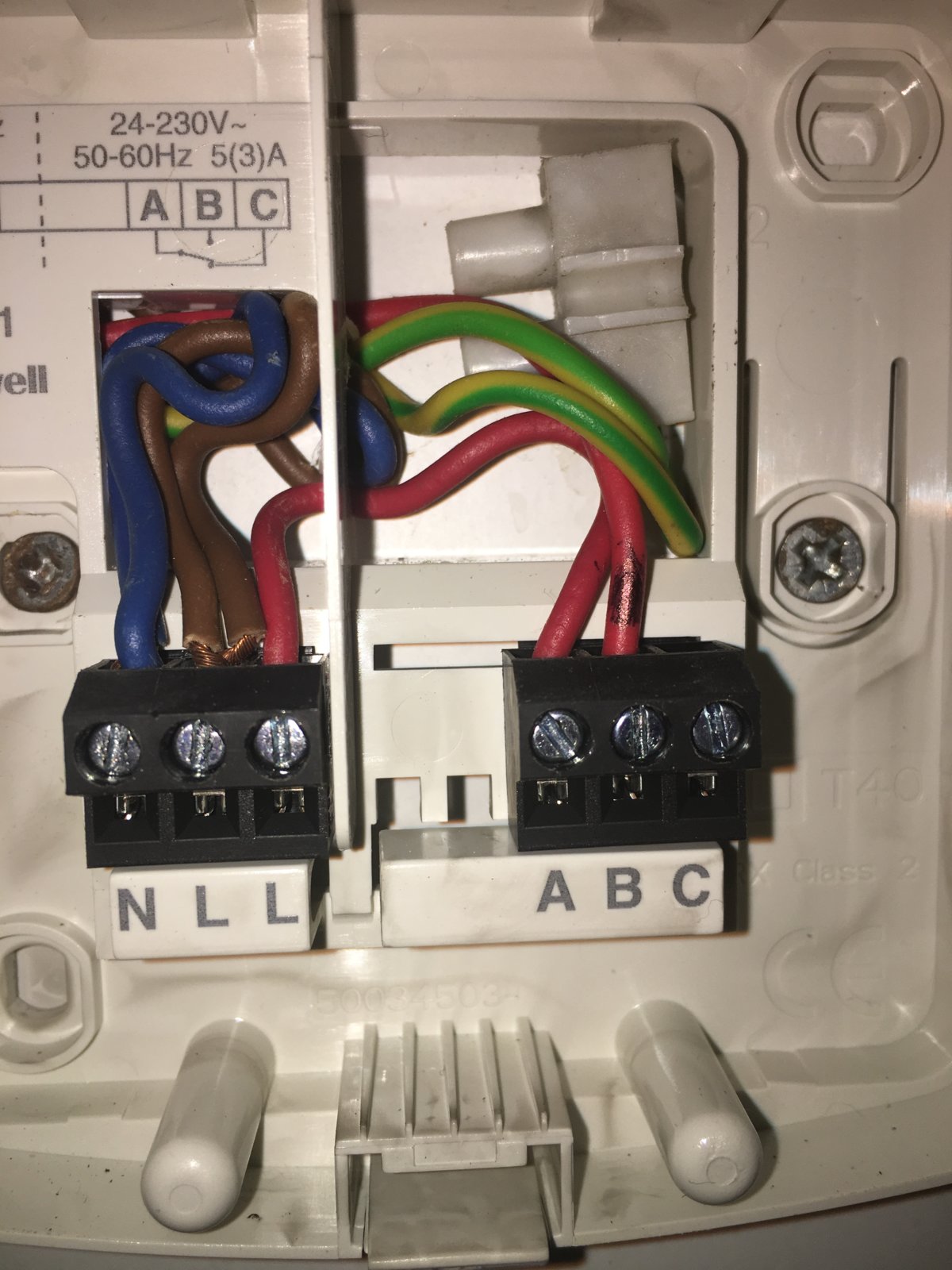

I’m having a similar problem to the original post.
What wire currently in my BDR91 should go into 2 on the Nest HomeLink?
Here’s a photo of my BDR91.
