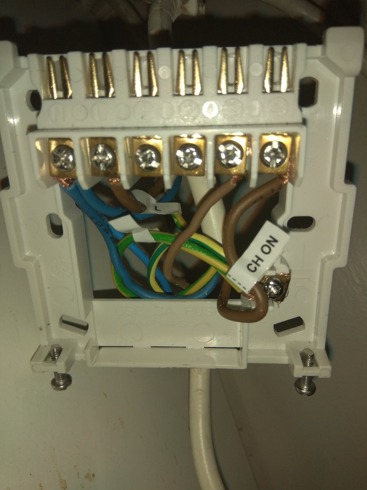

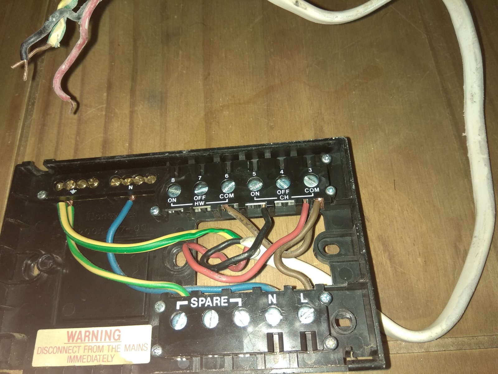

Purchased a hive and as i have an oil fired Benson Jetstream boiler, BG will not install. Here's what the wiring of the old back plate looked like.
What it boils down to is:
Wire 1 containing:
(1L) - A brown live wire coming from a fused spur, currently connected to the L.
(1N) - A blue neutral coming from the same fused spur, currently running up to the blue block in the top left
(1E)- An earth coming from the same fused spur running up to the earth block in the top left
Wire 2 containing
(2L) - A brown wire coming from the down into the guts of the boiler (can't see more as access is poor, currently wired to 5 (CH on).
(2N) - A blue neutral currently running up to the blue block in the top left
(2E) - An earth coming running up to the earth block in the top left
Wire 3 containing
(3L) - A brown wire coming from the down into the guts of the boiler (can't see more as access is poor, currently wired to 8 (HW on).
(3N) - A blue neutral currently running up to the blue block in the top left
(3E) - An earth coming running up to the earth block in the top left
Wire 4 running to the existing room stat, which i plan to isolate entirely from the system and remove from the walls.
My plan is to wire as follows:
1L to the L terminal of the hive
1N to the N terminal
1E to the Earth tether
2L to the 4 terminal
2N to the N terminal
2E to the Earth tether
3L to the 3 terminal
3N to the N terminal
3E to the Earth tether
I am by no means an electrician, but if it is as simple as that, then please let me know. If there is something fundamental that i am misunderstanding then please let me know and i will call a pro.

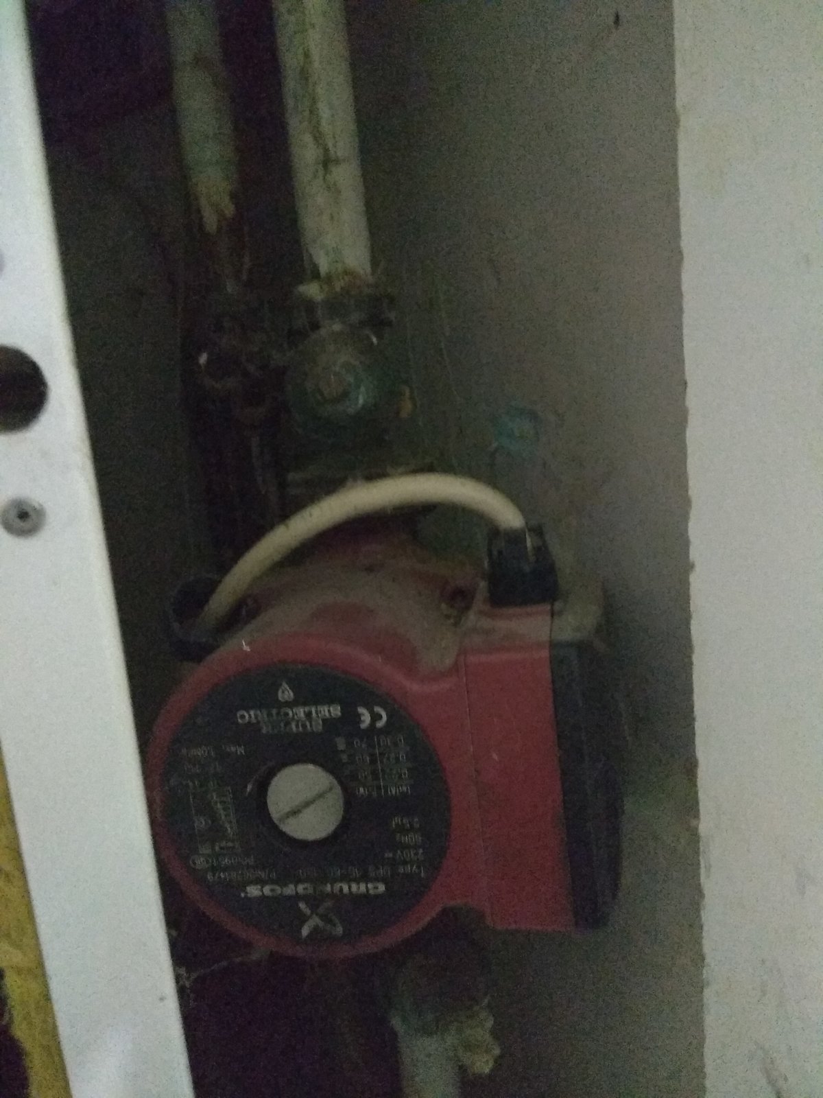

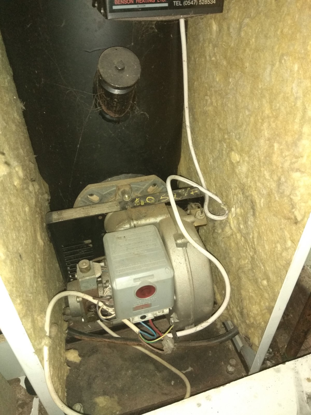

I am also very confused by the pipe set up, this is the first time we have had to turn on the heating since we bought it and I am not seeing any 3 port or zone valves at all. Further inspection of the wiring shows that the HW wiring goes down to the oil pump and the CH wiring goes to a single grundfos super selecteric pump as attached.
There is no other wiring coming from the old controller, so I assume that means there can be no other vales hidden away as there would be no way to switch them on/off.
Here's my current status...Hive is wired in as described above and with the Hive set to gravity fed system. Hot water fires up fine independently and when CH is scheduled it fires on both the hot water light and the CH. However, upstairs radiators are the only ones getting hot. My thinking is that perhaps for whatever reason when i request CH, the hive sends the command to the boiler to fire up, the rads nearest to the outlet pipe of boiler get heated because of their proximity to the boiler but the downstairs don't as the pump is not working.
Does that seem like a reasonable explanation? If so does this suggest that the Hive wiring is not correctly powering up the pump? If so any suggestions beyond the wiring shown above? Or is it more likely the pump itself is faulty? I have tried manually turning the pump spindle and it seems to turn relatively freely. Is there anything else i can do to diagnose the problem? Could i simply wire the pump to the mains directly via a plug and see if that causes it to start pumping to the downstairs rads?

Where is all the other wiring now? in you first photo there are loads of cables, but in the new hive backplate only 3?
Besides the 3 core going to the old wall stat (now entirely removed) and the 3 wires mentioned, all other wiring shown in that photo was purely internal within the old controller, running between one terminal or another. I assumed the function of these wires was replicated by the hive controller in some other way.
When you "removed" the old thermostat, did you reconfigure the wiring to take into account its absence? If you just remove the wires, then the heating wiring (ie that controlling pump) will be 'open circuit' and never come on. The two wires that previously went to the switching contacts at the thermostat need to be joined together.
That would explain your symptoms of the upstairs radiators heating up by natural circulation but the ground floor radiators don't as the pump isn't running.
Ah, my understanding of the Hive system was that when the wireless thermostat decided it was too cold, it would tell the controller/receiver to close the circuit running from terminal 4 of the new backplate to the pump, i.e. the physical wire between the wall thermostat and the controller had been replaced by the wifi link between the new stat and receiver.
If that's not the case, any hints about what is missing, if i remember correctly i think the wiring from the old wall stat ran to the old receiver via the black wire at 5. The other two cores ran to the top left neutral and earth blocks and no other wires from the stat went anywhere else.

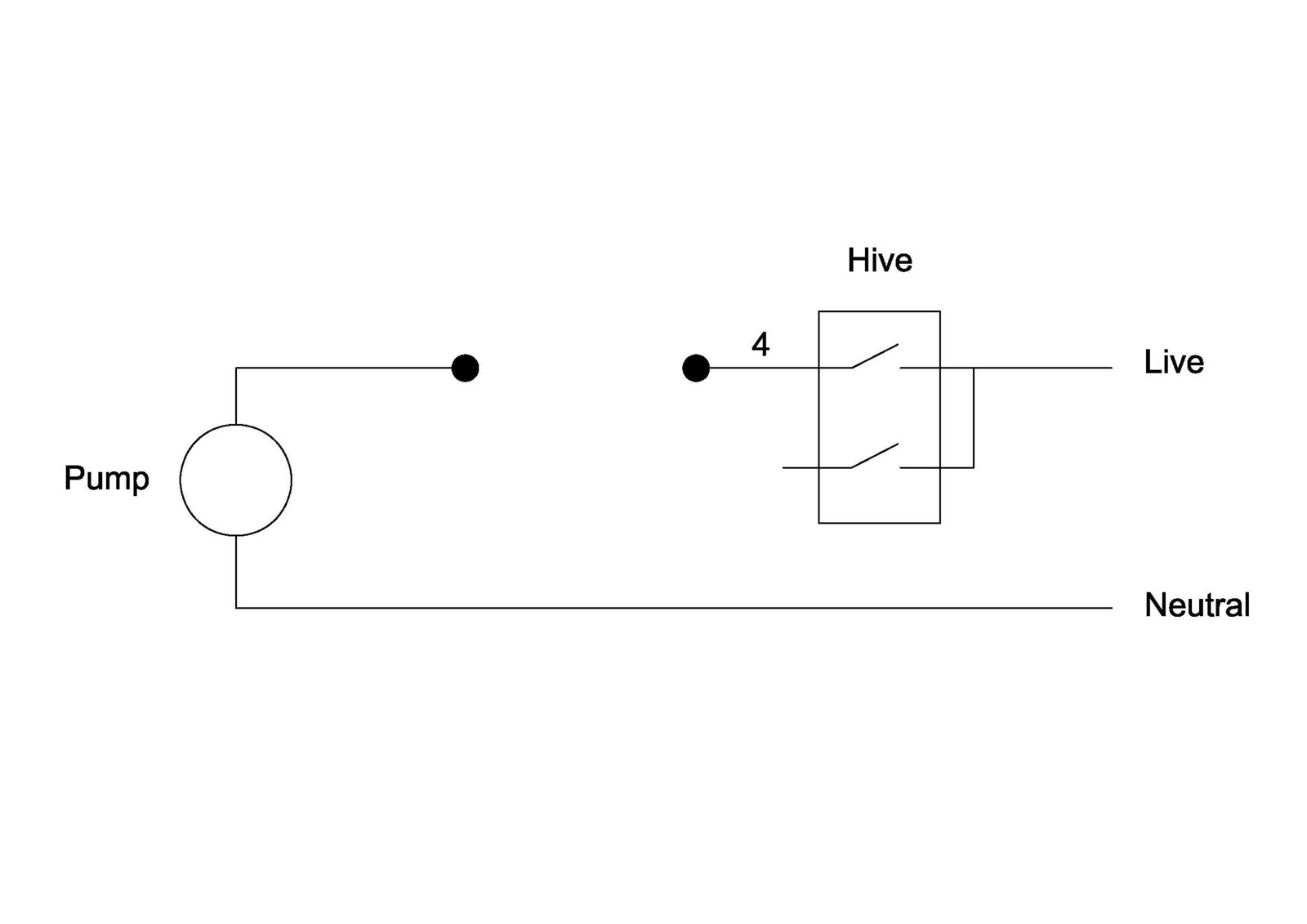

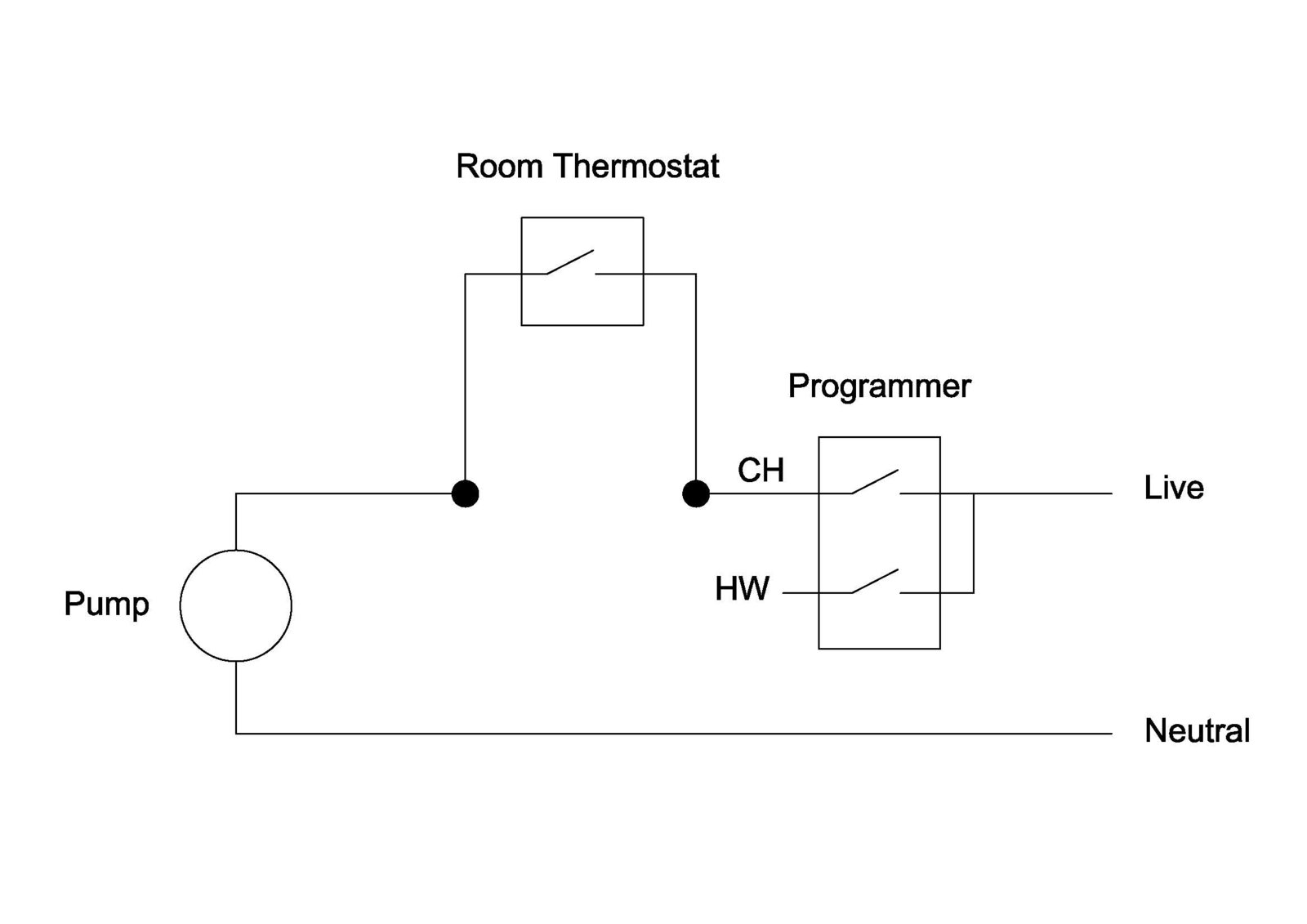

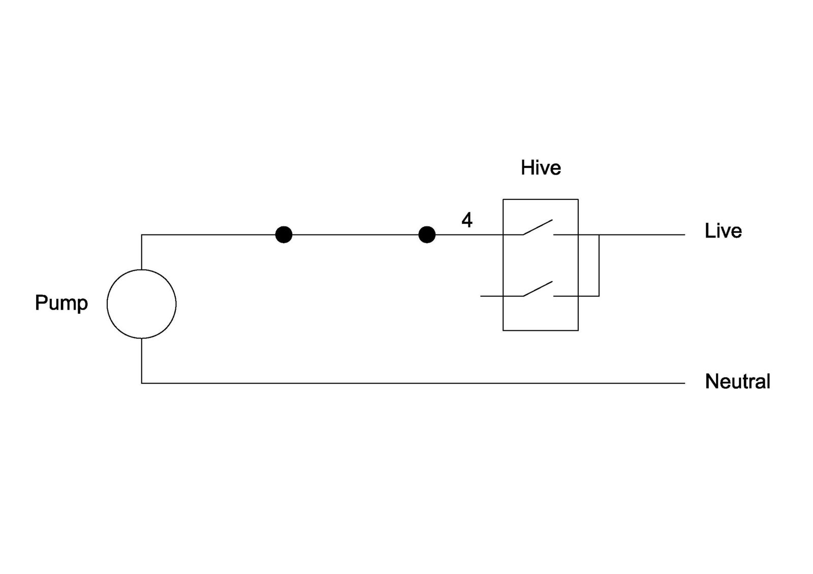

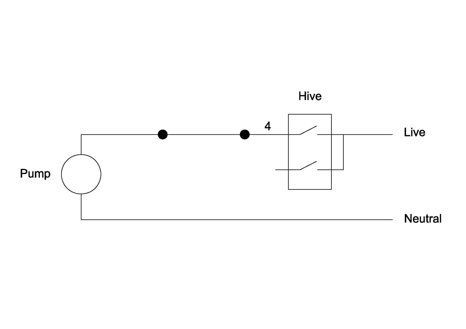

You will need to trace the wiring to be sure, but here's a simplified sketch what I would have expected to have found as regards the central heating wiring. It makes my waffle a bit easier to understand.
Original installation
What I think you have now. ie Hive added and original room thermostat removed
What you should end up with
OK Thanks for the effort! I will take a look at your drawings and have a think. Having checked the remains of the old controller pictured, from which I only removed the wires mentioned above (3 core direct to spur, 3 core direct to boiler (HW on) and 3 core direct to pump (CH on)).
I am struggling to work out how it fits with the drawings you provided. I can see (I think), how the spur provides current to the terminal L on the old controller which travels via the brown wire to the CH com terminal and down the red wire to the stat, which will only pass current onto CH on at terminal 5 via the black wire if the stat switches on.
What I still don't get is that now that this controller and stat is remove, there seems to be no break in the circuit besides that controlled by the Hive controller. Current would run from the spur, down to the hive, then the hive decides based upon a signal from the wireless stat to either provide current to terminal 4 or not. This wire is and always had been directly wired to pump with no interruptions in between and so when it has current it should power the pump. It isn't so obviously I have cocked something up!

It looks like the stat was wired in parallel rather than the normal series, so either the timer or the room stat could switch on the heating so your wiring should work. Have you checked the pump spins freely with a screwdriver? It may be stuck if it hasn't been used in a while.
Ignore the bit about opening the isolation valves.
Ok thanks, that was really useful, checked pump when hive was supposedly running central heating, the internal shaft was not rotating. However, i then wired the pump directly to the mains and what do you know the shaft starts spinning. Therefore I guess there might be a problem with how I have it wired, although I can't see a problem myself.
