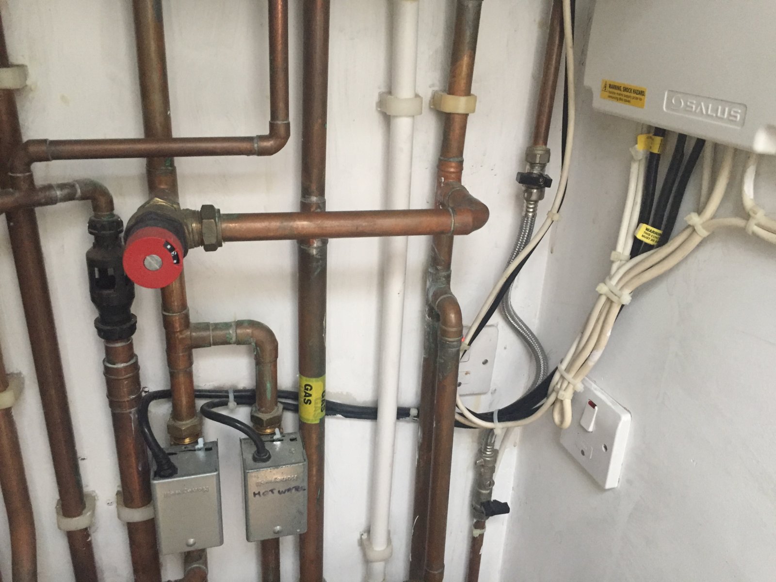

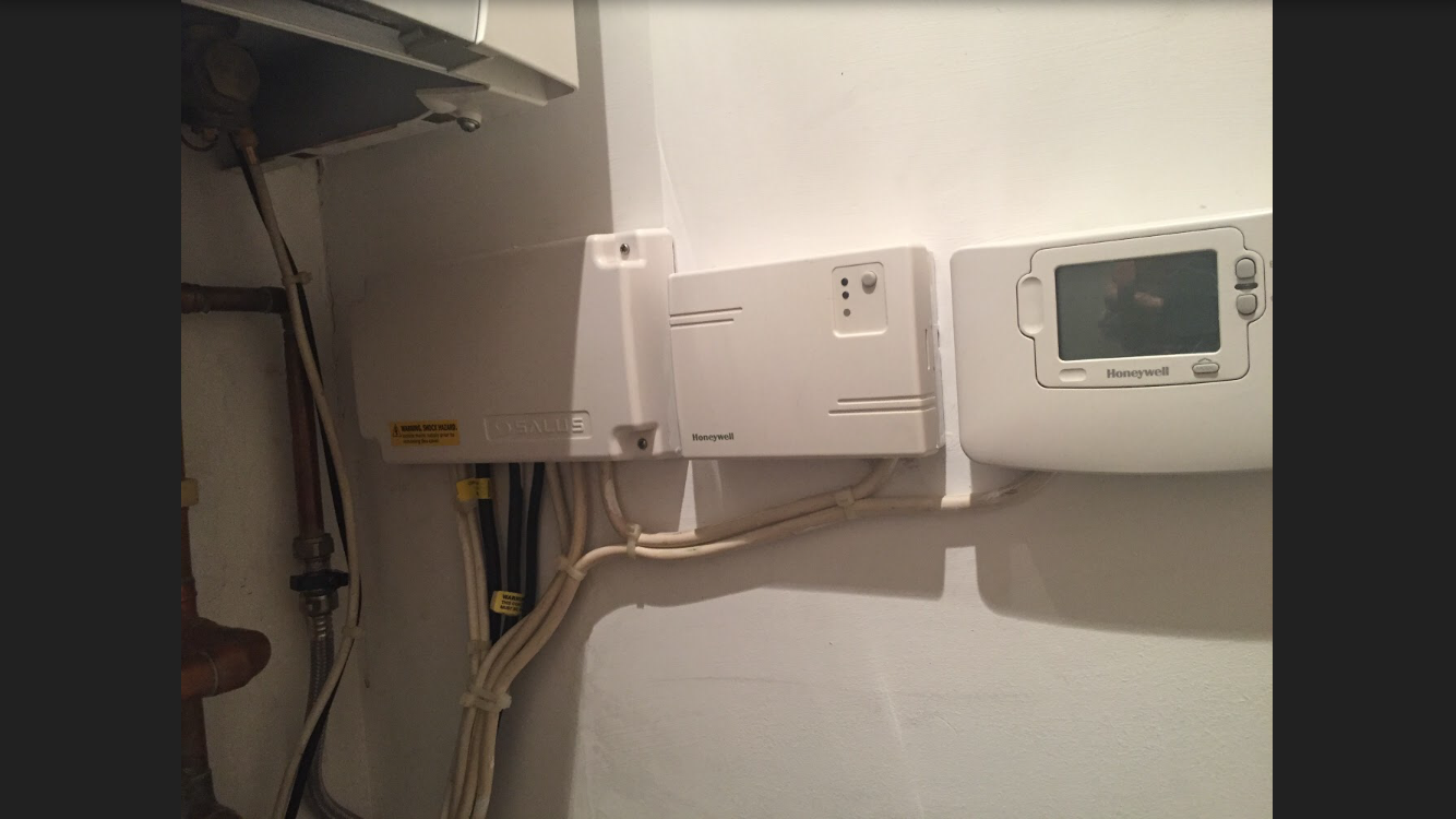

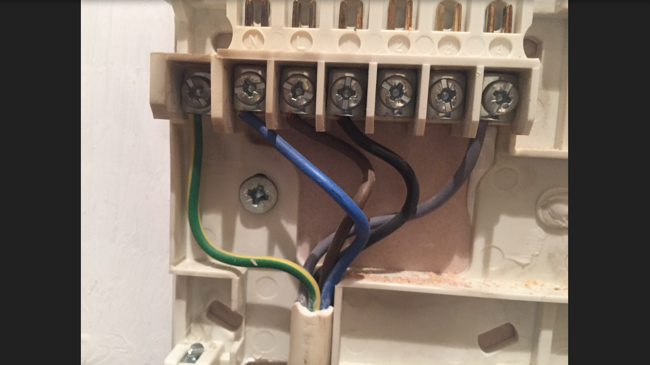

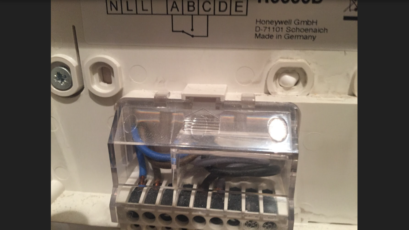

My original system consisted of a S-plan installation with a combo boiler and hot water tank controlled by a Honeywell 6660D wireless relay controlling the central heating and a Honeywell STC9100C controlling the hot water. Please see the attached pictures of the original setup and also the internal wiring.
I currently have a tado Extension Kit installed by an electrician with both the previous connections into it. The central heating is working correctly however, the tado does not seem to be controlling the hot water valve, and we can only get hot water if I manually put the valve in the open position.

At the moment, both the N and L wires from the previous relay and programmer go into the tado N and L slots.
The black wire A from the relay goes into 2 and the grey wire B goes into 4 on the tado.
The black wire 1 from the STC9100C goes into 1 on the extension kit and the grey wire 4 goes into 3. Earth goes to earth.

Can anyone advise if anything is incorrect in this setup? I’m wondering if the electrics in the hot water valve has blown and will get an engineer to check that if necessary but I want to be sure the wiring of the tado is correct first.

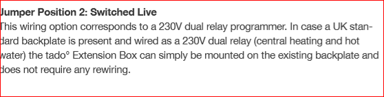

Sorry I forgot to say it’s on position 2, Switched Live. This is what tado advised.
Is this correct? And are you saying on this jumper setting position 1 is not required?

Ok, so if the black wires are redundant, as the hot water is not working do I assume there is something wrong with the valve?
