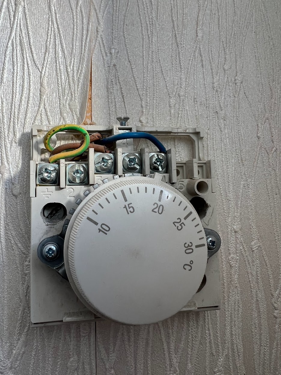

I'm using the room thermostat T6360 and I want to upgrade to the wireless thermostat T3R. But, afterwiring it doesn't work.
Current wiring:
Blue - L
Brown - N
Yellow/green - E

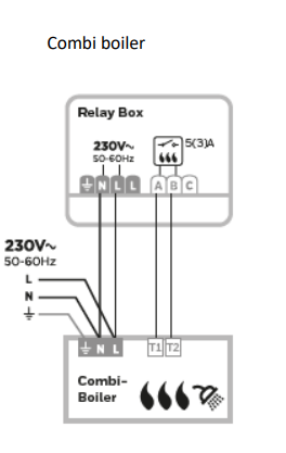

I'm using this wiring diagram for T3R:
Blue - L
Brown - N
Yellow - E
No wiring for A-B-C terminals

With the old wiring to T6360, the Blue and Brown has power. But with T3R, there is no power for the Brown (N).

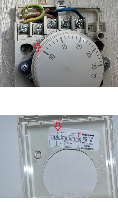

Whoever installed that thermostat originally didn't do it properly. So, it will never have worked as well as it should.
As has been said already, there isn't a Neutral, connected to it. If you look inside the lid of your thermostat you should see a wiring diagram for it. From the diagram you can see that the neutral should have been connected to terminal 2, and your terminal 2 doesn't have a wire in it.
You will also see from the diagram that the wires in 1 and 3 are both 'lives'. So again, a bad initial installation, someone has used a blue wire for a live connection. It should have been fitted with a brown sleeve to identify its true use.
