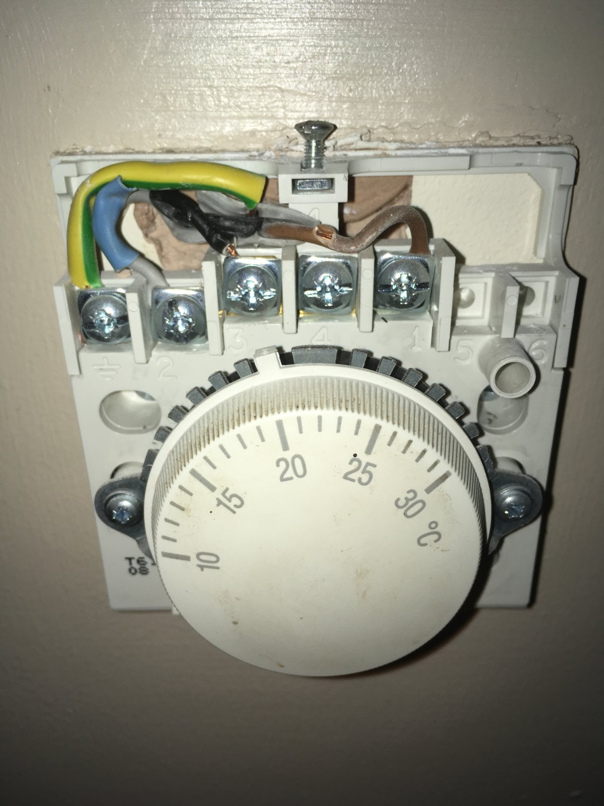

I would like to replace our old analogue thermostat T6360B with a wireless unit - thinking DT92E. I have a Worcester heatslave combo boiler. Is this straight forward wiring if not could you suggest another unit which would do the job? This is the wiring into the old thermostat

Thank you for your reply, I thought that with the wiring - nice bare wire !! Ideally I would like to move the thermostat as it was placed right next to the cooker and when cooking the rest of the house is cold.
Oh well its the wireless option then,wire the receiver to the boiler or what ever is there.

Could you point me in the direction of the wiring for the dt92e with the wiring that I’ve got or not ?
The wiring diagram is available on the Honeywell website. I Would advise installing the receiver where there is a permanent supply for the receivers electronics, and only the switching contacts supplied from the heating timeclock.
Depending on how the installer has wired it up originally (installation methods can vary if an integral or external timer is fitted) but its usual to power the room thermostat from terminal block X2 on the boiler control board.
Remove and discard the existing room thermostat cable on X2. wire the DT92E receiver to X2 as per the book that came with the boiler & the honeywell instructions. :idea: The DT92E receiver will require a permanent live,a suitable connection point can be found inside the control panel.
Maybe get it fitted professionally,its easy to damage the boiler electrics.
Edit,looking at how the room stat is wired best get a professional in.
