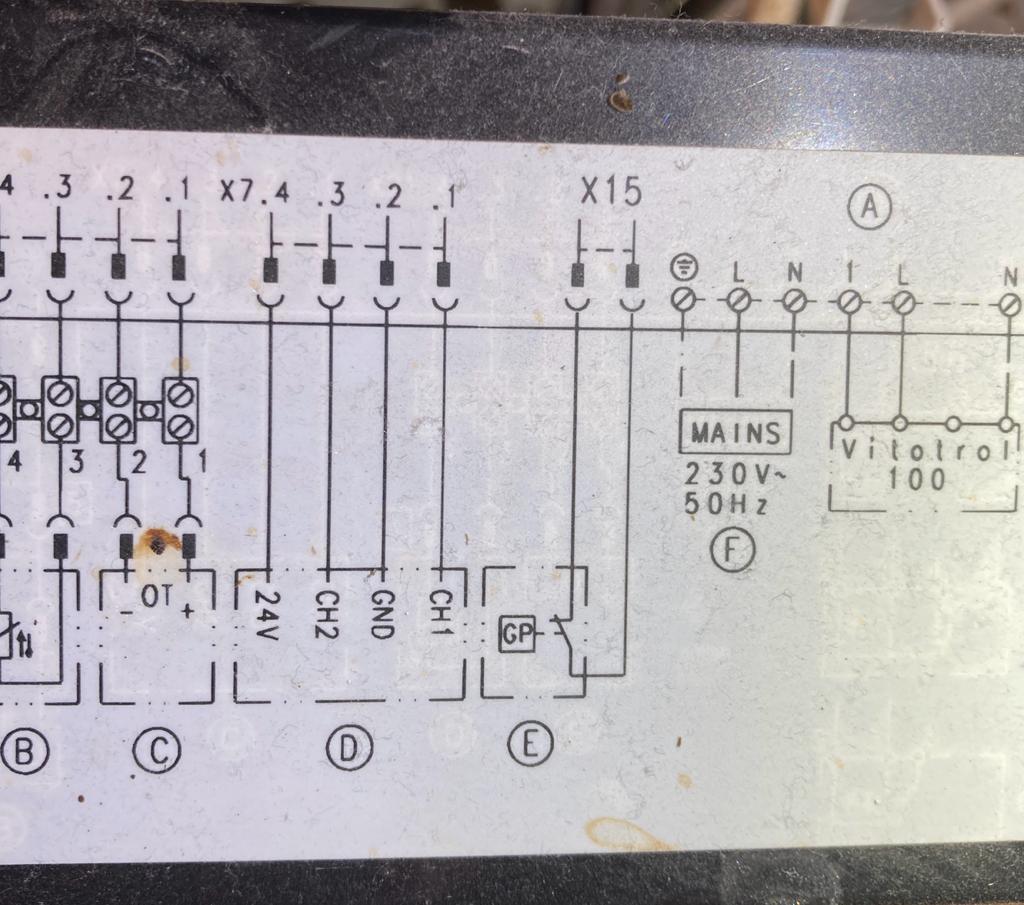

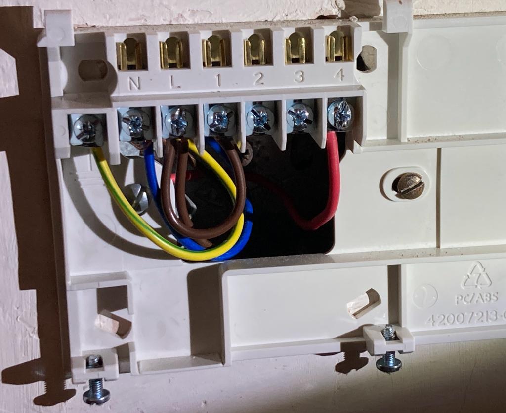

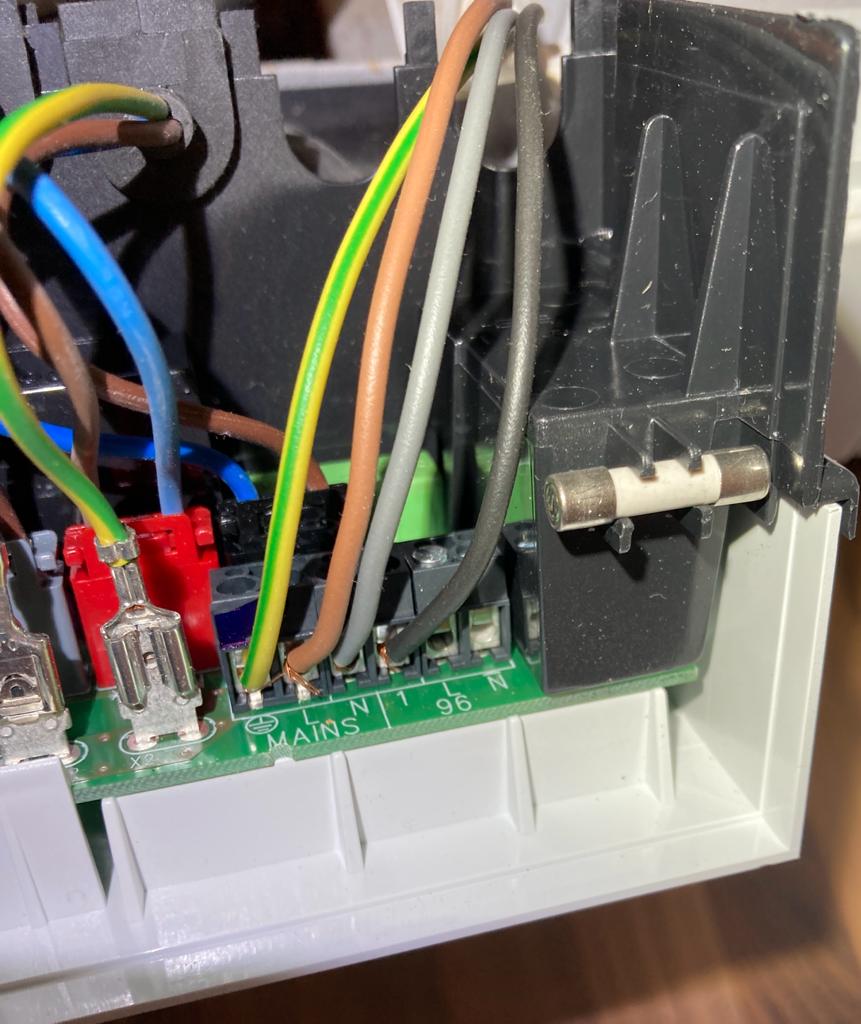

I'm going to replace a Honeywell ST9120C Timer and Wireless Thermostat with the new Hive Mini.
It would be great if someone could confirm required wiring set up for the following:-
Viessmann Boiler is Vitodens 111-W Combi Boiler

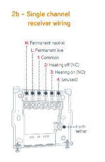

Current Honeywell is wired per the first photo and the boiler connections and wiring diagram is as per the other photos. Hive single channel set up diagram is included for good measure ;)
As you can see from the diagram below, the ST9100 series has terminal connections that are generally the same as Hive Single Channel diagram you have posted, with just one exception. The red 'ON' wire currently in terminal 4 goes to Hive terminal 3 instead. No need to touch anything at the boiler end.
The brown loop between L and 1 should also be retained.
I believe you should copy the wiring from your existing set-up, the exception being the red wire currently in terminal 4, should go to Hives terminal 3.

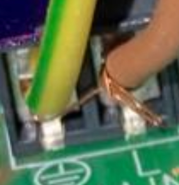

....but also, you really need to sort out the loose strands in these terminals. There is a good chance of a short here!:

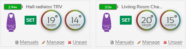

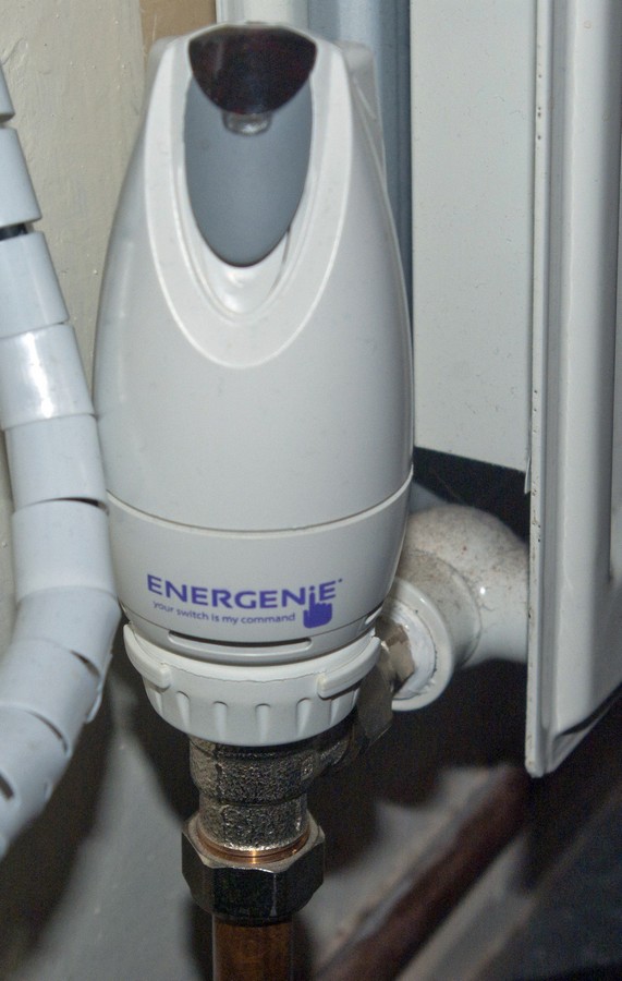

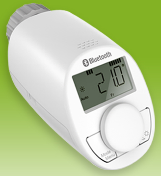

The big problem is there is no one good place to measure the temperature, I am using the hall, but every middle floor room, (lowest floor for main house) has either doors to outside, or alternative heating, be it cooking, wood burning fire, or the sun through windows, it needs more than one sensing unit, Nest USA do a sensing unit 1670584863527.png but not released in UK yet, and Nest USA is very different to UK version. In the main in the UK we use a sensor built into the TRV, Hive, Drayton Wiser, Honeywell EvoHome, Tado, and others all use the TRV as the remote sensor, I do use electronic TRV heads, 61dmtMm13BL.jpg the cheap one actually works better for me, no need to find my phone to change the temperature, one button toggles between the pre-set by me comfort and Eco temperatures, or the dial can be pressed for boost or turned for new setting, where the much more expensive version IMGP8035.jpg I need to use phone or PC to set, well if you trust Nest Mini you could use voice commands, but they seem to act like mischievous little boys, not sure I would trust them with central heating.
At the moment the heating is not doing very well
I really want the rooms warmer, but note hall,
Nest Gen 3 is showing 2ºC higher than the TRV but in the same room, so to ensure the wall thermostat stays on in cold weather, the TRV has to be set lower than the wall thermostat, it was cold this morning, -5ºC showing for outside.
Although it says 15ºC for living room, baby alarm on floor shows 13ºC and the room does not actually feel that cold, more like 18ºC as the sun is warming it well. I have never yet lit a fire in the grate, maybe I will this year. But the location of any thermostat is important, you want it in the natural air flow, and in most rooms the TRV is in the best location to work out temperature of the room, mounted on walls it measures the wall temperature as well as air.
