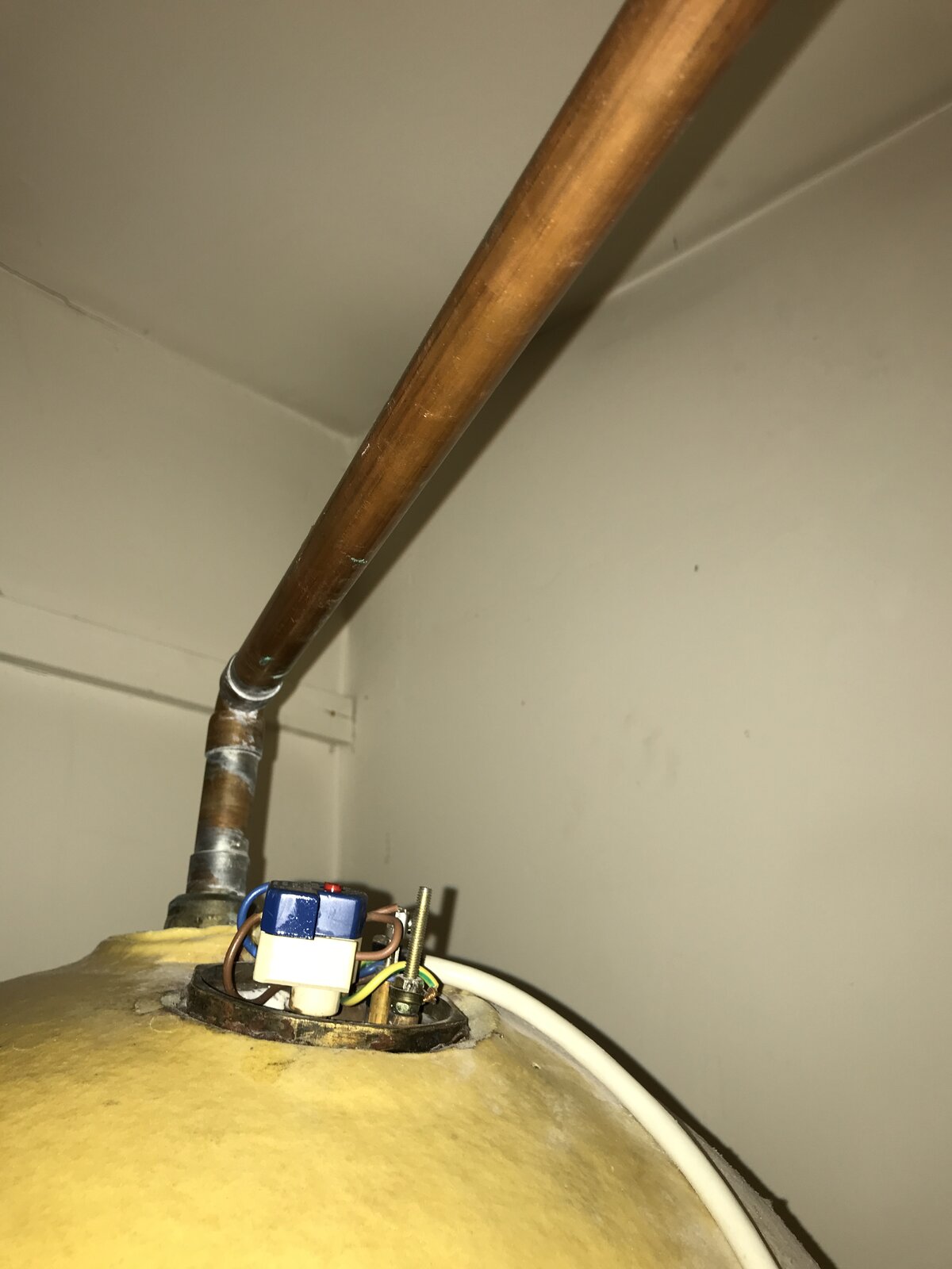

The Baxter BT18 thermostat in immersion heater has failed and need to replace. This does not have an independent thermal trip built in. With a 90 build would this have been say in the element or was it not mandatory then?

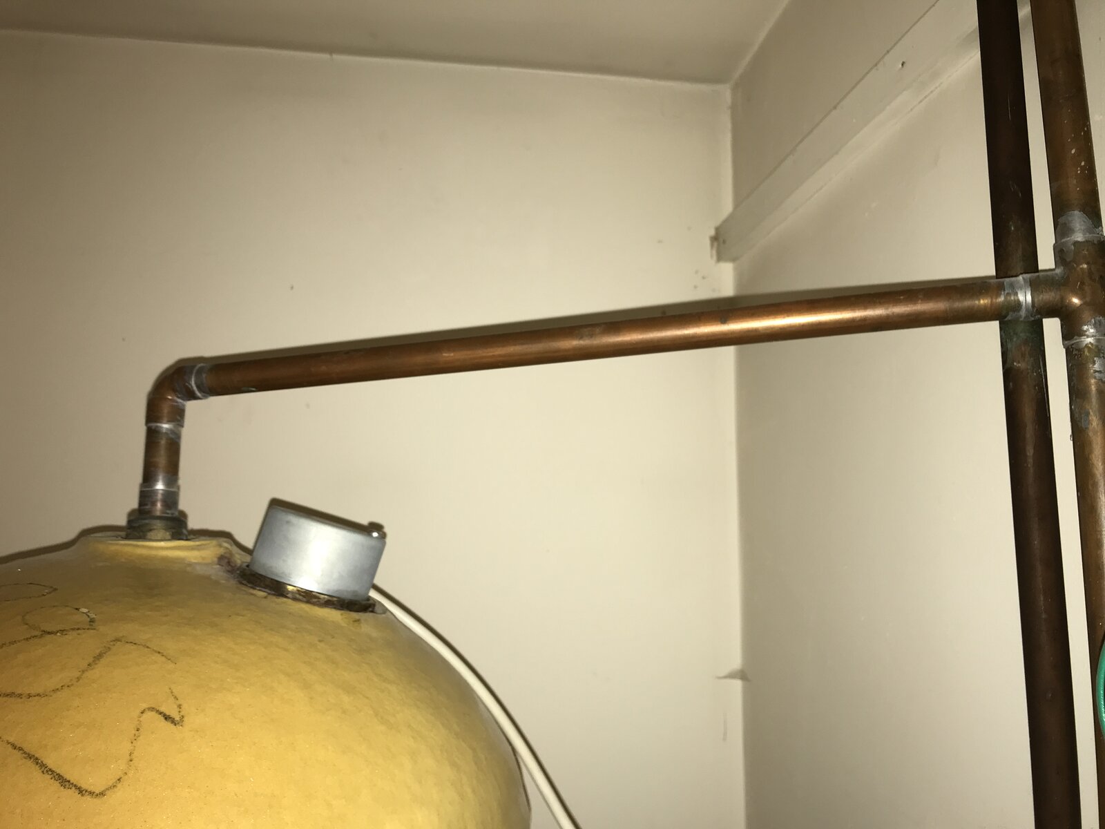

Prefer to replace with a model without a cut out as have been reading reviews on Amazon where this and similar models keep tripping the cut out. It is not trivial to replace requiring a plumber to unbraze to swing out pipe as the header pipe is frustratingly located right above it, is this seemingly bad layout common?

It is not easy to replace, the head of the thermostat is too big to clear the pipe have tried, the probe is not flexible.

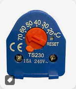

The reset can be seen in this thermostat
and most do have them built it as shown.

The reset can be seen in this thermostat View attachment 365039and most do have them built it as shown.
Thanks for the insight. The Baxter BT18 does not have a cut out though, there is no reset. The shops note it does not have one for this model.

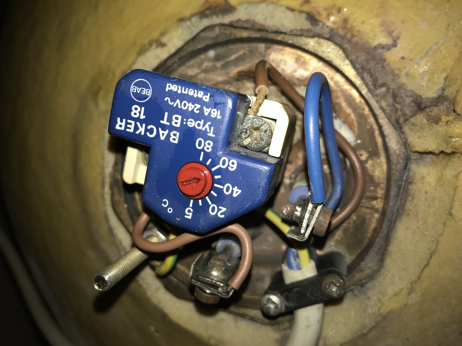

If it's a proper BT18 then the thermostat doesn't include a cut-out, I don't see a classic cut-out on the heater itself. It looks like the flex is terminated into the stat and it looks like the heater is connected to the other side of the stat. Obviously I don't see if there is anything lurking 'behind' the stat in this view.
There are 18" stats available which include a cut-out, this is my first google hit: https://www.screwfix.com/p/tesla-dual-safety-thermostat-18-/89445?
Can we have another pic, either from the other side or top view?
This is the head of the element with Backer BT18. The temp dial is not sprung with an overtemp trip.
Unfortunately the pipe will not flex at all to bring it past. The shop though sent a BT18 equivalent made by Cotherm and the probe rather than sitting near the head block centre is close to probe edge along one side so may be a chance to cut the original one out and slide this in.
A plumber is coming to fix other pipes so can let them decide.
