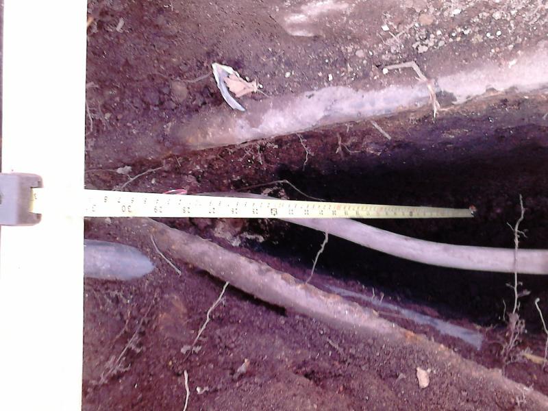

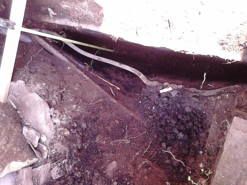

Beyond making the MDPE connection, dont touch anything at or beyond the external stop-tap. When the meter was installed the Utility would have noted the communication pipe material and the depth and condition of the external stop-tap - all that is down to them.
Do as i suggested above, and then fill the trench and call out the Utility with a complaint ref. the inoperable stop-tap and the lead(?) communication pipe that seems to have a leak on it. Say nothing else. Chances are that they wont say much either but simply get on and replace the communication pipe and the external stop-tap.
Congested digs are par for the course in ground work - you just have to work very carefully, and do the best you can. If the gas or elec appear to be old and deteriorating then call them out too but on separate occasions. Dont do anything else until they've had their say.
But first, before any of the above, why not start posting some pics on here - given that you are working with dangerous supplies?
Here's some pictures of where I've got to. The trench is almost at the required depth. You can see the electricity and gas pipes on the left, and what I think is an old disused gas pipe on the right (although for some reason the uploaded images have been rotated 90˚ anti-clockwise).
Couple more questions:
1) The total length from the water meter to the stop tap in the kitchen is 13m. What thickness MDPE pipe should I use? 25mm?
The MDPE section will only be 9m in a straight line, but more like 12-15m if I include bends, etc.
2) What thickness copper pipe should I use above the ground level around the kitchen?
The existing pipework after the stop tap is 15mm...
3) As far as I can tell, the MDPE pipe usually rises vertically within the first 600mm inside the property - can it rise more slowly through the ground inside the house (to minimise bends) as I do not want a stop tap at this location?
thanks
James
