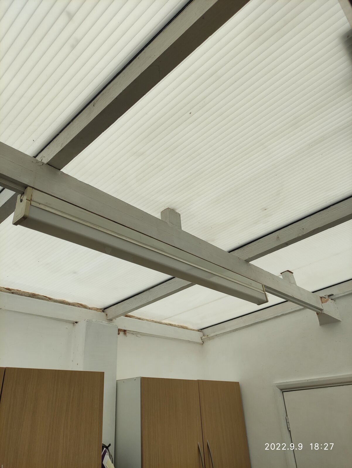

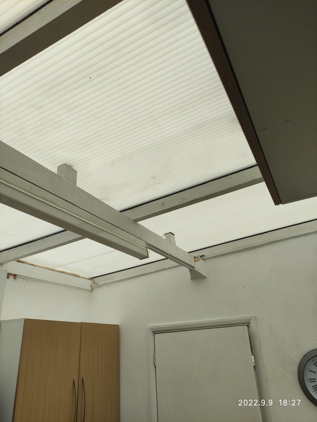

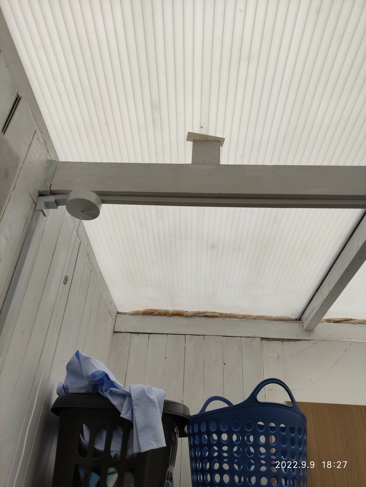

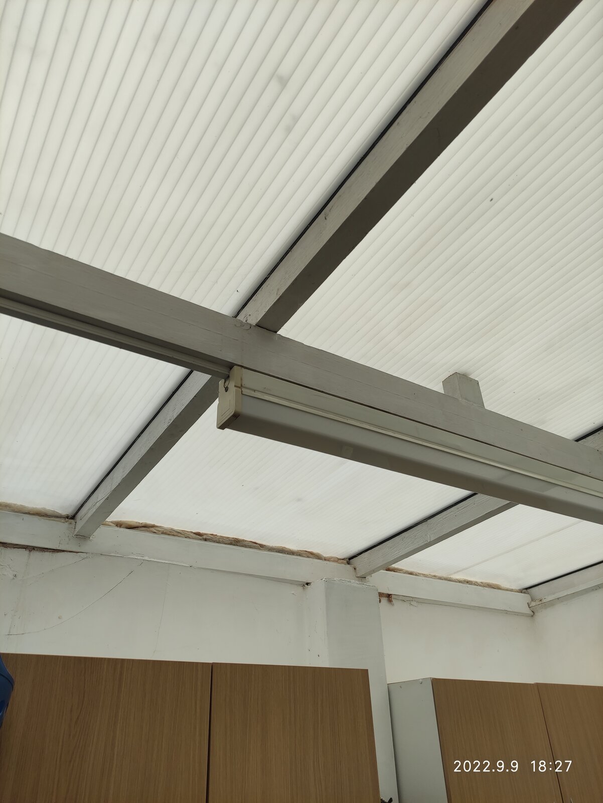

The plastic roofing on my parent's utility room/toilet is leaking quite a lot when it rains. My Dad replaced it once himself maybe 10 years ago, so we at least know that the wooden structure can support his weight but he's a bit too old to be climbing up there now, so I'm hoping I can do it for him. They had some quotes which were around £6,000-£8,000, which seems rather excessive but they're thinking of extending their kitchen into the utility room and out into the garden in the near future, so they really just want a cheap fix for now, as the roof will probably have to be changed again when they extend the kitchen.
I've attached a few photos from inside, showing the wooden beams that the roofing is supported by. Could I just remove the plastic and replace it with wooden sheets if we're not bothered about the light and just want to make it watertight and warmer? I can access the toilet end from the garden via a ladder, but it's probably going to be easier to start at the other end as it adjoins the garage roof, so I can kneel on that to remove the first section of plastic and replace it with a wooden sheet that spans the width and reaches the first cross-beam, then once that's fixed in place I can kneel on that to replace the next section, etc.
Would I need to cover the wood in rubber sheeting to protect it, or would charcoaling it like this be sufficient to waterproof it?
I could also fit some sheeps wool insulation on the inside that's held up by netting attached to the wooden beams, which will keep the space warmer and also dampen the noise from the rain hitting the roof. As it's only a short-term fix, it's probably not worth covering over the insulation with plasterboard just to make it look nicer.

Is the current roof leaking or is it condensation dripping down?
If you are after a lash-up job, then you might be able to drop the panels out replace with wood and use the current glazing bar tops to clamp the wood sheets. What thickness is the multi-wall plastic?
How far apart are the rafters, they look over 600mm apart... need to be mindful of weights or sheeting and roof covering
You'd need to protect the wood, I've no experience with the Japanese burning technique, ...maybe could use proplex (cheap short term lash!) glued to wood or rubber.
Rockwool will be cheapest insulation.

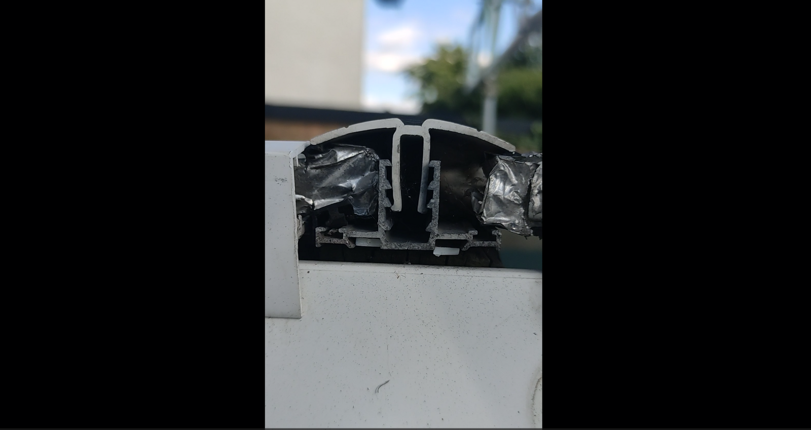

Can you take a pic from outside? possibly the seals on the bars and/or screws covers are shot.

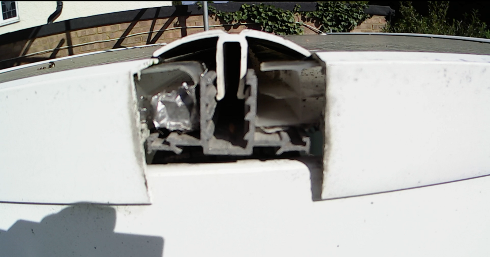

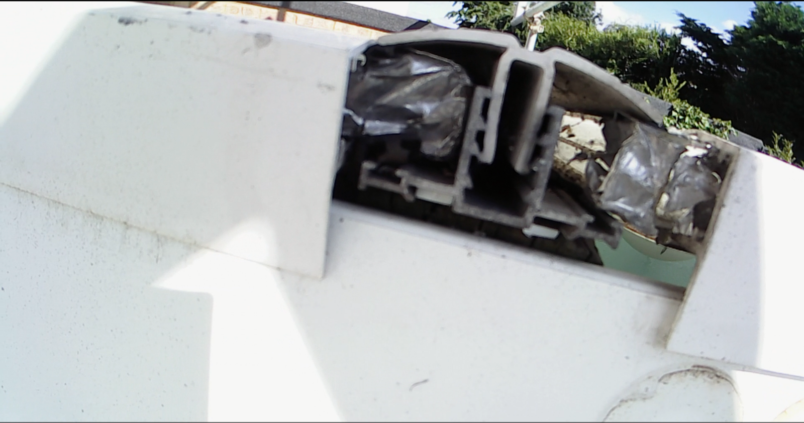

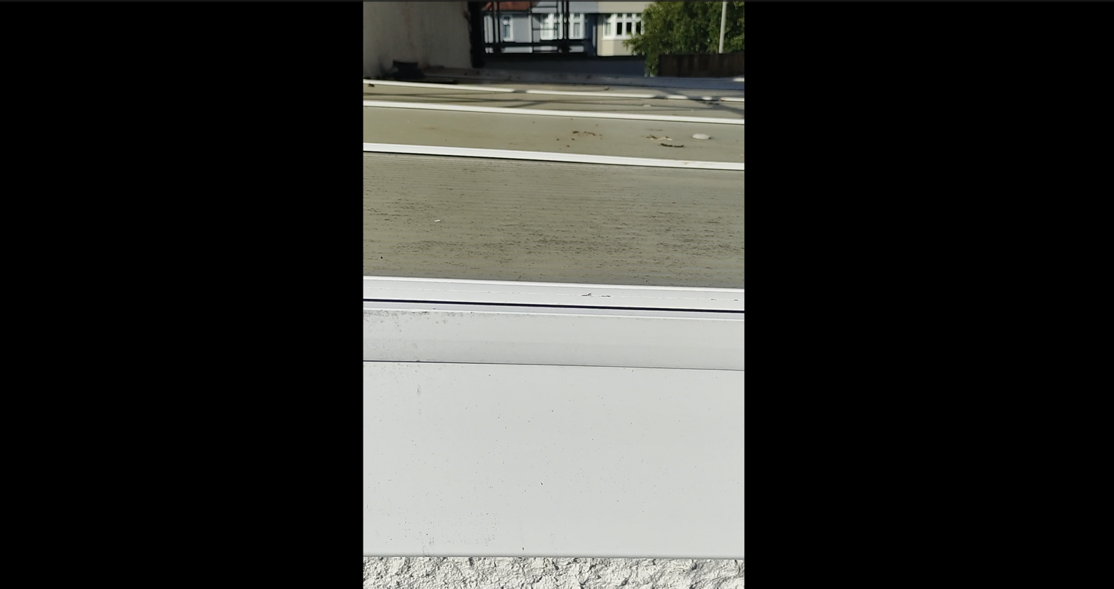

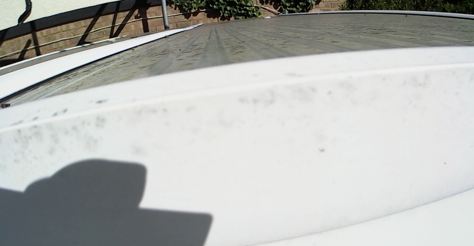

Sorry it's taken so long to get some photos. I had to wait whilst my Dad had his solar panels installed.
I measured the distance between the rafters and it's:
95cm from the garage wall to the first rafter
95cm from the first rafter to the second rafter
95cm from the second rafter to the toilet wall
120cm from the toilet wall to the outer wall
110cm from the side walls to the central rafter running along the length of the structure.

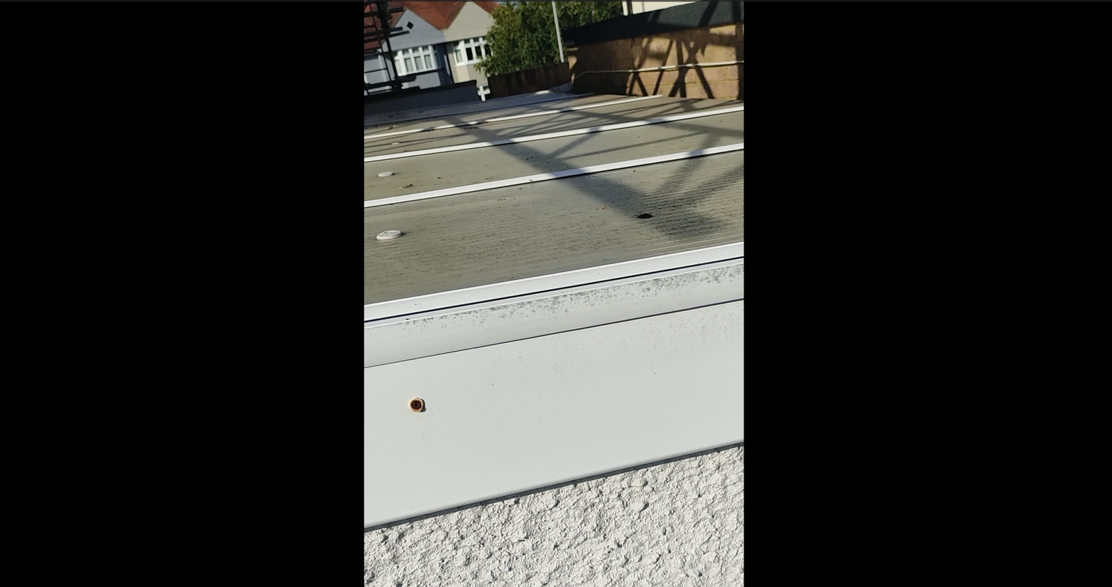

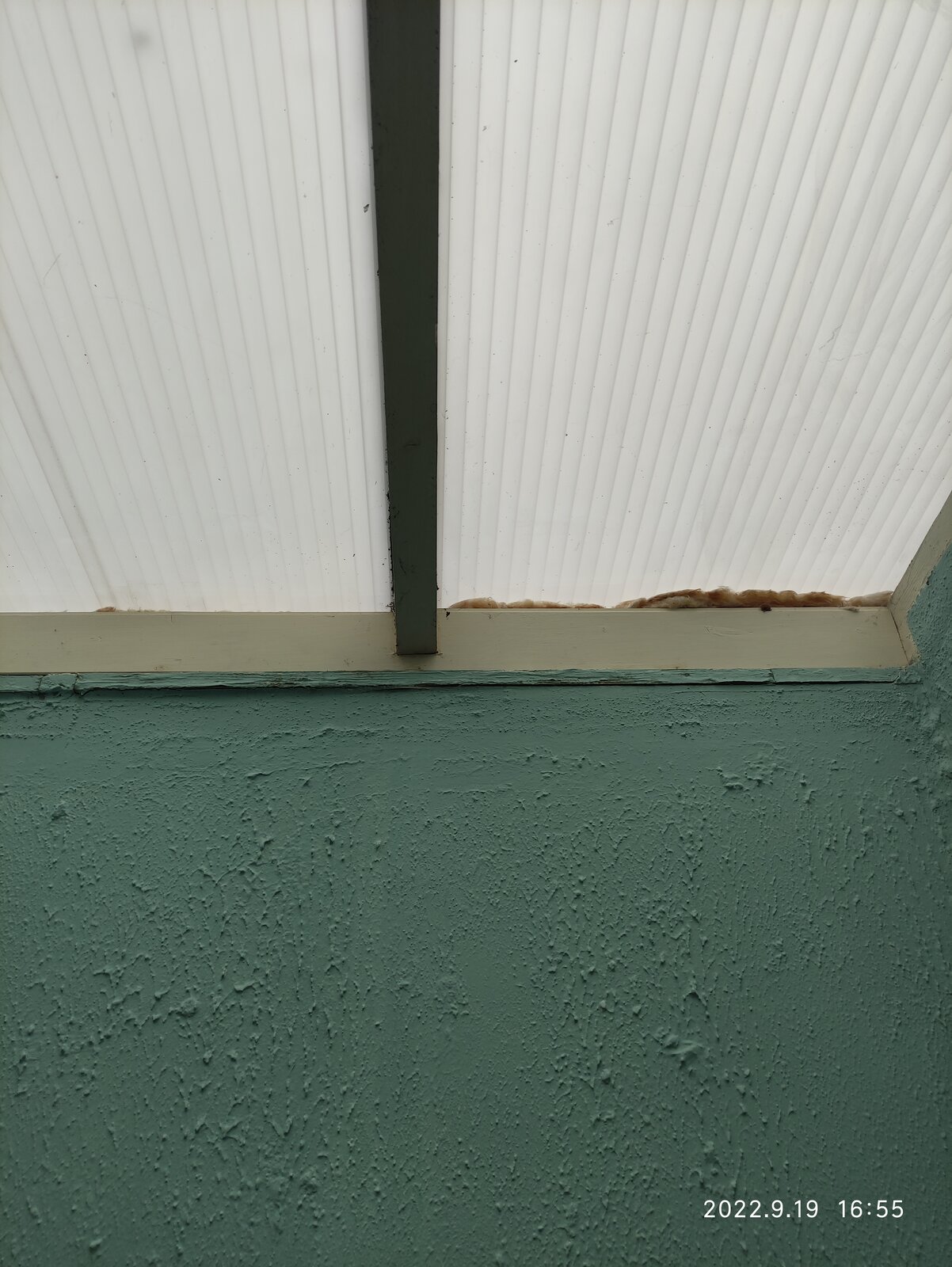

The first 3 photos show an exposed cross-section of the fixtures holding the plastic roofing. My Dad says it's been exposed like that for a while, and I imagine that might be letting some rain in but as rain generally falls down rather than sideways and the water in the toilet area drips from around the middle of the roof, there's probably a crack in it that's letting it in. The fact that my Dad says he's patched the roof over the main area and it's no longer leaking in there also points away from this exposed section being the entry point for the rain.
I've never noticed it before, but you can see in these photos that his neighbour has built a brick extension with a rubber or felt roof that's a bit higher than my Dad's extension. I'm sure that wasn't there when he had his built, so the builders probably accessed the neighbour's garden when building it, which isn't possible now that they've built this and that will make it more difficult to seal/trim that side of the roof when I replace it.

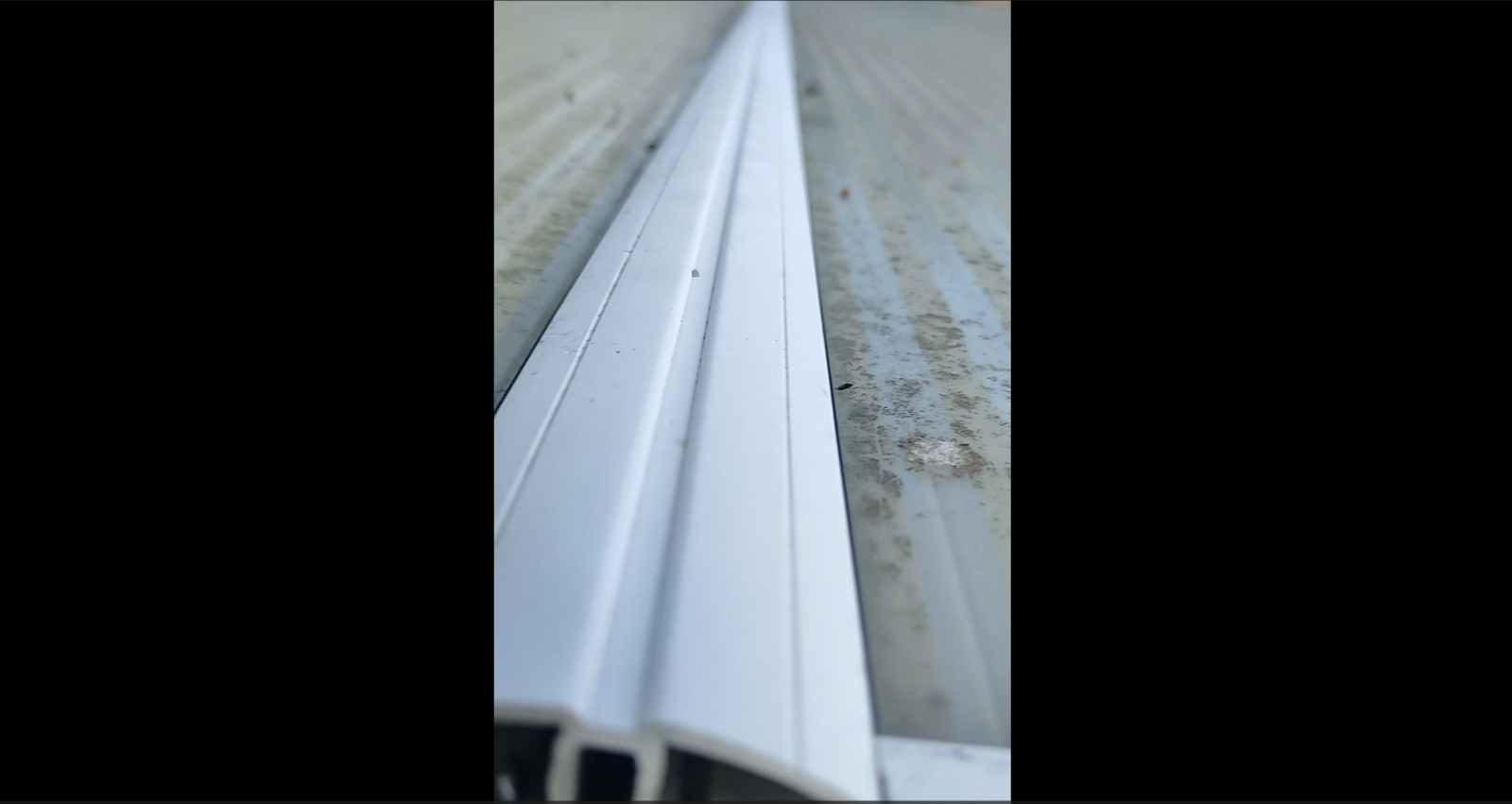

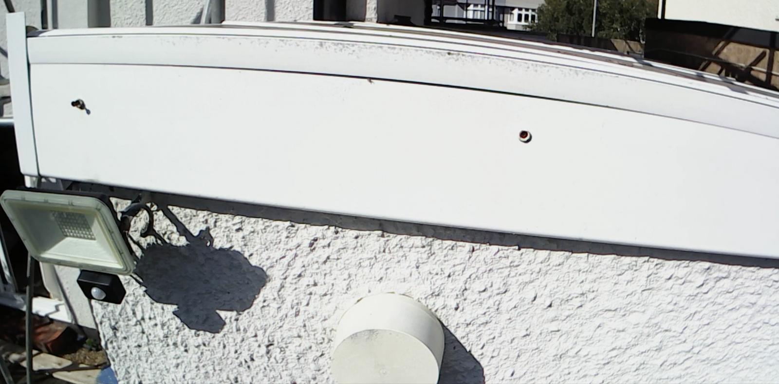

Photo 4 shows the trim along the rear wall.

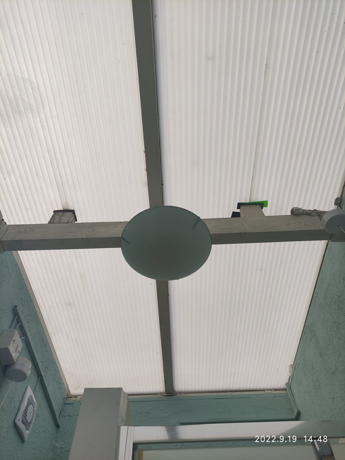

Photos 5-8 show the top of the roof from the side and rear. I'm not sure what the white discs are that you can see in the middle of the roof in photo 8.
Before I took these, I was thinking that I could just cut away the plastic roof from inside, doing it in sections so cutting out the 95cm wide area between the garage wall and the first rafter, than sliding the replacement plywood up through the gap and then fixing it to the wall and rafter with L brackets, before moving on to the next section.
Clearly it's not that simple as the fixings and trim holding the plastic roof and protecting the edges will need to be removed before cutting away the existing roof, and then I'll need some new trim to protect the edges of the plywood and seal the gap between the wood and the walls. Is there anything cheap and easy to fit that would be suitable for that?
I figured I could glue the Proplex to the plywood on the ground before fitting it, so I wouldn't need to climb on the roof to do that after, but I guess there will still be gaps between the Proplex on the adjoining boards, so I'll still need to go on the roof after I've fitted all the plywood to seal the gaps with tape or something?
I think the replacement plywood would need to be 18mm thick to make it safe for someone to walk on. Will the existing rafters be sufficient, or will I need to add some more to support the additional weight of the plywood?
