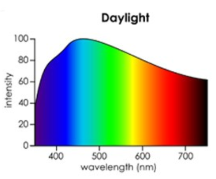

To get full colour spectrum light
This comparison of spectrums explains why "white" LED light cannot give the same appearance as "white" light from an incandescent light source.
Image copied from HERE
Many thanks, I am fully aware of that. I was actually thinking as I wrote it that the only reason would be due to the near 100 cri of halogen. In this instance however, I very much doubt that colour rendering will be an issue and this will just be a typical domestic environment (could be wrong of course!) :)
Also FYI your graph is comparing incandescent to cool white LED's. A little bit unfair IMHO, warm white would typically have more in the red spectrum and less blue, but still wouldn't a very full spectrum admittedly!
The "blue" peak at 375nM is the UV created by the LED element. The other colours are produced by phosphors acticated by the UV
The ultraviolet (UV) spectrum is generally accepted to be from 10 nM to 400 nM,
Visible light is generally accepted to be from 380nM to 740nM
