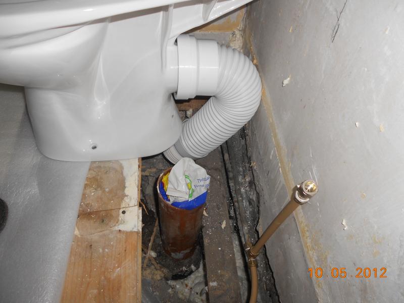

Hi,
Im replacing my toilet. The new model has a waste outlet that is much closer to the wall than the original. Now the toilet is over the original hole and I need to cut the wasted under the floor and use a bendy pipe to attach the toilet to it.
Im attaching a pic. Can anyone see any major gotchas before I start cutting the pipe?
Thanks!

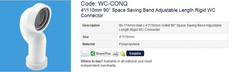

Have you considered using something like this.....probably better than using a flexi coupling.........your local merchant should be able to get you one / or ebay ?
That's nice! and I don't feel weird saying that :)
However it still would get me behind the waste and Id need to bend to it.
edit: Oh, I see that has the potential to bend at the bottom. Could be the job.
have a look at mcalpineplumbing.com.......and see if there is anything else that would suit.
no connection etc.
