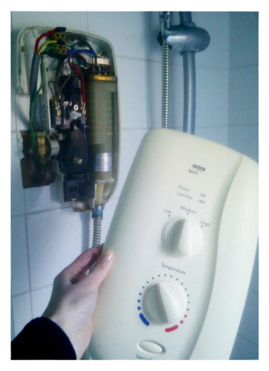

Hi all,
Our shower's on/off button has stopped working all together. No shower at all.
My OH likes to fix things himself and removed the casing for the existing Mira Sport shower, after turning off water and isolating electrics to shower and it says it is a 9kw 240v Mira Sport model.
He removed the shower after speaking with his father (a retired engineer and self professed DIY'er) and thought it was a straight case of nipping to a local shed and buying a new shower and installing.
I've checked this out though as I'm the researcher and I think we may have to have a sparky, even though we are totally skint and buying the shower was bad enough.
So Facts:
The Mira Sport shower was already installed when we moved in 6 years ago and is 9KW at 240V.
We had a modern RCD Consumer Unit installed in 2007 when we moved in.
On the RCD, the Shower has it's own switch stating B32 for 230 volts, the Cooker meanwhile says B40 (I assume this is the ampage). The Downstairs/upstairs sockets are on a B32 as well, while the lights say B6.
The Shower has it's own isolation switch inside the boiler cupboard (red flippy switch), as well as its switch on the RCD fuse box.

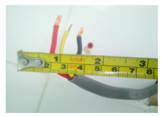

The cable running from the RCD to shower can't be more than 10 metres, as the bathroom sits 1 room from under the stairs in a small terrace.
The electric cable feeding the shower is routed under plaster with roughly 4 inch's neatly sticking out and looks in good condition BUT it is Red, Black and Earth, with the first two having 7 wires but the earth just being the 1 wire.
I have been struggling to decide as to whether this cable is 6mm or 10mm but I suspect 6mm, as just went to Bonus Electrical and looked at 10mm cable and that has 7 wires in the earth as well + looks very slightly bigger overall + obviously is blue and brown newer cabling inside.
Get a new switch.
But not in this case.
So Facts:
= 37.5 Amps
They should be the other way round (unless you have an industrial kiln)
That doesn't matter. They don't know what colour they are nor are they racist..
6mm² is fine as long as it runs through NO thermal insulation.
Nor conduit with the correct 40A MCB

If you can verify that the cable is run through NO thermal insulation NOR conduit then it is not necessary.
Hmmm. Checked those links e.g. the http://www.tlc-direct.co.uk/Technical/Charts/VoltageDrop.html but I don't know what the wiring will be touching on it's way up from under the stairs to the bathroom.
It's a 110yr old terrace with single brick walls and I have seen under the landing, roughly above the under stair cupboard and I think it's a hollow void with wires running along joists mostly. I doubt there will be any plaster board there or insulation. I saw under the floorboards when we had the boiler changed last year and it was just joists and laths and dust. What with the red and black wires being potentially from 1976 (when they were updated to blue and brown) and behind the shower being literally just fresh plaster (over brick probably), I'm not sure what that would mean for calculating whether I need 6mm or 10mm cable.
The colours are irrelevant, but you do need to know how the cables are installed.
If I wanted a 9.5kw shower though, I imagine I would then need 10mm?
Not necessarily - 9.5kW is 40A (they always quote the performance at 240V), and 6mm² can carry between 23.5A and 47A.
Depending on how it's installed....
