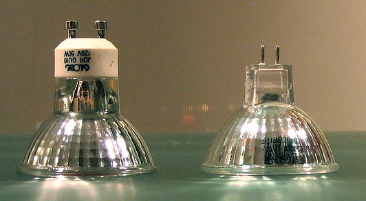

Andy - this isn't pointless pedantry - if you're looking for bulbs you need to know what the terms mean.
MR16 refers to the size and shape of the bulb envelope, GU10 is a type of base commonly used on MR16 bulbs.
Both of these are MR16s:
The one on the left has a GU10 base, and the one on the right is G5.3.
