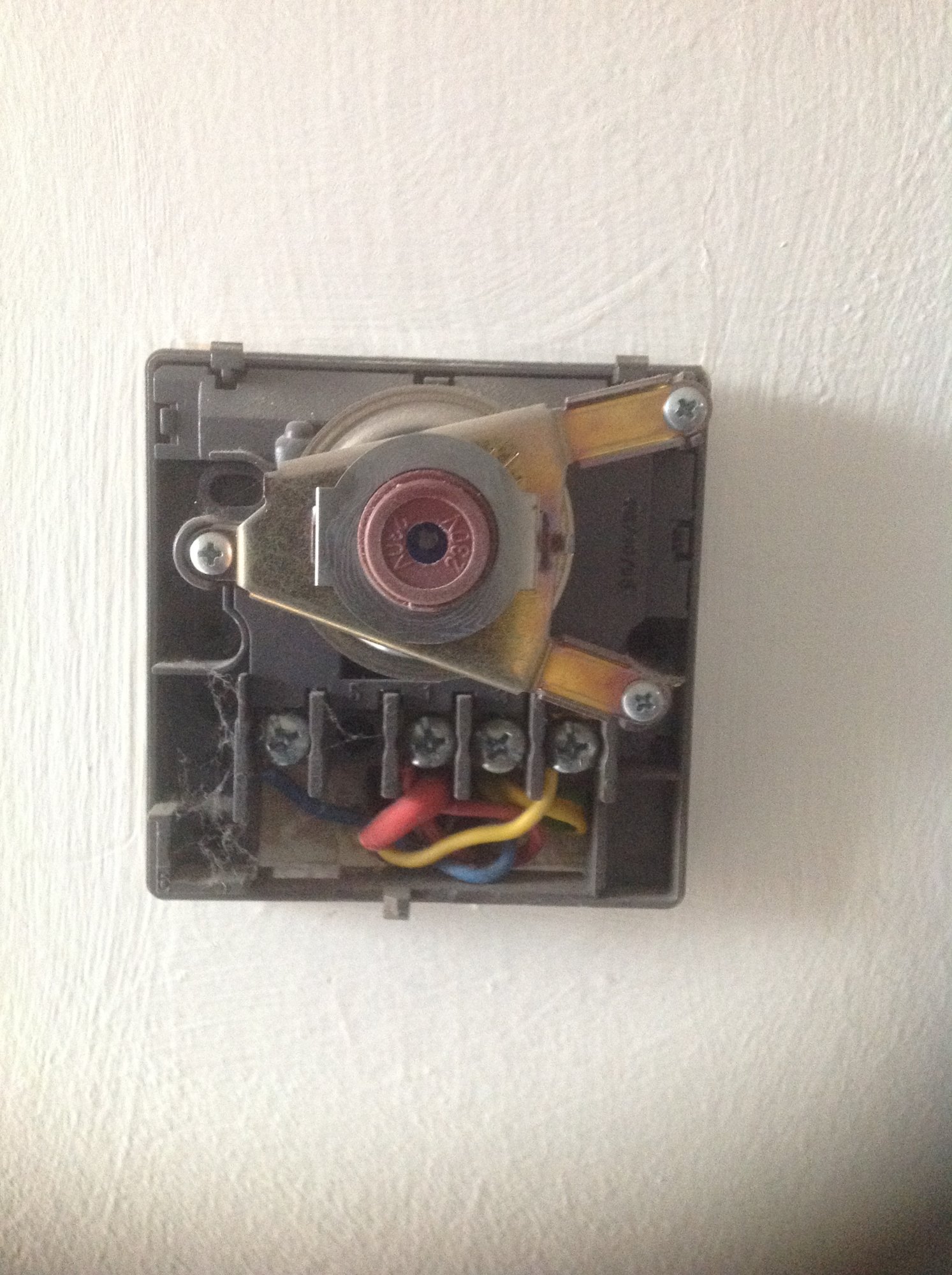

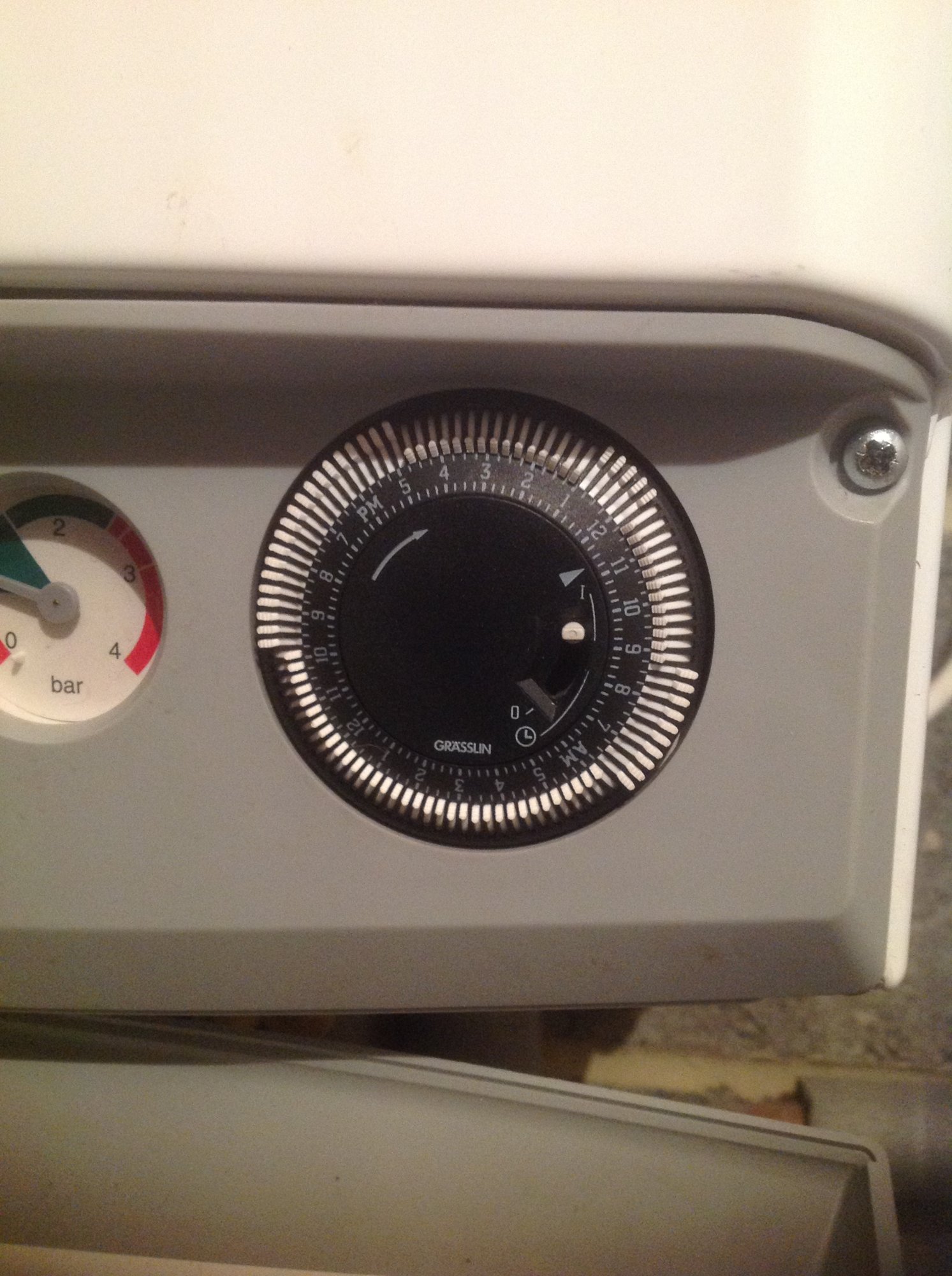

I have a Danfoss RMT230 room stat and having had my boiler replaced the engineer removed the programmable timer and all I am left with is the basic timer on the combi ( a Baxi platinum combi 33 ) and the Danfoss.
Would it be possible to replace the Danfoss with a programmable thermostat to control the boiler using the existing wiring?
See exiting wiring below

My current boiler controls are below what would I do with them or how do I control the boiler with the new stat?
Any advice would be appreciated

If you set the existing timer to constant (I) the programmable stat will then control time as well as temperature.
The RMT terminals are:
1. Live
2. Not used
3. Switched Live
4. Neutral
How you wire up a prog-stat will depend on which one you have - they will all do the job. Do you have anything in mind, e.g Honeywell?

Hi D_Halisham my RMT seems to have no wire at terminal 3
Blue wire to no 4
Red to no 1
Yellow ( with red sleeve) to no 2
Earth seems to go to back of unit
Hi looking at the Honeywell Lyric T6 a unit needs to be wired into the boiler is that correct?
Correct yes, you use two of the wires to your existing thermostat to connect into a receiver box, then connect the receiver box into the boiler using Live / Neutral / Switch Live.

My bad.:oops: I should have written:
1. Live
2. Switched Live
3. Not used
4. Neutral
For some unknown reason the terminals are numbered out of sequence, i.e 4,-, -,1,3,2.
