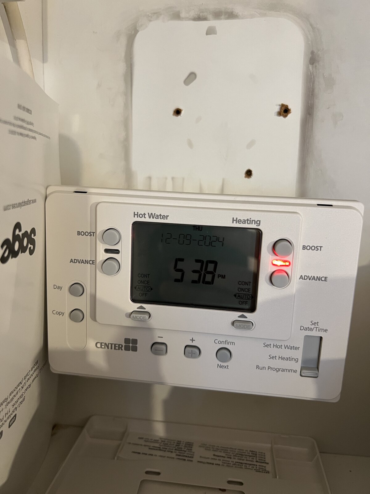

As per the title, we've moved in to a house with a pretty old system comprising unvented tank and system boiler. It's currently controlled by a Honeywell of some sort - not sure of the exact model number (see photo below.) This is hardwired back to the system via a disaster of a wiring centre. (See this thread for more information.)
The purpose of this thread is to seek recommendations for a new set of controls. We don't currently have any room 'stats so running on basic 5+2 schedule via the Honeywell. We won't be upgrading the core DHW & CH systems for a while but I would like to get better control over them as soon as I can.
