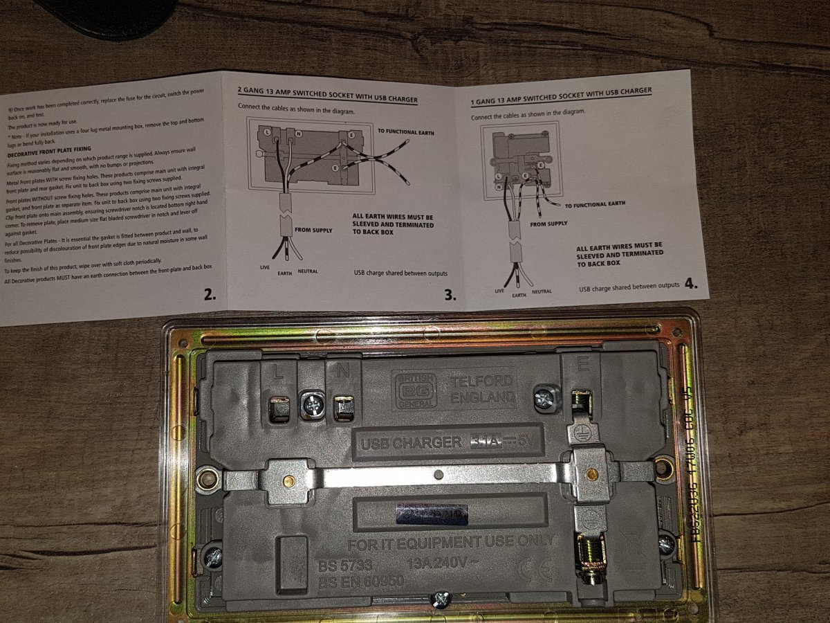

Hi there.
I'm trying to follow this thread with the same aim of changing an old socket for new. I'm going to try to upload two photos. The first should be the existing socket fitted. The second should show the socket to fit along with the confusing (to me) references to a "functional earth." The new socket has two similar earth connections. The supply has two mains cables (in and out?) With pairs joined. Am I write in understanding:
1. The conjoined earth of the mains cable may connect to either of the two earth connections on the new socket and
2. An additional cable needs to be fitted jumping across from the earth connection used on the back of the socket to the other one, so linking them together.
Just put both of your earths (CPCs) into either terminal. Job done. No need to link them they’re already mechanically linked and as you’ve got a plastic box, nothing to Earth there either.
That new socket and the instructions provided are a bit confusing.
The two Earth terminals on the socket are solidly connected together and both are marked with the Earth symbol in a full circle. This means they are both Protective Earth terminals and neither is a Functional Earth. Hence, as Iggofer has said the two CPCs can go into either one of the Earth terminals.
The instructions and the embossed " FOR IT EQUIPMENT USE ONLY " are not applicable to this socket. "" IT ONLY "" sockets use a Functional Earth which is NOT the CPC to Earth the IT equipment plugged into the socket. The CPC connect only the the metal face plate and/or a metal back box. The functional earth is a low impedance earth to provide to the IT equipment a clean earth that is free of electrical noise ( interference ) from other equipment.
