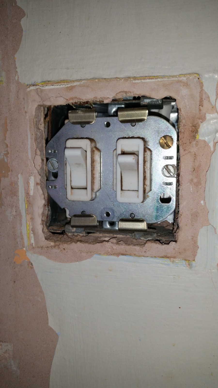

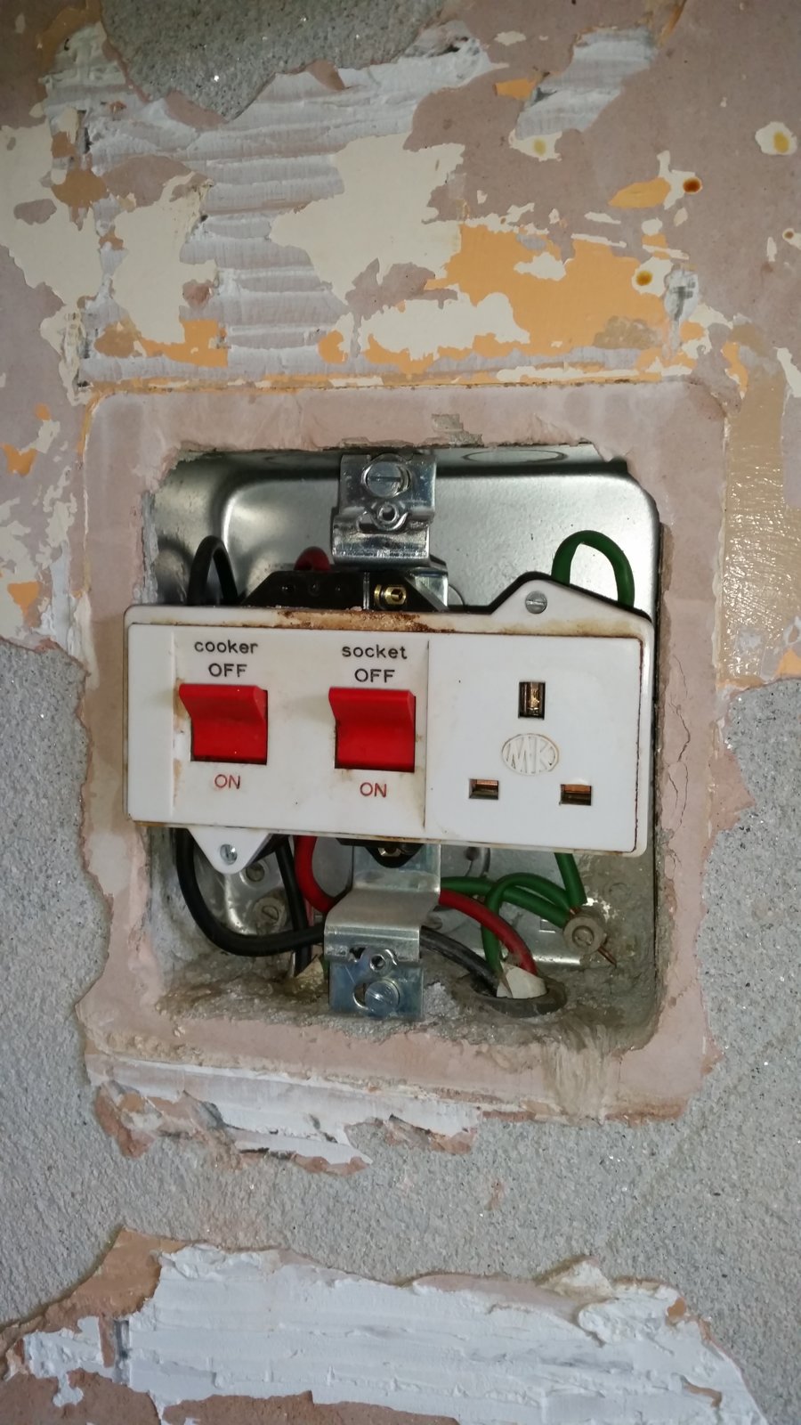

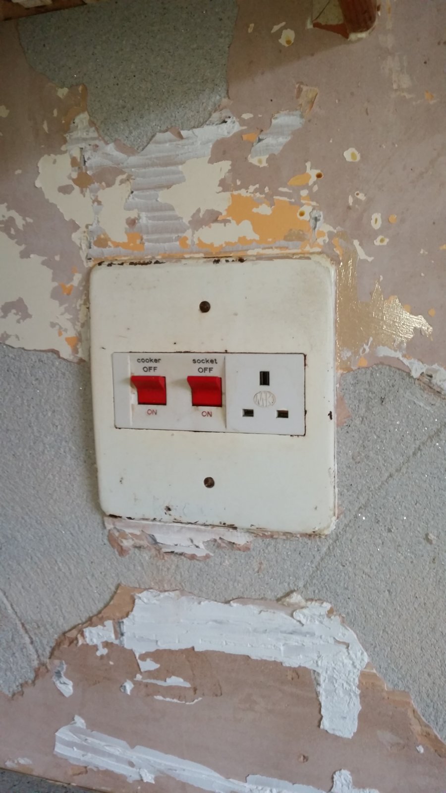

I am in the process of re-tiling my kitchen and would ideally like to replace a number of switches and sockets as they look a bit dated.
The combined cooker switch and single socket is slightly puzzling me though - it's a front plated type with a very large back box. Is it possible to swap this out for a 2-gang 45A & 13A switched socket and back box to reduce the size of the socket and then fill in the gaps left in the wall? Also, although the cooker switch is wired in, it doesn't appear to do anything. If I turn the switch off, the ignition/fan/clock etc. on my gas oven and hob still operate as normal. I'm guessing it used to control an electric oven that might have been there before I bought the house. Is it ok to just swap it out for a new switch or does it need to be disconnected?

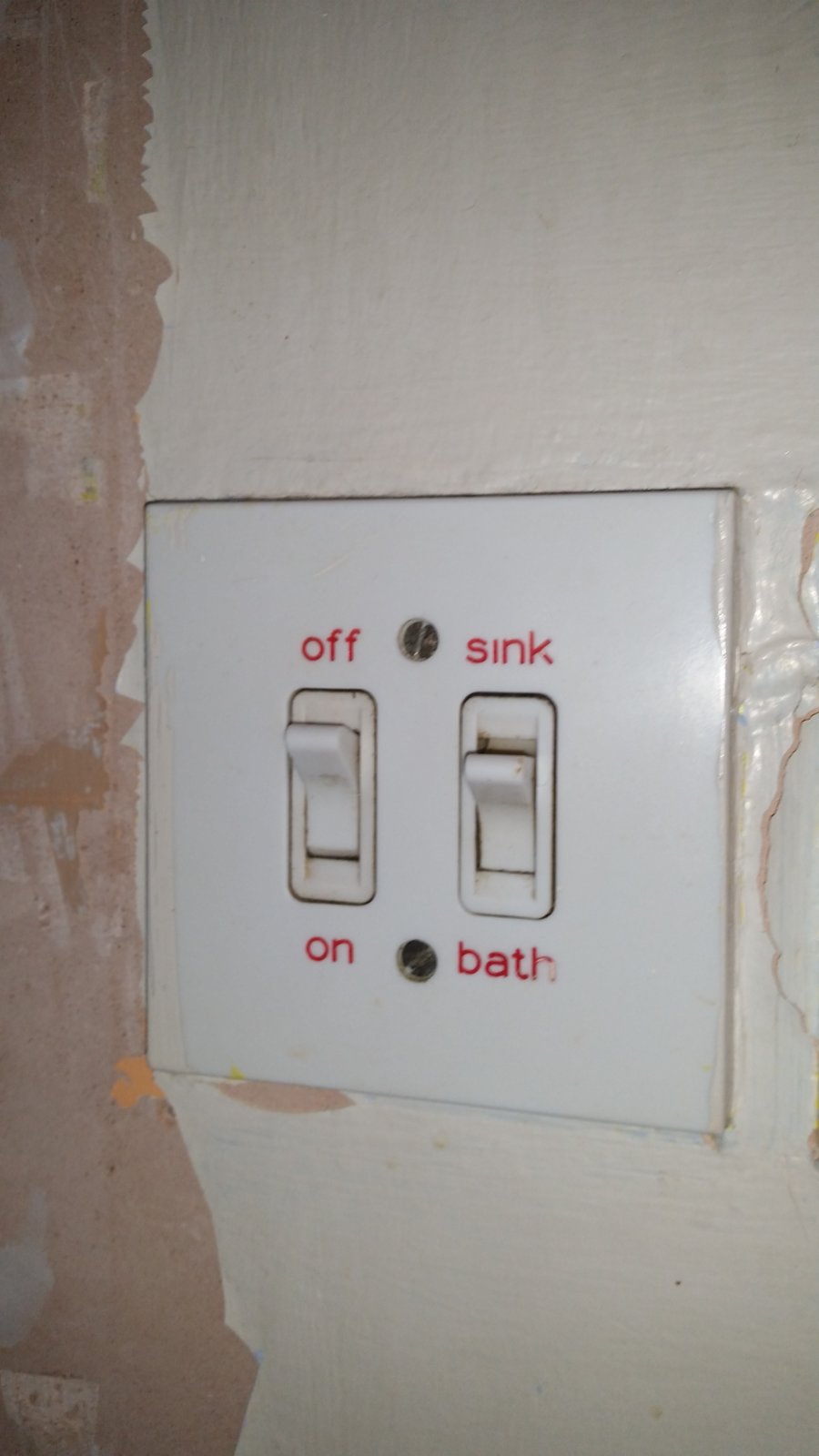

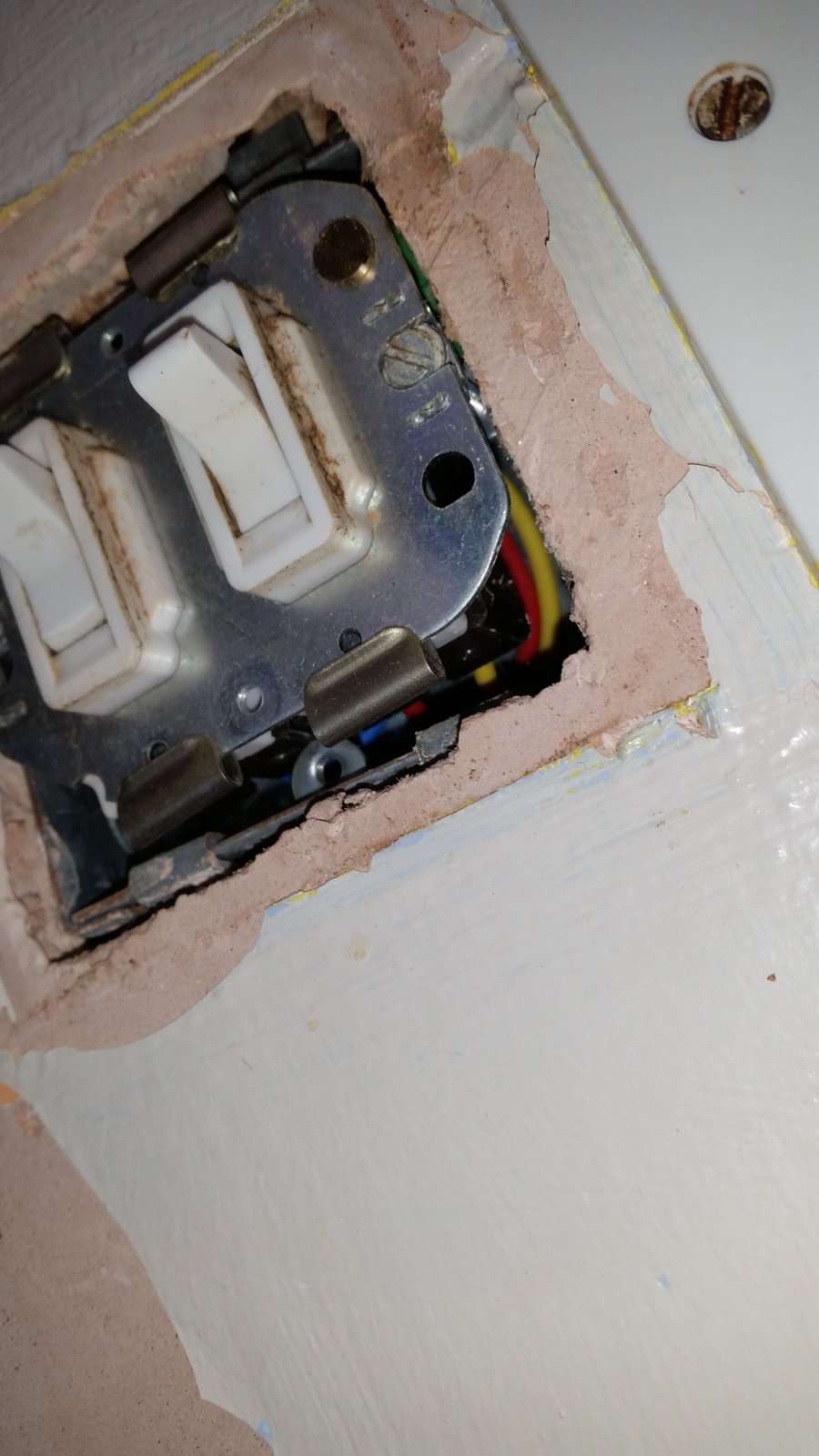

I have a similar problem with another old switch in my kitchen which I think used to function off the old heating system. It's still wired in (not sure if it's live though) but doesn't control anything. The trouble is I'm not sure what to replace it with - should I get it disconnected and fit a blanking plate? There doesn't seem much point in getting a new switch faceplate for it if it doesn't control anything.
I'm tempted to leave them both as they are to save time/money/hassle, but they are pretty grim looking!

A new, smaller cooker socket will look better, as you describe.
Is the wiring at the sink bath switch live? Possibly you can turn it into a single socket if it really doesn't serve anything.
If it is definitely and completely dead you could tile over it.

The sink/bath would have originally gone to immersion heater with two elements one only heating top of tank (sink) other heating whole tank (bath) as to what it does now only you know, in father-in-laws house it did the solar panels, in my house 4 sockets, all from the original 16A fuse/MCB.
You can still get grid switches, so easy enough to change, as to cooker, it would need the back box changing, years ago the cooker was supplied direct from cooker switch, now tends to have a cooker connection unit below the switch.
The problem is complying with current regulations, there is nothing to say you need to upgrade something, 40 years old, but if you do then it needs to comply with current regulations.

Yes, this is why I'm thinking I might just leave the sink/bath switch alone. I have no idea if it's still live or if it's function has been changed since the immersion heater was removed.
As for the cooker/socket switch, does anyone know if I can just swap it out for a new back box and faceplate? Something like this 2-Gang Cooker Switch & Socket and back box?
If you are feeling lazy, you could replace the existing cooker/socket switch - as far as I know they still make them, and they can bought on ebay often.
The part number is MK5011. Made by MK.
My main issue with the existing cooker/socket switch is that it's very large and looks a bit dated, so I don't mind swapping it out for something smaller rather than just replacing it for the same part. Although it's handy to know you can still buy them if I happened to change my mind!
I'm just not sure what I should buy to replace it? The majority of cooker/socket switches I've seen are the 45A cooker and 13A socket type like I linked to above. Would that be ok?
Click Polar (Scolmore) make sink bath switches, if you wanted to change the old one, though it would be better to see if it is live first.

How long has the sink/bath switch been switched off for? A long tiime? just replace it with a 13A socket.
How long has the cooker switch been switched off for? A long tiime? just replace it with a double 13A socket, its much cheaper but leave the outgoing cable in place and let the buyer know it's ready to be reused.
