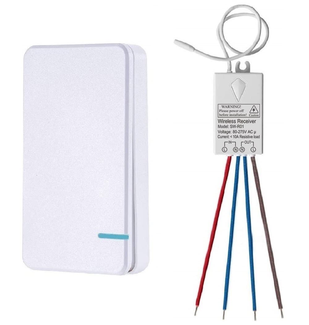

Hi,
We currently have a pull cord switch in the bathroom that operates both downlights and the extractor fan. I'm planning to replace it with a wireless switch (see photo 1). The wireless receiver has both IN and OUT options for L/N wires, however my pull cord switch only has two wires L/N (see photo 2).
I'm therefore not sure how to install the wireless receiver ... i.e. when I remove the pull cord switch, should the L/N wires go into the IN or OUT end of the wireless receiver? Or do I need to find the main connection up in the loft to install the wireless receiver there?
Thanks and advance!

Likely at the lamp you can fit a relay, but there are many ways around the problem, you have to decide which to use.
So can use a PIR for fan, then sure it is switched on.
Also, PIR for light, although sitting on the throne, waving one's hands to get lights back on, does seem a bit odd.
Smart bulb, of course, but that leaves the fan to sort out.
A smart switch, battery powered.
But all, including the smart relay, I can't see how to integrate the fan? There is no need for the fan and lights to be connected, a simple pneumatic time switch can work the fan.

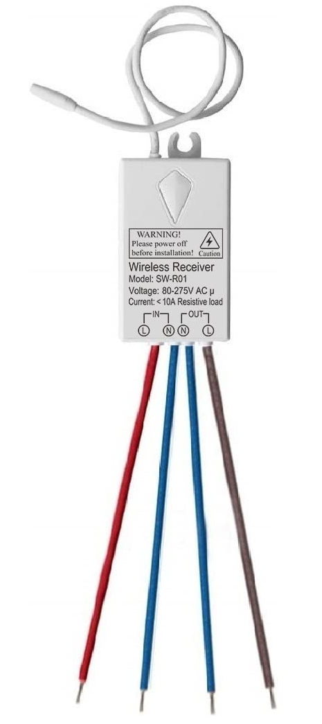

OK the 1718964178126.pngbit goes at the light, not the switch, the existing pull cord becomes redundant.

However, to be fair, your answer was more or less, given in post #2!
