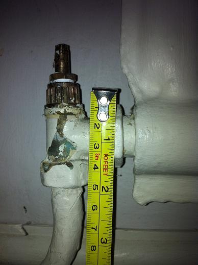

I believe there copper pipes, but years worth of paint on them. Measuring the pipe going into the valve from the floor looks like 15 mm however the fitting into the radiator there the old type the councils used to fit as this is ex council hose.
whats confusing me a little is the sizes i see online
15mm x 1/2 "
I assume that means 15mm inlet (the bottom) and 1/2" outlet, if so my outlet looks more like just under an inch, but i assume i need to take into account the years of paint on it so maybe 3/4" ? New valves if they didnt fit I can purchase a adapter (i forgot the name of it something tail) however would that not make my pipe out of place to fit the new valve?

Pictures of the valves would be helpful.

I was trying to be realistic matching the nut/union to these valves is very unlikely
There is a picture on his previous post "leaking gland nut" or something like that. Although you can't see the union in the picture the valve itself gives you an idea.
Removing the tails from the rads I picture these valves connected to would not be easy. I have had to remove the radiators and heat with s blowtorch on many occasions. To change both valves on 6 or so rads I would allow all day.
Not the easiest job for a diyer

Here is a pic of the valves if this may assist someone in recommending a replacement valve they are the same on all the radiators in the house.
here is the pic
Going back to your original post. You say you want to control individual room temperatures. You would need Thermostatic Radiator Valves (TRVs) to do that, not manual valves. All they do is control flow.
Unless you are going to turn off the valve when the room reaches temperature then back on again when it cools.
