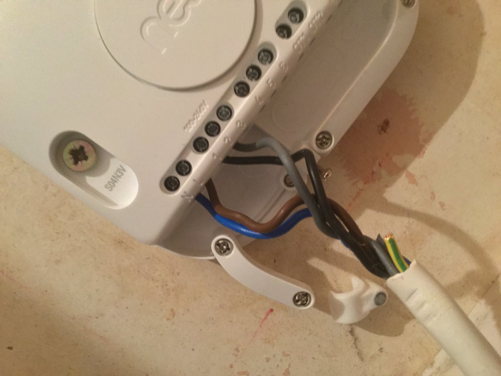

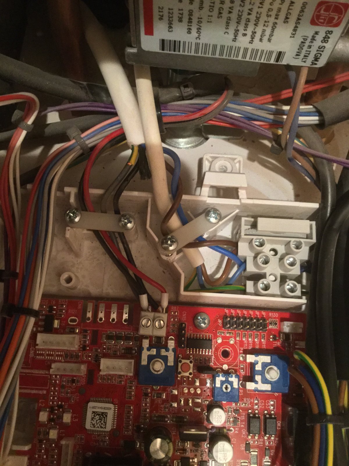

So I decided to swap my old Salus RT500RF thermostat with a new Nest gen 3 thermostat. I thought it would be case of swapping the boxes over but I’m not sure the wiring is correct or if I’ve got the wiring correct. The boiler it’s connected to is a Vokera by Riello easy heat plus 29 c The old salus box is connected to the CN5 circuit that much I know but I’m having trouble understanding if I’ve got the right wires in the correct ports on the heat link, because the back of the salus box is different to heat link. I’ve included pics of the wiring on the heat link and the wires on CN5 circuit

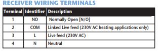

The Salus RT500RF receiver wiring terminals are:
The existing wires, (including any link between terminals, but only if one is already present) that are presently connected to the Salus receiver are simply rerouted to the Nest Heat link terminals that have the same function:
So:
Salus 1 NO = Nest 3 Heating call for heat
Salus 2 COM = Nest 2 Heating Common
Salus 3 L = Nest L
Salus 4 N = Nest N
The Nest thermostat needs 12v to operate and it can get this either by connecting its T1 & T2 terminals to T1 & T2 at the Heat link, or by using a separate plug in power supply. If you do use T1 & T2 to power the thermostat, then an earth connection should be made to the Heat link earth terminal.
If your boiler has any separate time control it should be set to be permanently on 24/7, but this would have been the case with the Salus already anyway.
you have wired that wrong in your pic of the nest take the wire out of terminal 1 and put it in 3, you will read posts on here about installing links DO NOT do that with your boiler
