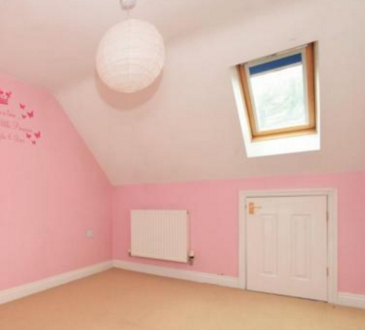

I know nobody likes to put a price on anything, but I am keen to have a rough idea of replacing a roof window with a dormer window in Essex. About how much would I expect to pay? Is it about 2 days labour + materials + scaffolding? Or is more involved?
Alternatively, it might involve adding an additional dormer on the opposite wall (and keeping the roof window). Would that cost be the same.
Internal photo of room looking to improve, plus pic of the type of window in the area I live, in Essex.

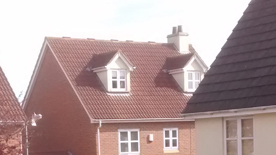

Anyone who has guessed so far has never had to build a dormer and is likely to be clueless. Expect upwards of £5k. I did both of these in the images. One was built as a dormer the other was converted from a flat roof dormer to a pitched.
