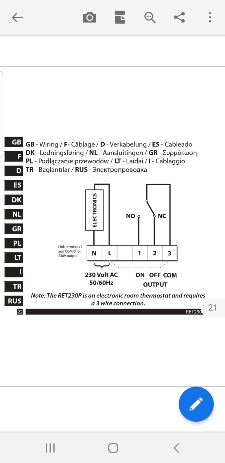

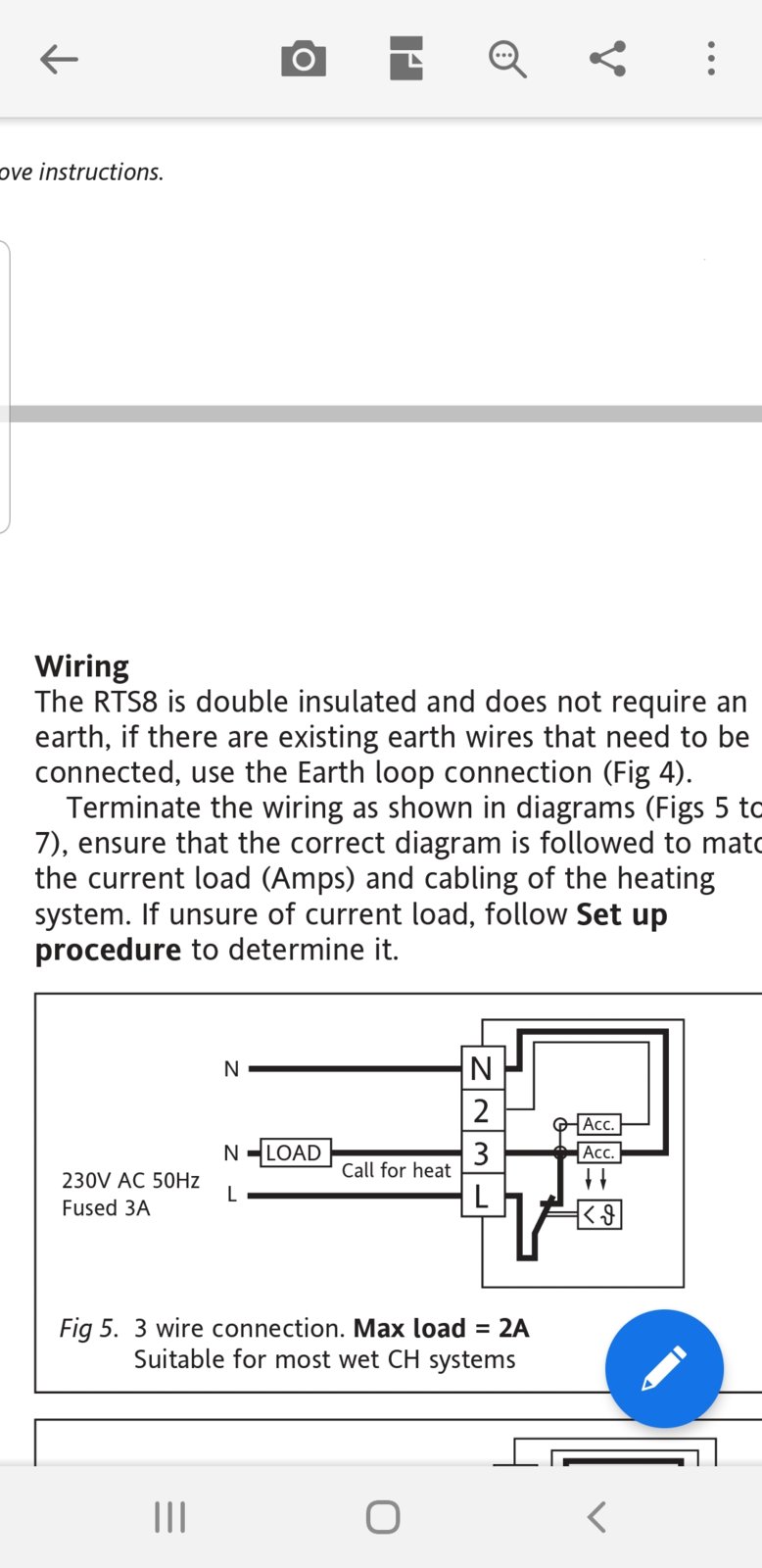

Replacing room thermostat
29 Jan 2020
4
Hi guys I need to replace my old Danfoss ret350p with drayton combi stat. I attach wiring photos below as I ve no idea. Never done it before . Thank you in advance
I dont know. Will be in the house tomorrow. What if it does or doesnt?
If it does all is well.
If it doesn't it might be switching 12V or 24V - you will have to find out - from the boiler and your new one is not suitable for that.
I will check it tomorrow. The boiler is atag a325c . I did buy the same danfoss stat just in case .
