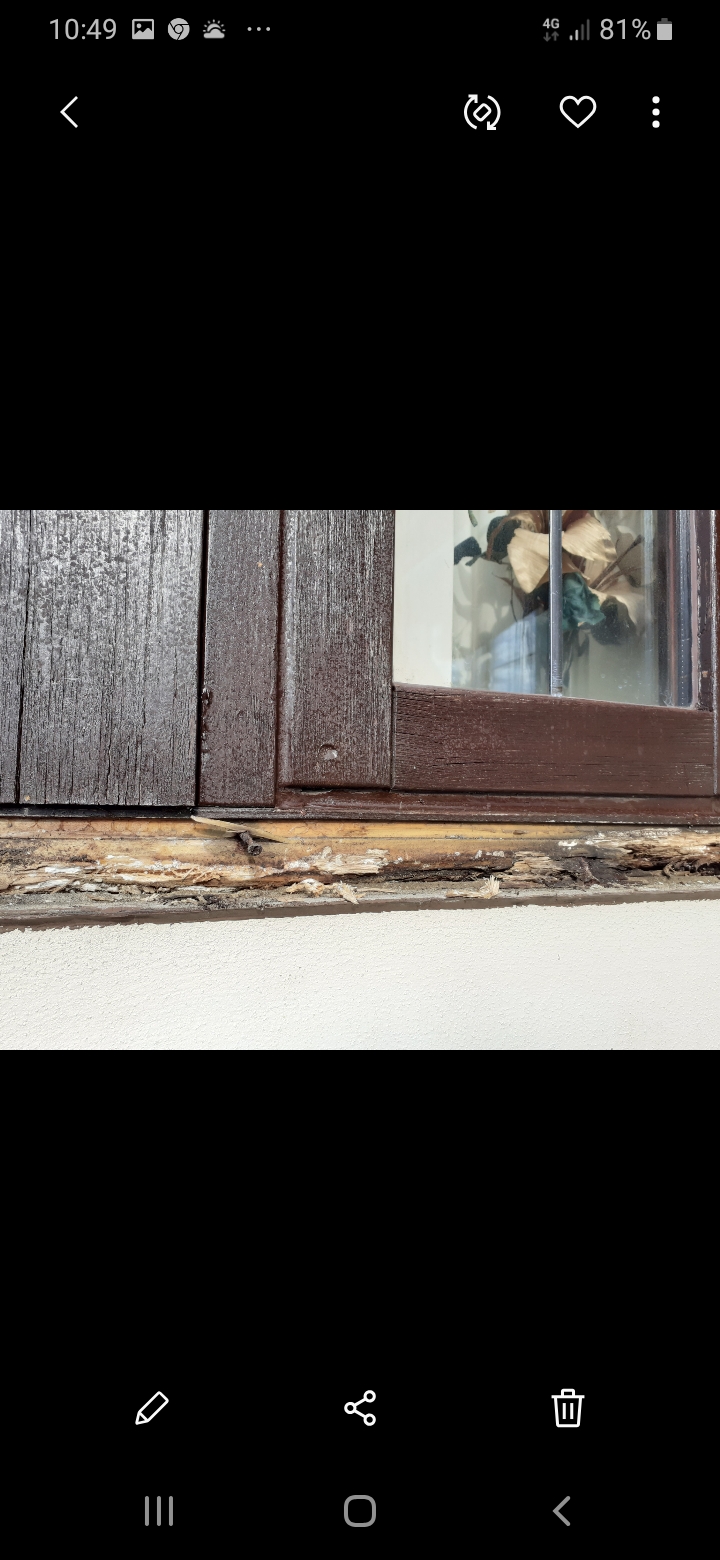

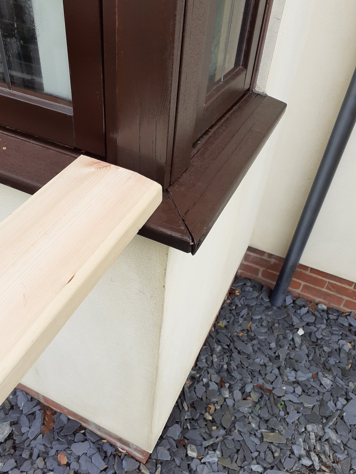

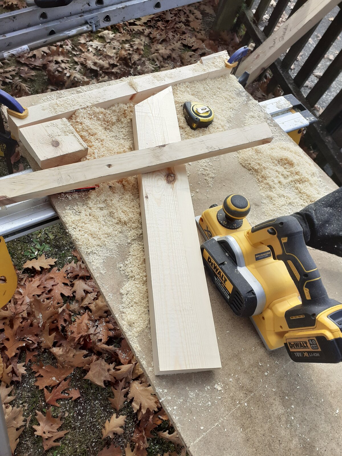

Got a replacement piece of wood for a rotten window sill. It's 45mm thick and a few cm wider than old piece. I was just gonna plane it down to right thickness. Regarding the mitred angle would definitely be just be 45 degrees ( which would mean just cutting it with chop mitre saw) or do need to scribe it in somehow?
If you can take the side bits (there's probably a proper name for them) looks like you won't have to. Is the chamfer of the new wood the same as the old?

So how much of the cill is needing replacement?
Is the window light (sash?) fixed or hinged?
Is the cill separate from the casement? If it is do you know how it is fixed?
Yes the corner should be a simple mitre at 45 degrees.
Once you have the replacement sized to match don't forget to create the 'Drip' grove.

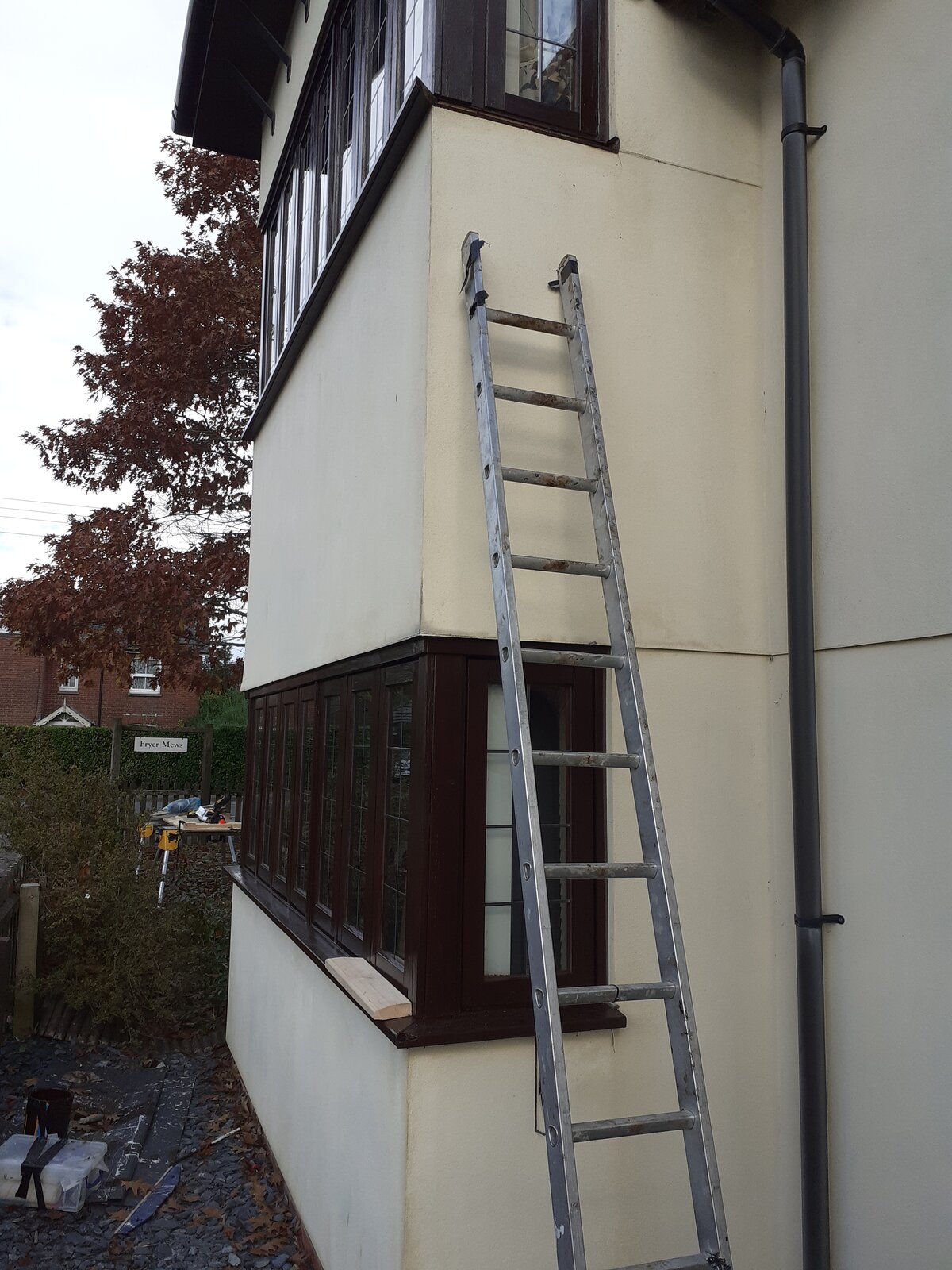

It looks to be separate.
Must admit, i am with EddieM, It looks like that sill is a so called Planted sill meaning the external sill appears to have been retro-fitted to the rest of the sash?

It's just the small end bits which need replacing. Top and bottom. I've used untreated wood. I planed it down to thickness and will paint sadolin wood stain over it. The mitre cut seems a bit off as I used the old one as a template. Was going to screw and use sticks like **** to hold it in. I guess get external brown silicon too.
How do I cut a new drip groove? Hand saw?
Cant seem to get this piece in. Feels jammed. Can u see the big gap where I'm trying to push it in. Shall I just put silicon ro cover that?
Two possibilities instantly?
Check to see that the remnants of the old sill are totally removed.
Most likely is that the new sill is just a small amount too long? in that you are holding the Miter to get it to mate as well as you can but the overall length of the sill is jamming as you offer it into place? to check, slide the sill in but keep the end nearest the wall actually rubbing on the wall??
Ken.
It looks like the insert is tight where your thumb is, but whatever you do the mitre is going to have a gap :(
I think you’re a bit tight at the wall too - and that bit is easy to sort with silicone.
