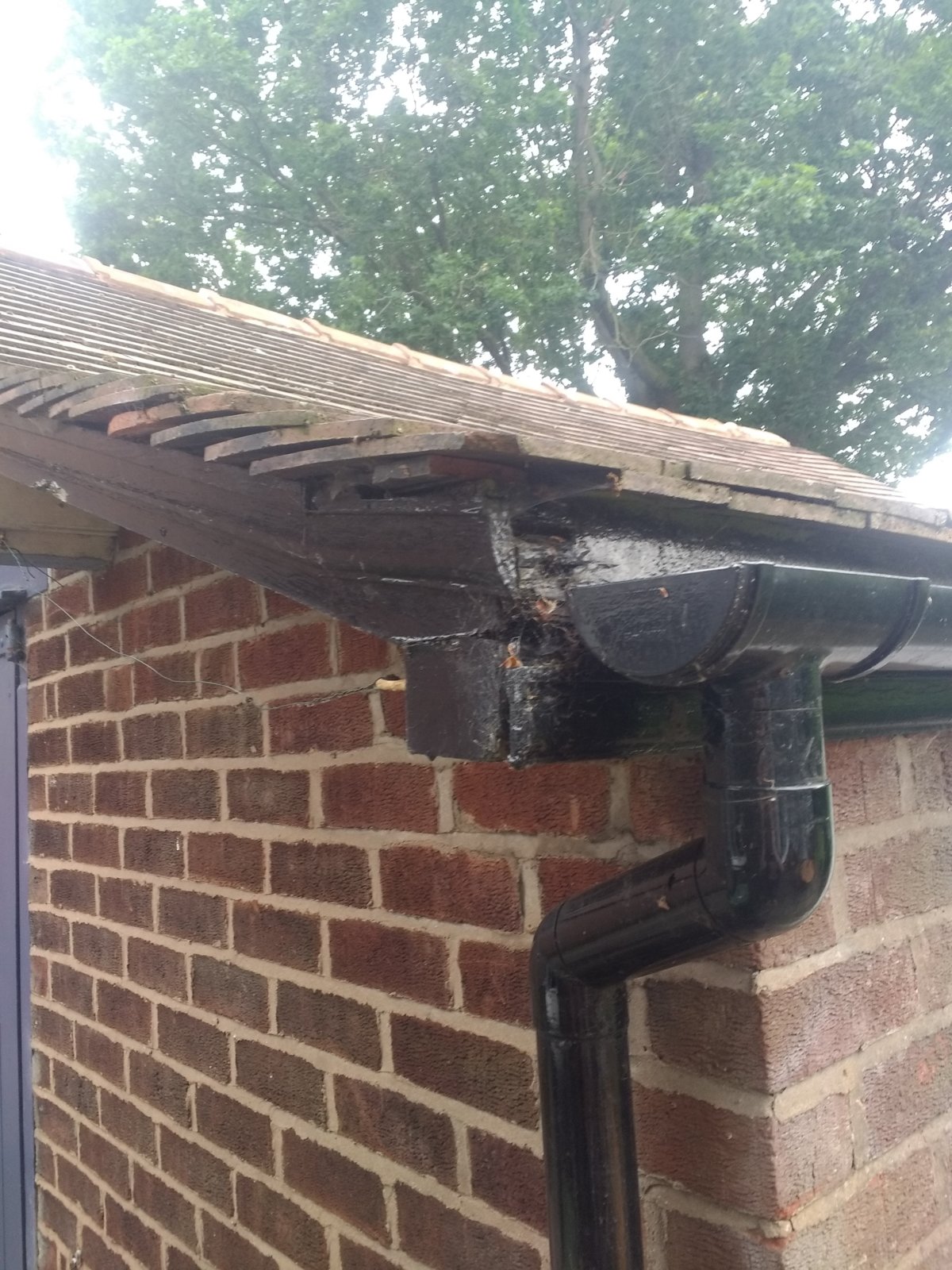

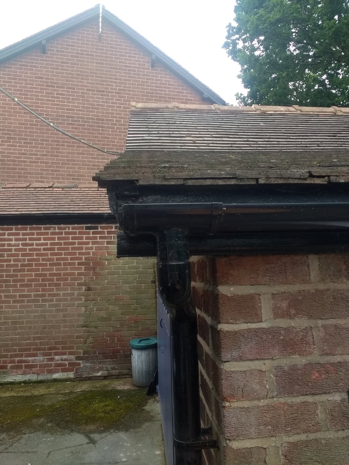

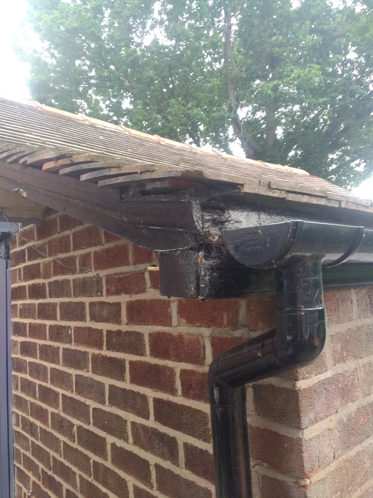

I have one verge tile (plain clay, original 1930s roof) on the bottom eaves course that is broken. Can anyone advise on a good way to fit a new one? I don't think I can nail one unless I take the whole verge off.
I have a normal tile and a half to put in there but it will need cutting both on the side and the bottom as the width is a bit less than a tile and a half and it is an eaves tile. I don't have an electric cutter. Would scoring it and snapping it work?

You need angle grinder to cut , also timber needs replacing where rotten and gutters too short .
They will pincer off ..
Or...get yourself a brick hammer and a spare tile betwixt your legs and chip it off, like wot we used to do. Showed the young 'un t'uther day, as he was about to rush off and get the grinder. He was most impressed.:mrgreen:

in your case looking again at the picture the eave course is way off bond. I'd pull out a couple of tiles back from the verge which will make getting the damaged one out easy. A bond so far off, little care has been shown so they might not be nailed anyway.
Replace the damaged one with the T&H with the bottom cut off or top if you can drill....
Then cut the side off an eave to get the bond back... Easy
