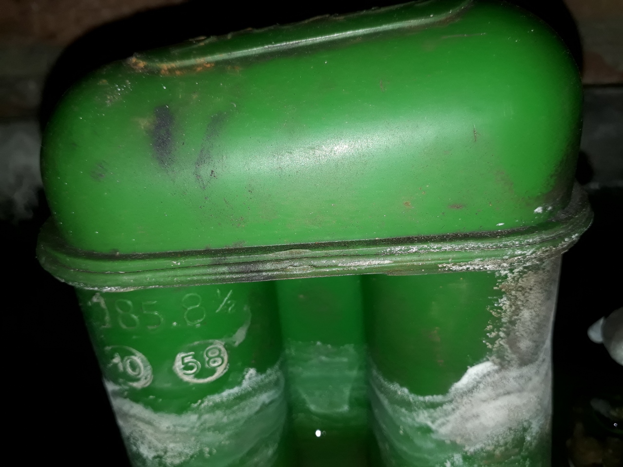

When I want to flush the toilet multiple pulls of the chain is required and it is getting worse over the past few months. I was told that I need a new siphon. But as I know nothing about plumbing I don't know if this is true either so please excuse my ignorance. I do know it is old, I am guessing 40-50 years old, may be older. Trying to remember when my father replaced it.
From reading around it appears I have a "well bottom" cistern and when I remove the lid I can see that the siphon has the name "Shire" on the top of it. On the side are the numbers 185.5 ½.
In two separate circles there are the numbers 10 and 58. I don't know what the numbers mean but thought they might help experts on this forum.

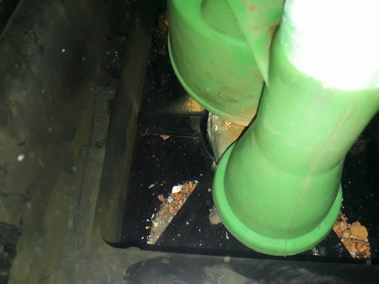

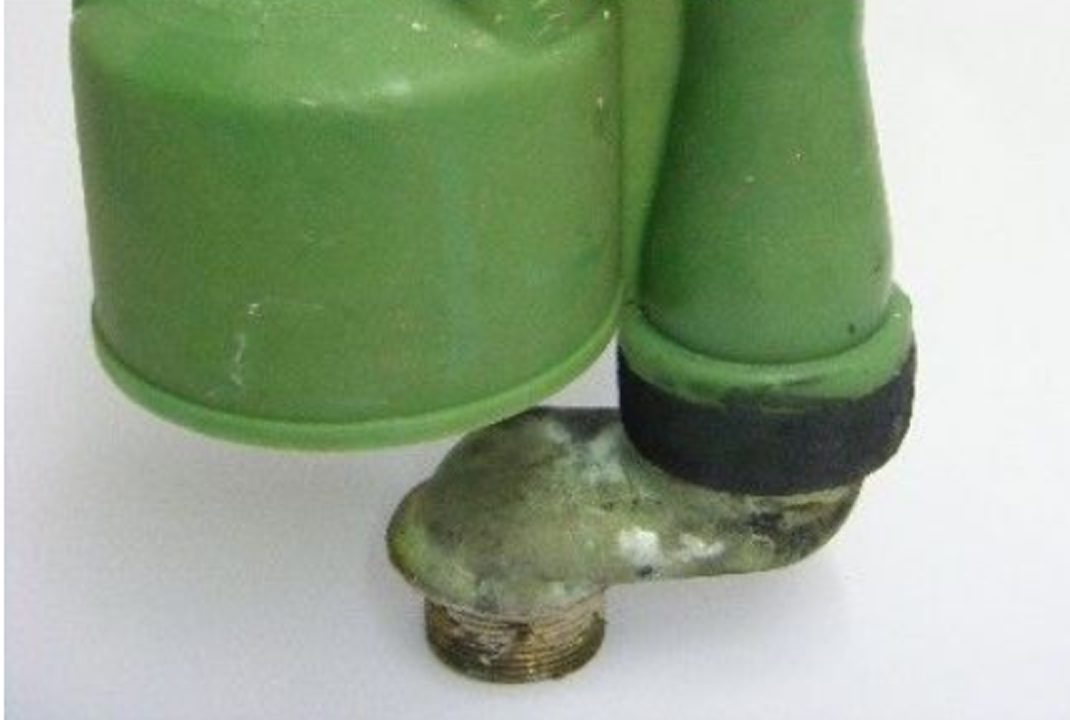

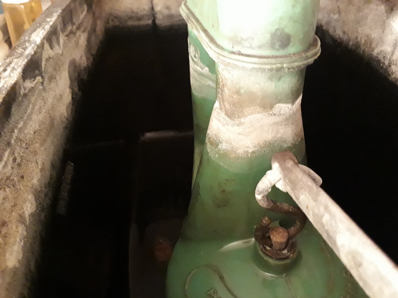

Photos as suggested. Do these help with identification?
1. That's not old, its made of plastic.
2. The really good old ones had an inverted "bucket" made of cast iron in a sort of bell shape.
3. Pull the handle, chain pulls the lever, lever lifts the "bell".
4. Release handle, bell drops under its own weight, forces water into flush pipe, starts syphon. Syphon runs until air comes in.
5. No diaphragm's, simple and robust.

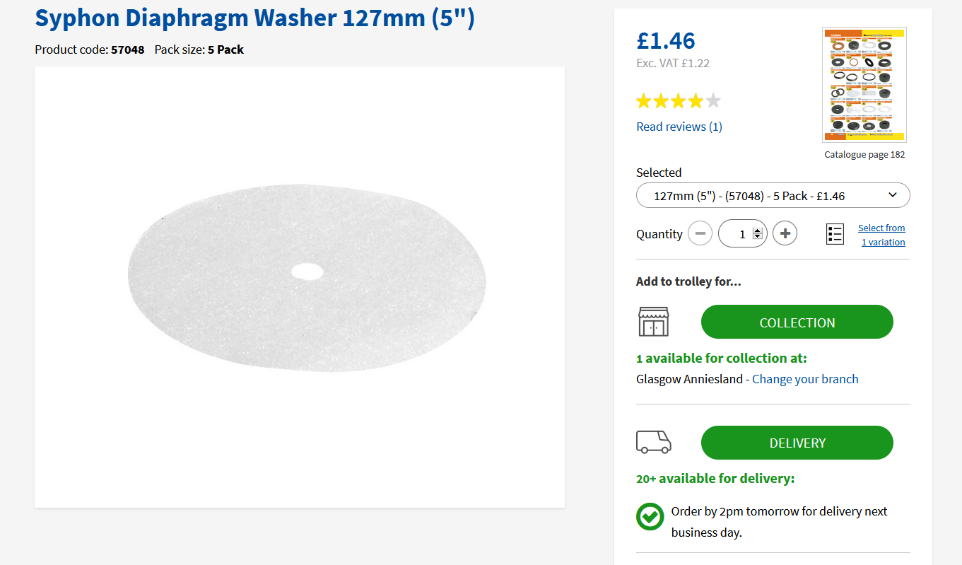

Toolstation, two sizes 5" & 4 1/2".
https://www.toolstation.com/syphon-...MIyu6FqZqb6gIViLbtCh3lSgzjEAQYAyABEgJ75PD_BwE
The height of the syphon in your pic is 8 1/2 inches.
Which is likely to be easier for a DIYer. Replacing the siphon or replacing the diaphram. Do you have to take the siphon out to replace the diaphram?
I didn't know the 8½ on the siphon related to its height. So do I need to find one of the same height as the one in this link is 9 inches high.
Would this be too high. If yes, any suggestion where I can find an 8½ inch high siphon.
