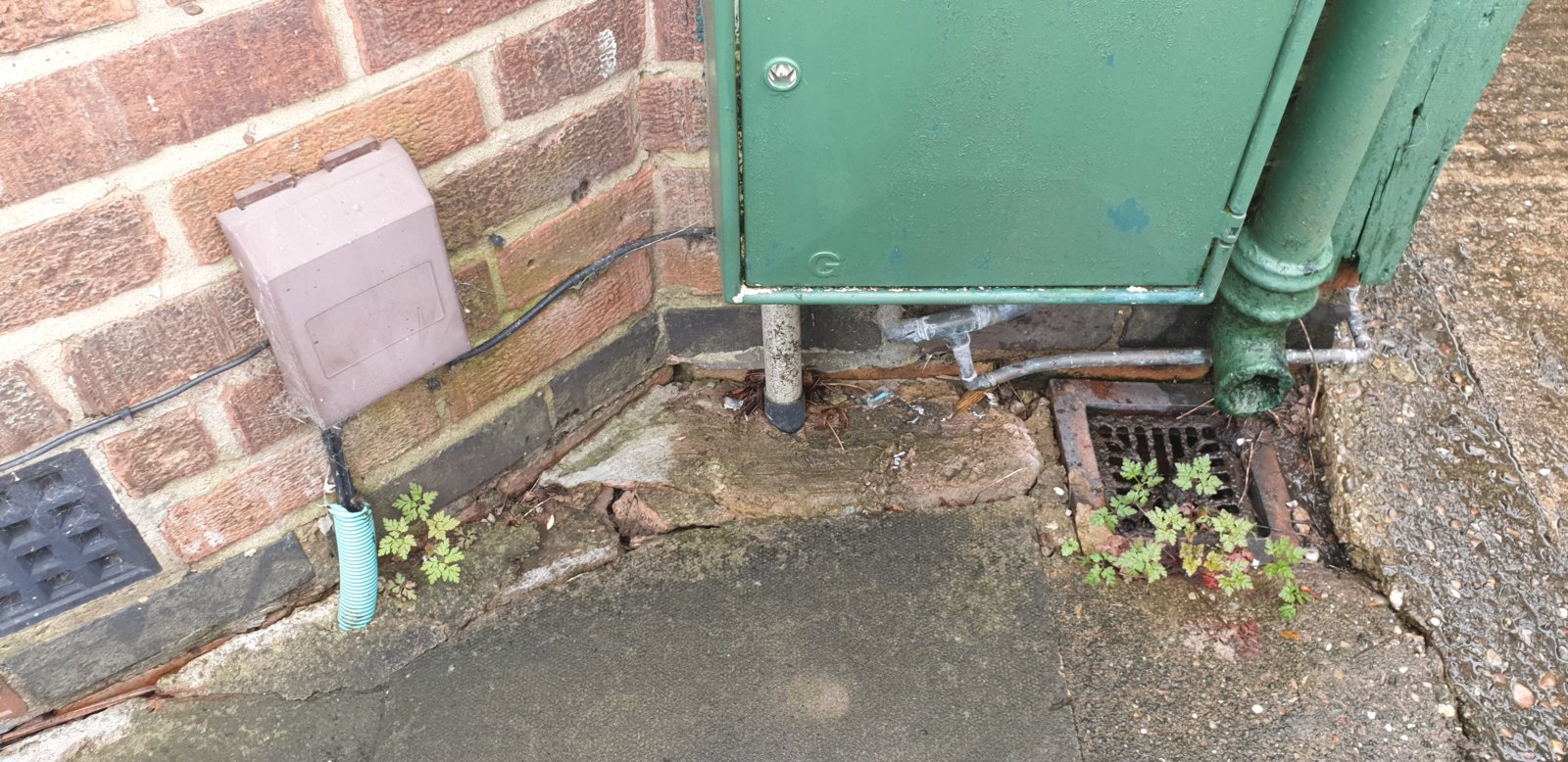

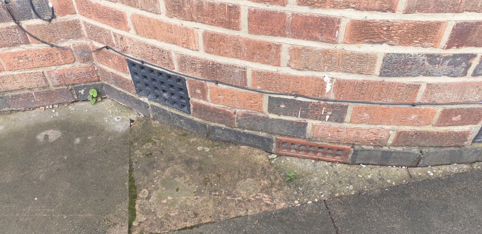

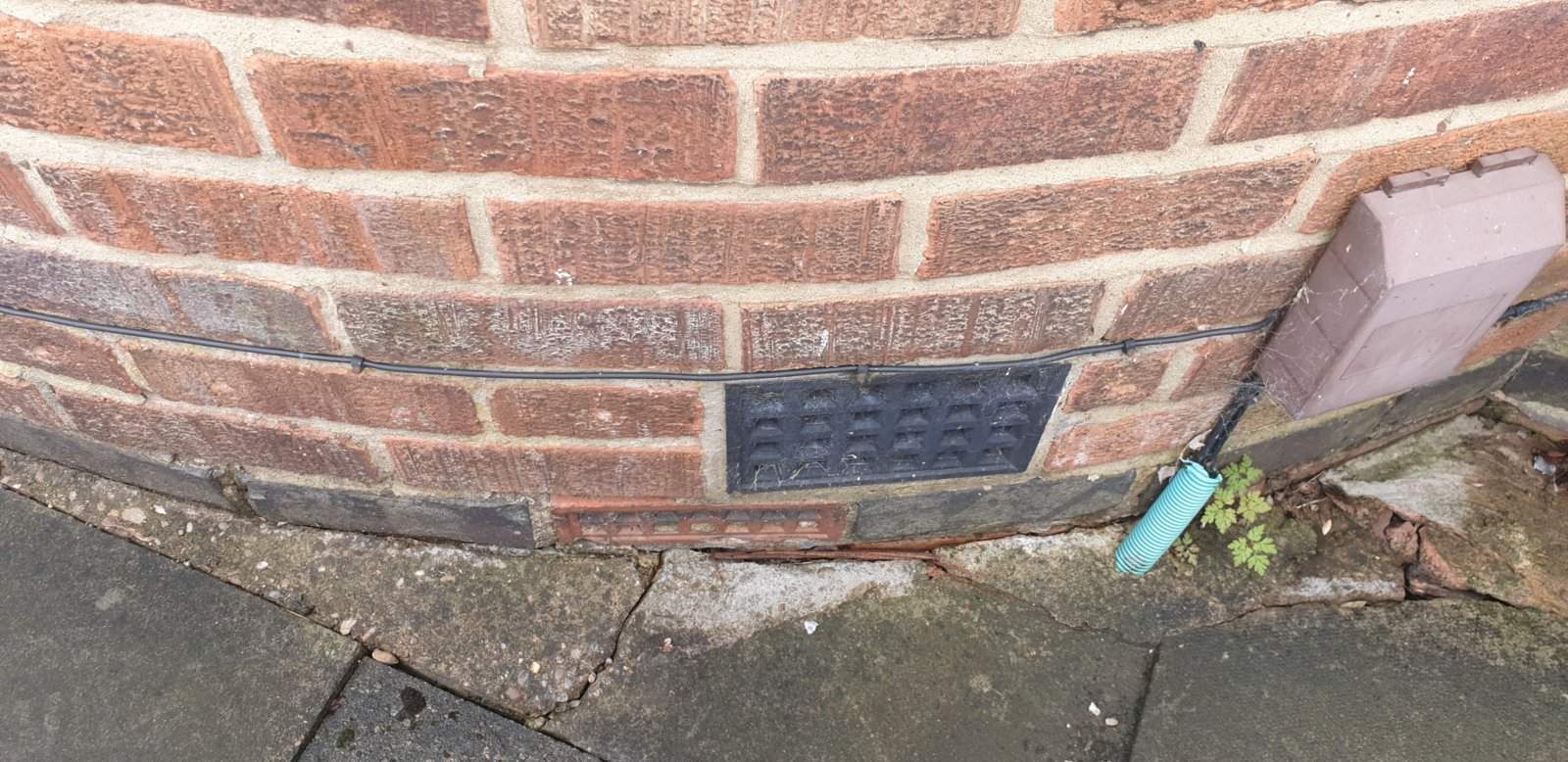

I think the drainage is poor as the ground slopes towards the house and the driveway is rubbish. I have had the council clear and check the road gully outside. Also had the water pipes checked for leaks and cctv'd the drains. We have replaced one cracked gully to the side and I have my suspicions about the front one, may chuck some food dye down it and see if that turns up under the floor - the water however is the opposite end to the front gully and the driveway - the end nearest the front of the house is dry (though the ground level is much higher here.) We intend to put in french drains when we redo the drive. Will post some pictures.

I would have thought that the red airbrick is too close to the ground and more likely to allow water IN than ventilate air in/out
I'd either move the brick up or remove the concrete that surrounds the area and add gravel
