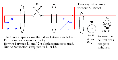

Hi guys.

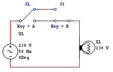

Trying to instal a dimmer switch but the arrangement I have is quite tricky so though I will ask for some advice.
So the lights in my house can be controlled via multiple switches.
I have 2gang 3-way switch in the kitchen to control kitchen and living room lights.
I have 2x 1gang 3-way switches in the living room - one controls the living room light and one controls lights on the stairs.
and there is another 2gang 3-way switch on the stairs to control lights in the living room and on the stairs.
I know that I can't have more than 1 dimmer in the setup or it will flicker.
Since the living room dimmer is most crucial I would like to replace one of the 1gang 3-way switches in the living room.
- Can I also replace another 1gang 3-way switch in the living room (the one which controls the stairs light) or will it flicker?
- The 1gang 3-way switch in the living room have 2x L1 and 2x L2 connectors while the dimmer has only a single L1 and single L2 plus ground. How should I wire it?
- Anything else I should be aware of?
thanks for all the help
