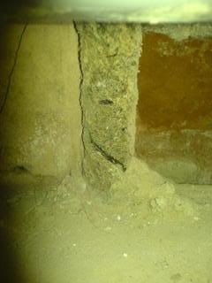

I need to move the electric setup, onto a new piece of wood (Like RF Does on his jobs), as the render on the wall where the meter cupboard is, is crumbling off, so the pieces of wood with the Meter & the Service Head on, are starting to come loose (As you can see in the picture below) (There will by a new CCU & Meter Fitted soon)

What type of wood should I use for the new back board :?: & What do you use to raise the board off of the wall :?:
For your safety contact your electricity supply company and discuss this change of mounting for their equipment BEFORE you do any more work around the meter.
I have seen the result of a DIY attempt to replace a crumbling board behind a cut out. It wasn't nice, and the neighbours who lost power for several hours were not friendly when the DIYer came back from hospital.
If the meter board is crumbling away mains will usually replace it free of charge as it's a safety issue.
As said above PLEASE DON'T TRY YOURSELF!
Contact your supplier.
quite right - don't try to move the supplier's equipment yourself.
If you want to fit new board for your own stuff (IMO it looks neat and clean and you can lead in the cables from behind) I think laminated chipboard (as used for kitchen worktops) is good. The surface is non-conductive and wil not support a flame, it is easy to wipe clean. You have to drill pilot holes for your screws as the surface is very hard. You can mount it on 2x2 timbers (50mm x 50mm) which gives plenty of room. You only need one at the top and one at the bottom (this keeps out dust and most fingers). The mounts can be painted to match the wall if you can be bothered. You can jig-saw the aperture to match the cutout in the back of the CU before fitting it. This should be well away from the edges of the board.

The board looks ok, but it's the render on the wall, which is crumbling off, so the rawlplugs which are holding the board on the wall have nothing to hold in to :!:
screws should not be into render or plaster, they should go into the brick. Maybe you could take out one screw at a time, redrill, fit plasplugs or frame fixings, and secure?
