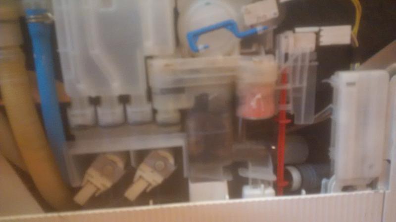

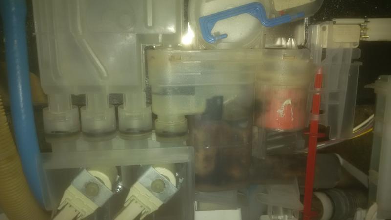

I have a Bosch Logixx dishwasher. From reading around the forum, I need to clean the pressure chamber. I have removed the left hand panel. But all the posts I can find say "I removed and cleaned the pressure chamber". So it must be straightforward and easy. Alas, not to me! Feeling a bit foolish really!
If anyone can help me with some advice, it would be really appreciated! Images of the pressure chamber below:
And sorry - I cannot find a model number anywhere, and no rating plate.
Many thanks, Nigel
The larger plastic container on the left unclips at the top and pulls away.Catch any spills with a towel , you dont want any water in the base.
