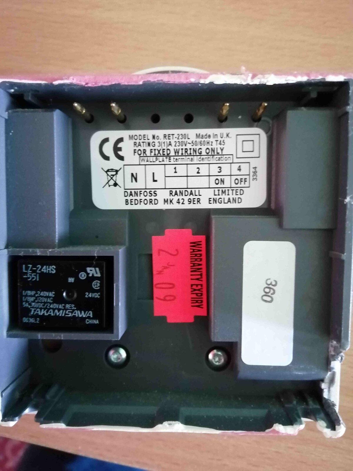

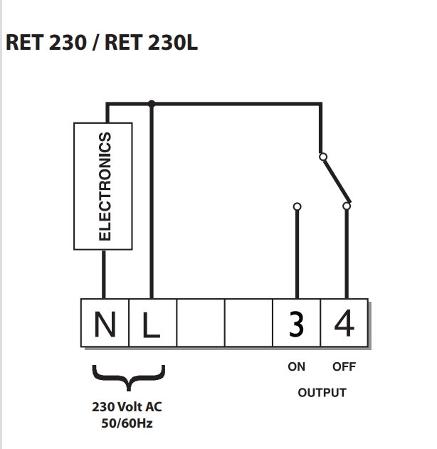

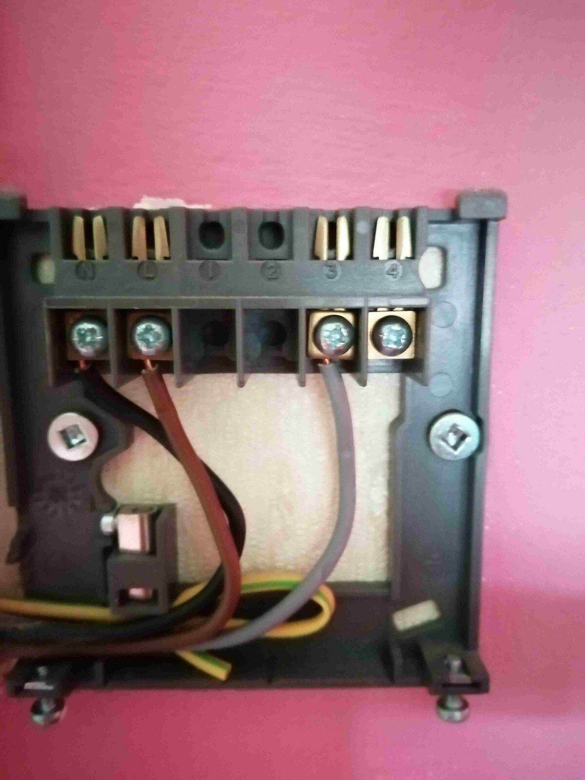

Hi
I would replacing my old mechanik thermostat with new digital wireless thermostat
my old thermostat is danfoss ret230L
I bought one wireless digital thermostat but there is 6 terminal to connection
1. A wire which is permanent Live (Terminal 4) - 240v 50Hz.
2. A wire which is connected to the Neutral (Terminal 3)
3. A powered wire from the programmer (Terminal 5)
4. A switched live which signals the demand for hot water to the central heating system. (Terminal 6)
I dont know how to do
L to the terminal 4
N to the terminal 3
but where can i put the old thermostat terminal on conection?
shud i put on terminal 6 ?
Thank you for answer

I assume it’s your house with the red wall. If so.
4 and 5 brown
3 black
6 grey
You will need to put your timer CH to always on.
