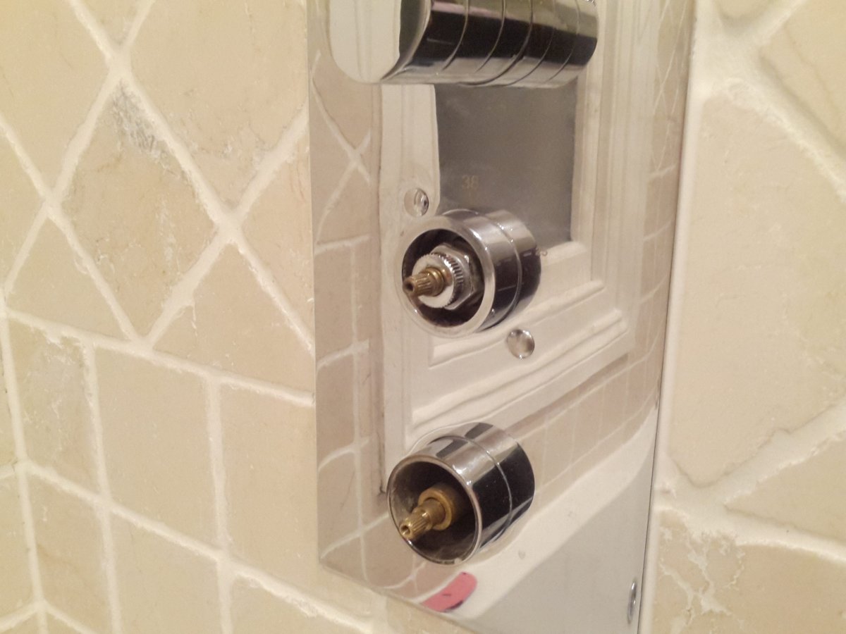

I am having a problem similar to that of the OP, ie I am trying to access the cartdridge in a metro valve.
I have removed the handle and the first collar but I am not sure how to remove the 2nd collar. See picture.
If I look at the instructions it is simply screwed on but I cannot unscrew it by hand. Do I need to remove the front panel first? This would also not be so easy becuase of the screws and the covers for the screws that I have not taken off before (they don't come off with a stanley knife) and of course having to replace all the silicon. Thanks for any help!
