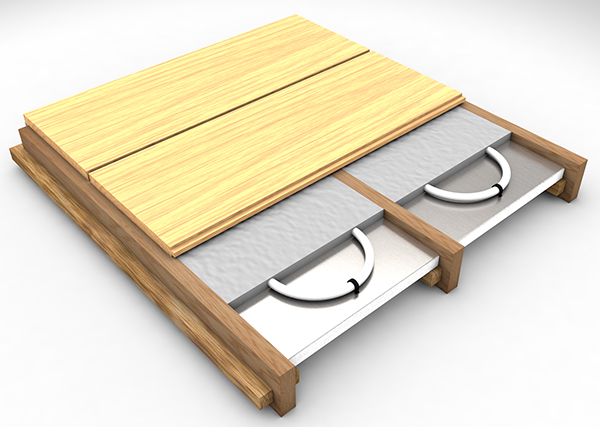

I'm thinking of replacing the timber sub floor with concrete as we are planning on installing a water UFH system.
Can someone please advise me how this concrete floor should be constructed? I'm planning on getting someone in to do it but would like to know what's involved.
Why not use screed, so much cheaper and easier than the crap aluminum plates.
The original post is lacking details of the exact floor construction. There are a lot of methods that end up with wood on top. In the end you need 4" of insulation on a firm base with 60-70mm of screed on top in which your UFH pipes sit. In the worst case the under floor void can be 1.5m deep that a lot of back fill or some sort of block and beam floor to be put in. Hence my comments about the plates. 100% of the effect for 5% of the work.

You screed between the timbers ontop of the board and pipes. So 25mm screed. It's less work than the aluminum plates and it actually works unlike the plates. You get some thermal mass which is important with underfloor heating. Plus you can only infill upto 600mm so you could not fill 1.5 meters of void.
