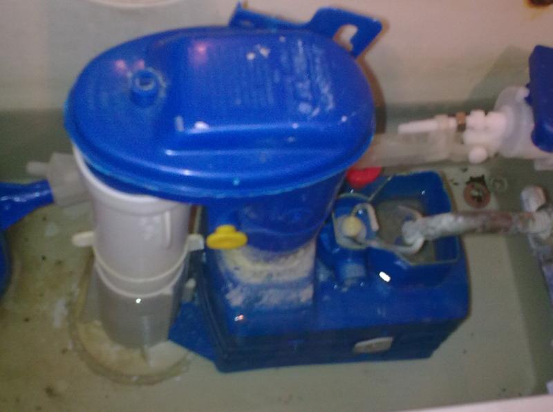

Replacing toilet syphon
You Dont need to change it If you take the yellow pinout you can remove the siphon without takeing the toilet apart if its close coupled and get a replacement diapram for it
yes it will fit fine, but the syphon you have (called a turbo syphon, i think) is a great one to take out and fix, turn off the water, remove the yellow split pin and lift the blue section up and out, if the prob is poor flush the washer will be burst, simply cut a new one from thick plastic (rubble sack is best) i would not normally rewasher a syphon as you have to completely remove the whole thing to get to the washer, you are far better fitting a new one, but you can take yours out in 10 secs it might be worthwhile looking at a repair
Thanks all, it's not close coupled and access is really good so for the sake of a fiver I'll probably just replace it :)
