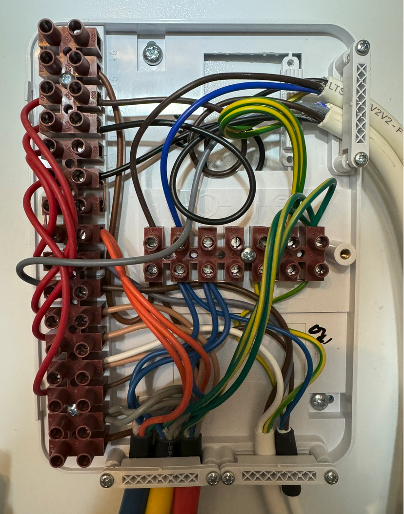

The hot water tank has three plastic ‘boxes’ on the outside. In our case the wiring is in the middle one. The lower one has the cylinder thermostats and immersion heater. The upper one has a second immersion heater & thermostat, but it’s not wired.

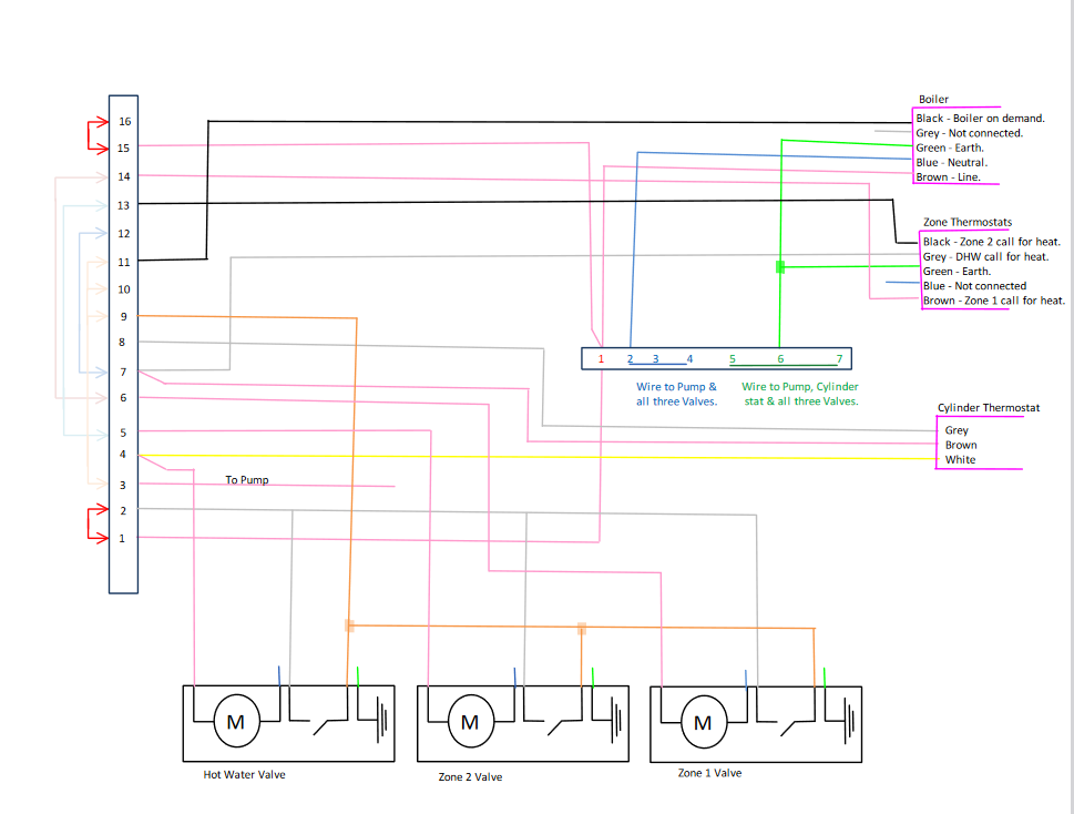

The first photo below shows the current wiring inside the box. The cables on the bottom go to the three valves, the hot water thermostat and the pump. On the right side, the top one seems to be Line, Neutral, Earth and ‘boiler on request’. The lower one seems to be Earth and the three calls for heat from the wall thermostats.
The second snip is a schematic showing my understanding of the system as it currently is. Because brown and black look very similar, I have replaced brown with pink. White has also been replaced by yellow. The valves are drawn in full as they were (for me) the most difficult bit to get my head around. Most earth and neutral wires are indicated, but not drawn – the drawing is complex enough. It’s a similar story with the pump – it only has LNE and the line comes from terminal 3. All the pre-installed links are shown on the left side of the terminals.
My plan to install Hive.
1 remove the Brown, Black, Grey wires from terminals 14, 13, 7 (call for heat from the existing thermostats).
2 wire Line and Neutral to the two receivers – probably from terminal 16 (vertical) and terminal 3 (horizontal).
3 add wire from terminal 14 to terminal 4 on the 2 channel receiver – CH zone 1.
4 add wire from terminal 7 to terminal 3 on the 2 channel receiver – DHW.
5 add wire from terminal 13 to terminal 4 on the single channel receiver – CH zone 2.
6 That’s it, apart from getting the hub on line, pairing the receivers, sorting the time/temp schedules…
Anyone spot my ‘deliberate’ mistakes?

Sorry, I have only just found this post - you may have completed this by now!
The deliberate mistakes I see...
That would go to terminal 3 of the single channel Hive receiver.
You would also need to add a short link wire from L to terminal 1.
Following wiring regs, a green and yellow earth wire should also be connected to the Hive backplates, even if they are unused.
Apart from that, I think you have a plan!

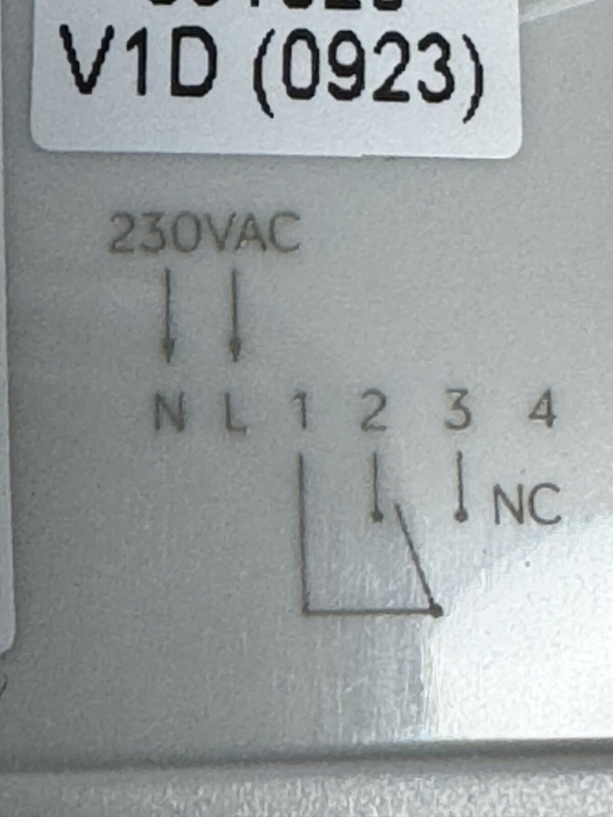

I started poking around with the Hive kit today – especially the single channel receiver (my weak spot). I got very confused when I saw the diagram on the back of the unit (see photo).
I have been thinking about valves a lot recently, so I immediately decided that NC meant “Normally Closed”!! But that did not make sense with the rest of the drawing – what’s going on.:unsure:
I was part way through wiring it up to a test harness, when the light bulb went off: NC – “Not connected”. Ah, that makes much more sense, pin 4 is Not Connected. Panic over!:rolleyes::giggle:IMG_7600.JPEG
Finally got round to making the changes during the week and can report that it all looks ok - no fires or floods!
