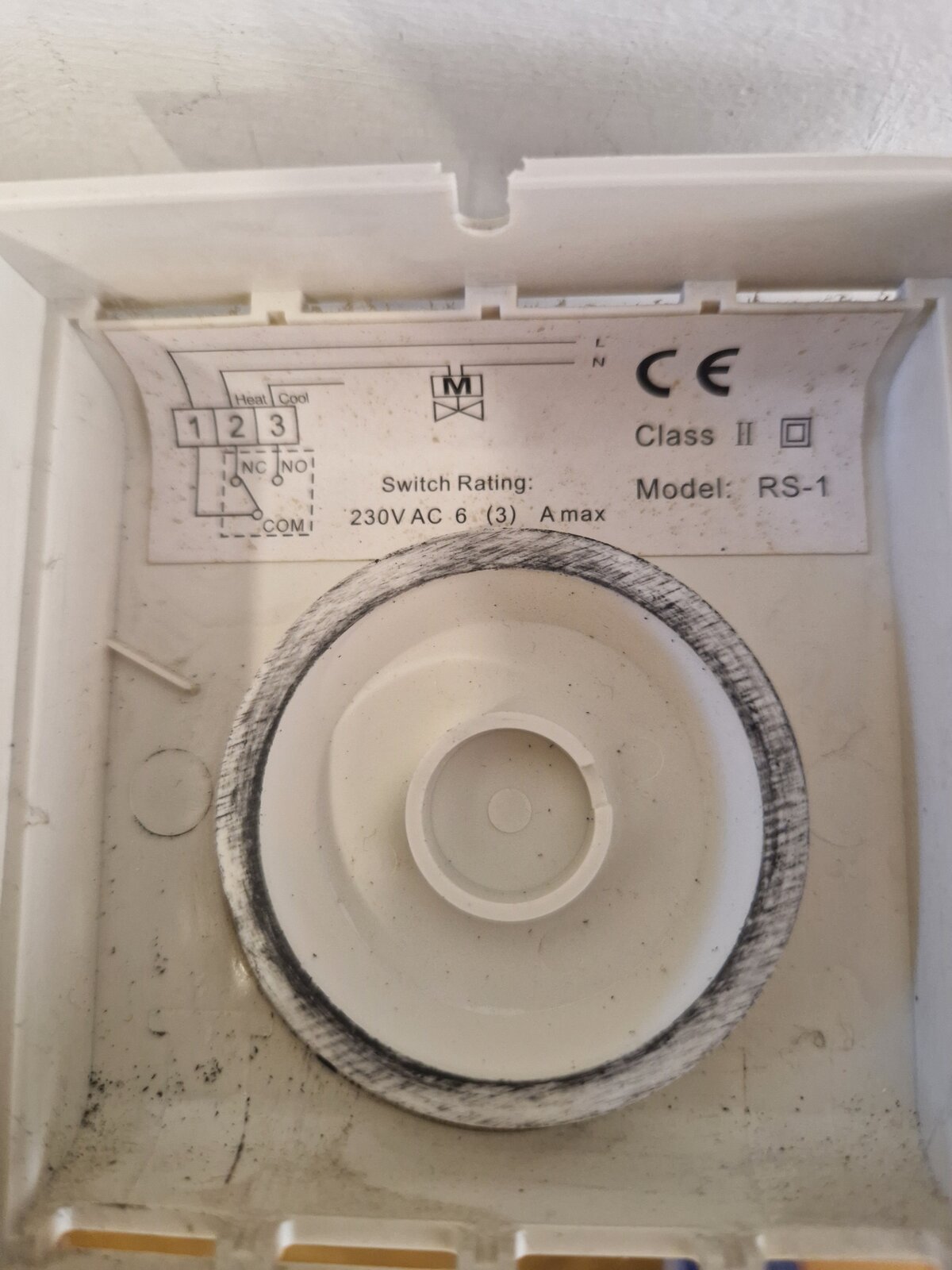

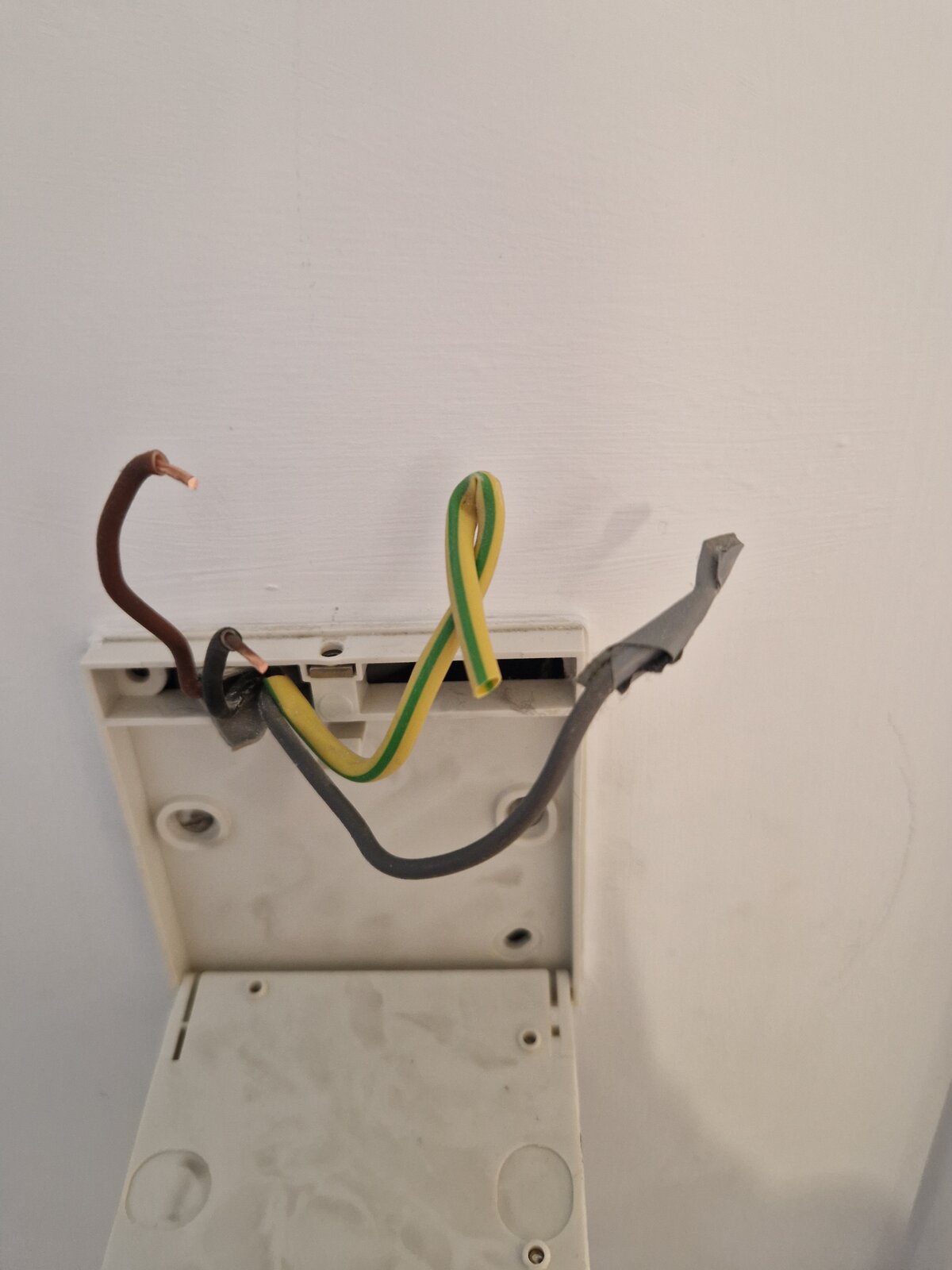

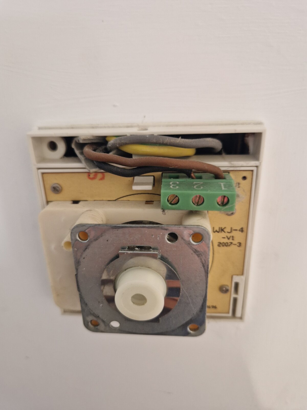

Morning, hoping someone can help. I've got a Tower wall thermostat that is not working and have been thinking about upgrading to a Google Nest smart thermostat. I have a Potterton Titanium 28 combi boiler.
Is Google Nest compatible and a straight swap?

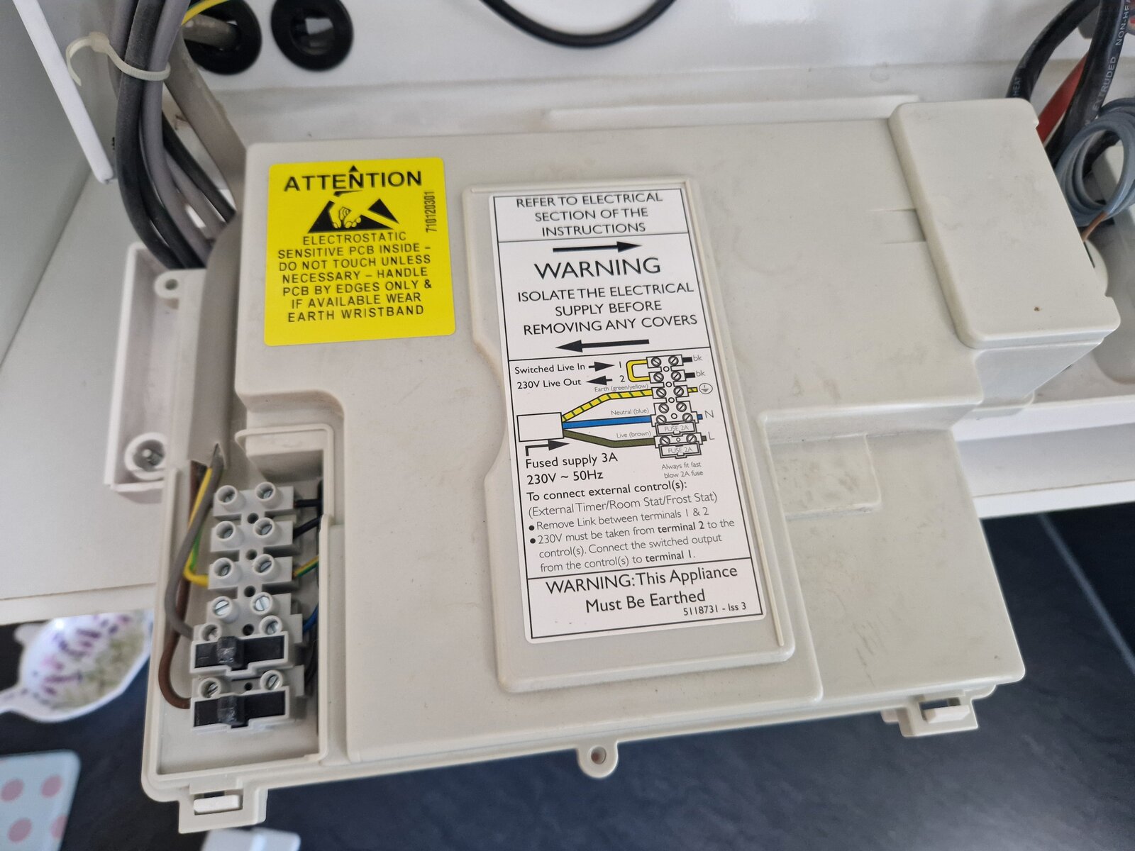

Hard to tell but it doesn't look like anything is connected at the boiler end. Nest isn't a straight swap, and how are you planning to power the thermostat itself? Or were you thinking of the Nest E? Which would be a straight swap, providing the wiring is ok at the boiler end.
I meant the Nest E as the boiler is fitted inside a kitchen cupboard so no room to install a receiver next to it. In terms of wiring at the boiler end, what do I need to check?
You have brown (L), Grey (N) and green/Yellow (E) there are 2 terminal connections above those which are live and switched live - are there wires in both?

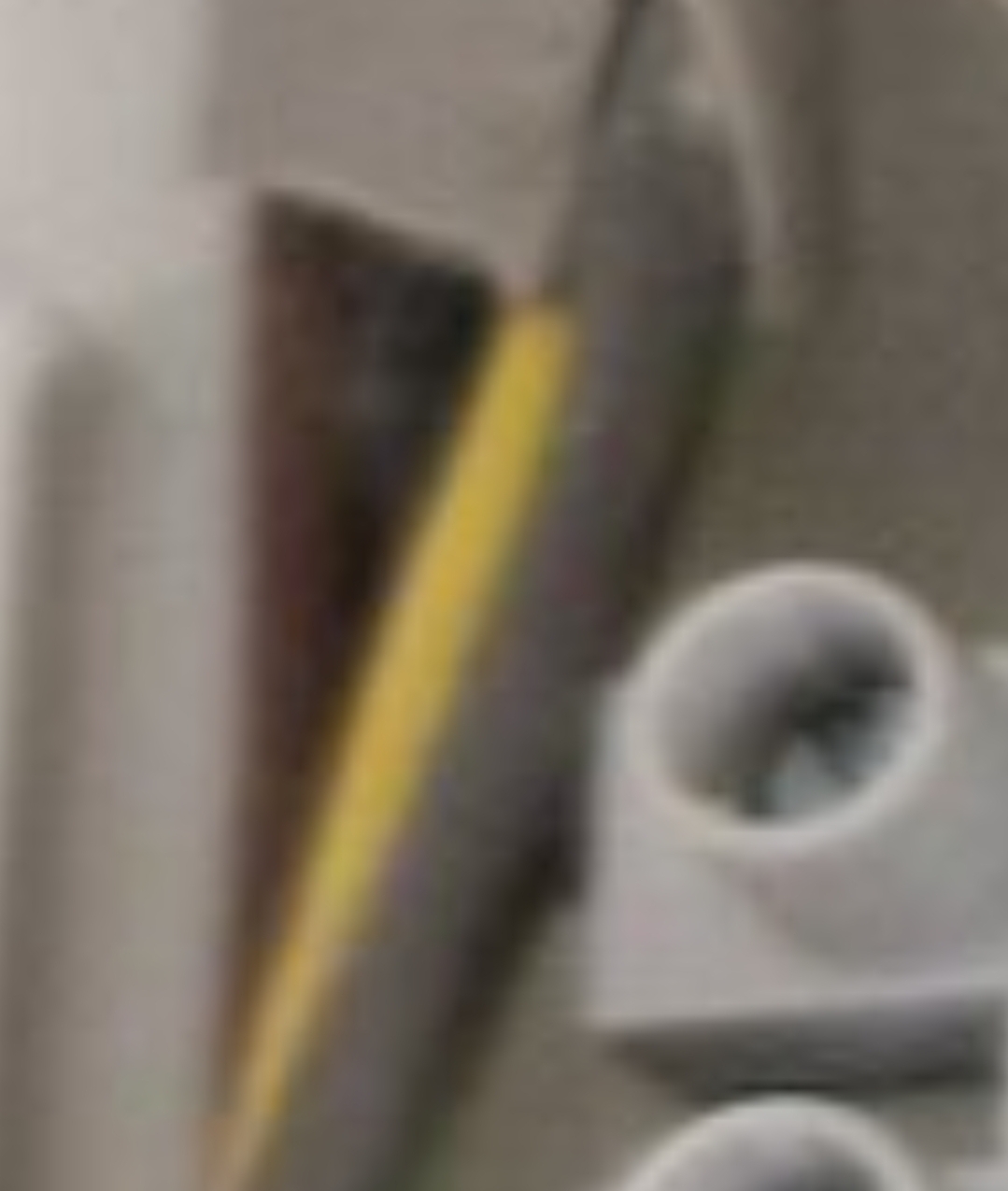

Looking closely at the photo, there is a black wire from the triple and earth in the Live Return terminal 1 of the boiler.
It may be difficult to see, but with a visible grey and brown core, there is almost certainly going to be a black one hiding as well.

The picture says line must be taken from terminal 2, which is clearly not the case, so what next?
