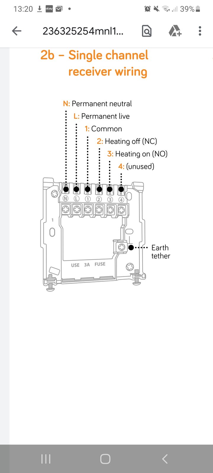

Hi
I'm trying to replace an existing heatmiser rf thermostat with a hive. The wiring from my boiler (worcester botch greenstar 30i) goes to the current rf switch as shown in the photo. Can anyone advise on how to rewire to the hive receiver? I've not got the hive yet but am assuming the single channel is the right one?
Many Thanks
Gareth
The single channel is the correct version for a combi boiler, that doesn't have a separate hot water cylinder. You simply move the wires from the Heatmaster terminals, to the same terminals at the Hive. So, the wires in:
Heatmaster COM1 goes to Hive (1) also marked COMMON
Heatmaster NO1 goes to Hive (3) Heating On & also marked NO
Heatmaster L goes to Hive (L)
Heatmaster N goes to Hive (N)
Heatmaster E goes to Hive Earth Tether [Although it's not good wiring practice to use a grey wire as an earth conductor, even though it has green / yellow tape on it. :rolleyes:]

Stem, that's great. Thanks for the quick and clear reply. As you can see my earth and live both have two wires, am I right in thinking I just keep those together in the new terminals as you've advised?
I don't think there's any other timer, the only other part of the "system" is the heatmiser wireless thermostat which I what I'm replacing as it is broken.
Gareth
The wires stay electrically connected as they are, they just move to the corresponding terminals at the Hive. So if there are two wires in the Heatmaster terminal, the same two wires go to the corresponding terminal at the Hive.
