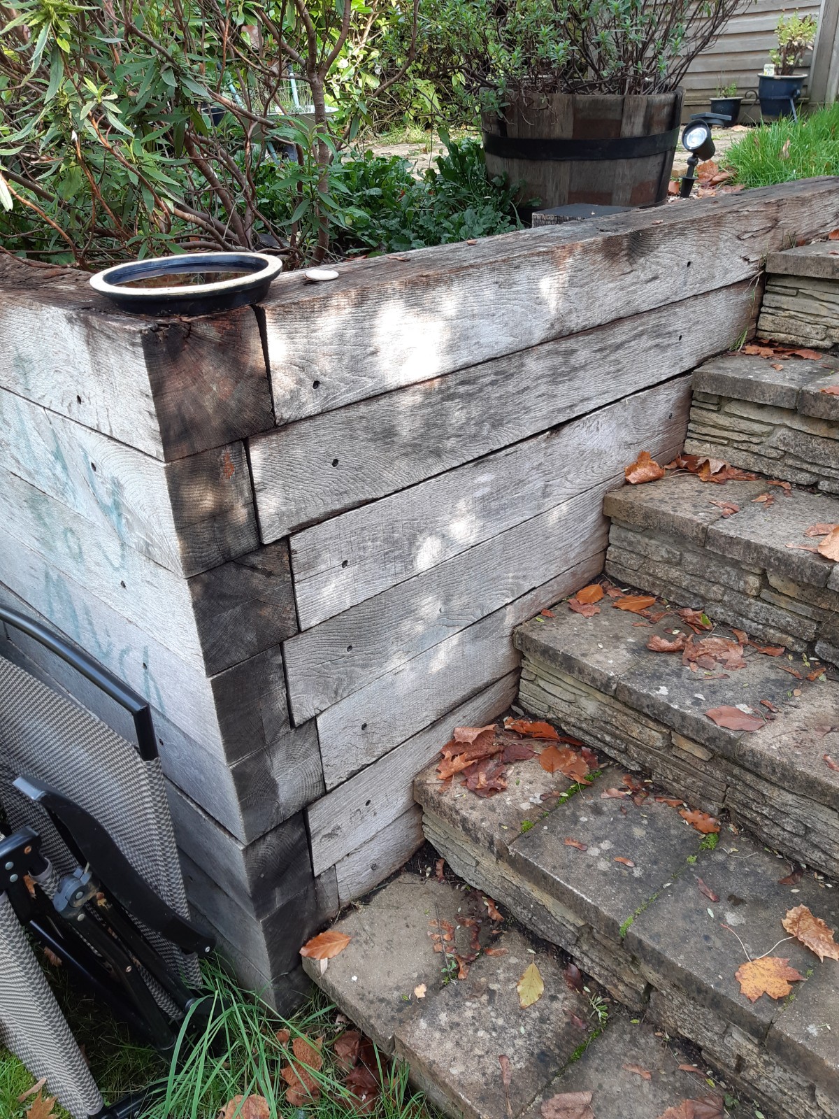

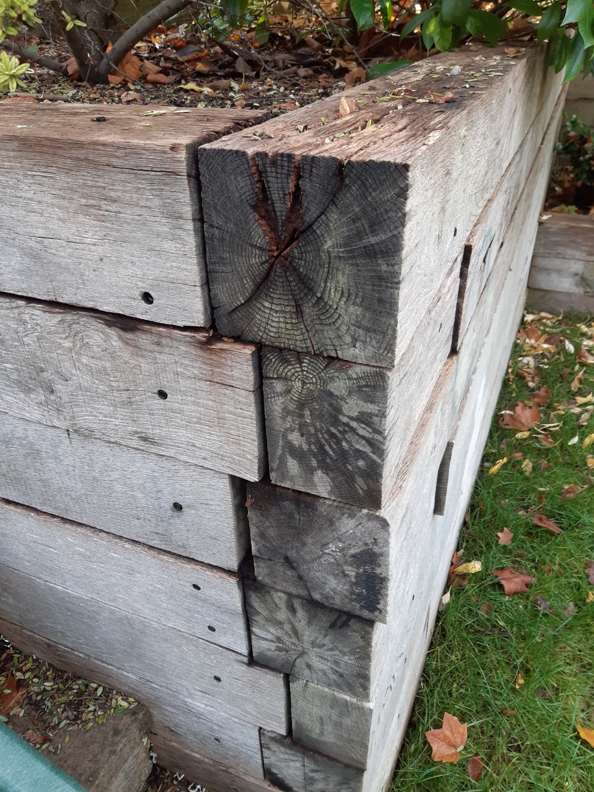

Hi, a very well respected tradesperson visited today and quoted £7k (inc VAT) to replace sleeper retaining walls (pics attached) which help terrace a large part of our garden, with a blockwork solution that i could paint, render or clad. I appreciate that it's a lot of labour and a ton of blockwork, digging out the existing, putting in footings etc etc
I wonder what other options might work? i like this idea, and could perhaps have a go at this myself, placing the new solution just infront of the rotting existing walls: https://i.ebayimg.com/images/g/LAcAAOSwVxZfUkqy/s-l1600.jpg
My wife likes these, but i wonder how rust-free these things are? https://cdn.manomano.com/gabion-basket-galvanised-steel-200x50x100-cm-L-356281-5610587_1.jpg
The first solution only appears to be available from very few firms too, whereas the gabions are available all over the place.
Anyone have any experience of either/both option and can please advise?

The gabions will be made of galvanised or similar, so unlikely to suffer rust any time soon, given they are designed to be dug into the ground.
Your sleeper option would work- you could just use an appropriately sized RSJ and slot the sleepers in- ive seen this used a few times and it works well.
Whichever you choose, I would remove the previous wall
My daughter has gabions. Been in about 5 years and no signs of rust. As her outside wall at the back she has some heavy duty H section ally beams and concrete sleepers with wood graining. Both look okay once they have been in a while and settled in.

If you use wood, then a load of rotting wood just behind it is going to shorten the life of the new wood.
For the gabions, they are likely to be much deeper, so you would lose quite a bit of space if you didn't dig them back into the retained soil a bit

I would leave the sleepers where they are and build a brickwall to cover them, so on the outside.
You would avoid dismantling what's there and have a better look.
Steps would be 4 inch smaller though.
Thanks Johnny, this builder wants to replace steps in order to remove replace the existing sleepers. Are you suggesting build onto existing steps? They are firm so could be an option. Thanks
Yes, i don't see why not.
The only downside is that the steps will be 4 inches smaller, but the whole project would cost a couple of hundreds instead of £7k.
