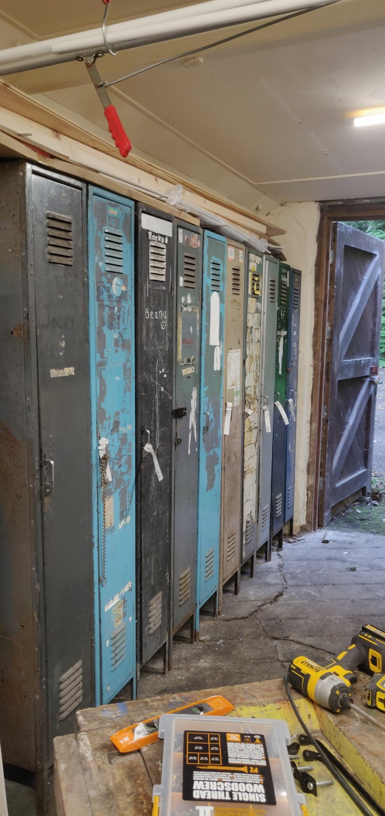

I got 10 of these, I maybe mentioned before. I think they're a foot square.
I was planning to just put shelves in them and I probably will for some stuff, but then I thought about hanging tools inside the walls and was thinking about pegboard. I reckon it'd look pretty cool and I'd be able to find stuff.
But I need to find some I can cut fairly easily. Any suggestions? Nobody local seems to stock it so I'm reliant on online reviews and recommendations.

I'm almost thinking about using this as shelving without the shelves... Maybe for small power tools and larger hand tools. I want my storage to be enclosed so even if each locker is a single column of items, 10 of them is a whole wall.
We'll see. If anyone's interested I'll post photos as I figure it out?

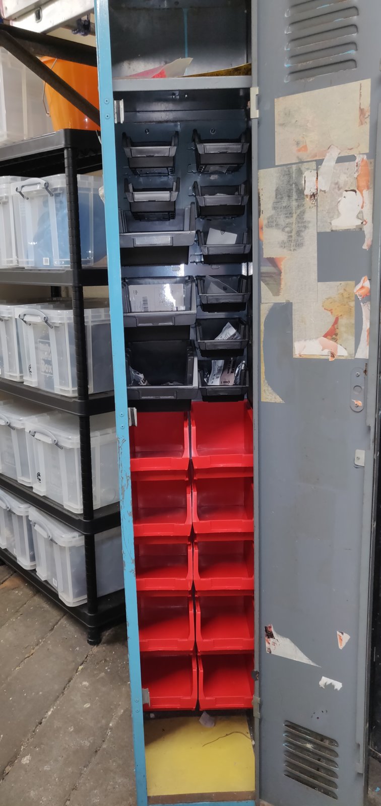

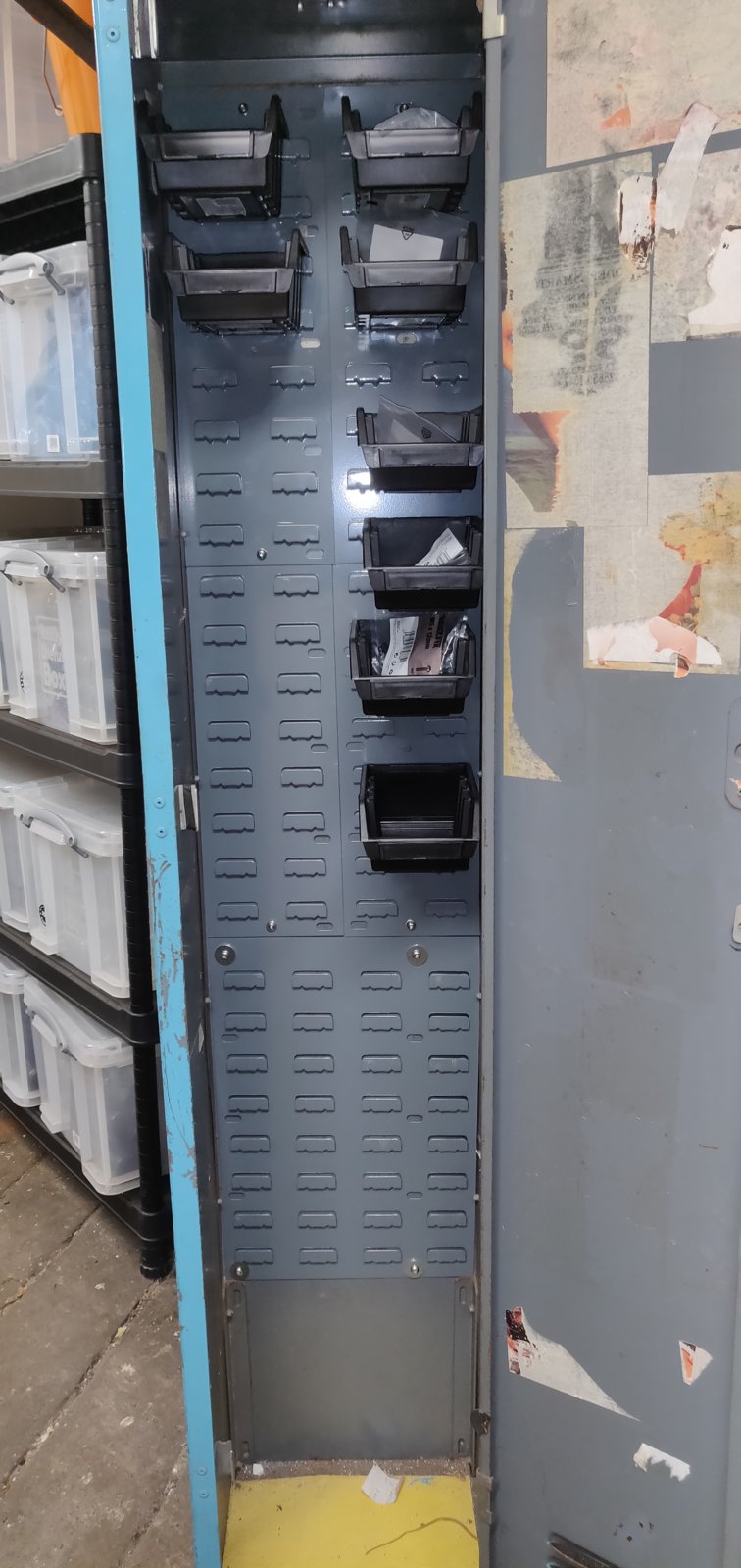

So I got one locker sorted, this one using louvred panels for bins. I was pleasantly surprised that the red bins (heavier duty) fit two side by side perfectly... The cheaper black ones are just a bit too wide.
