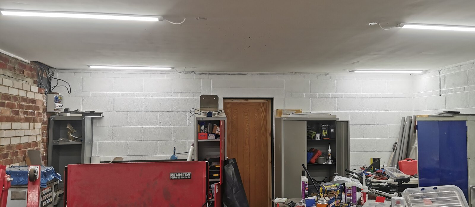

Hi all,
I need to run a soil pipe horizontally across the ceiling of my garage and need to know the required fall.
The run will be just over 6m horizontally and serve a full bathroom upstairs, everything will drop from a short vertical stack upstairs in the top left of the garage ceiling into the horizontal pipe then meet another vertical pipe the other side of the right hand garage wall down into the manhole.
Chris.
Thanks so that means the right end should be 15cm lower than the left, that's going to be interesting with a 90 degree connector on each end.
they're not 90 degree, they're 87 1/2 (ish) to allow for a fall of 2 1/2 degrees
