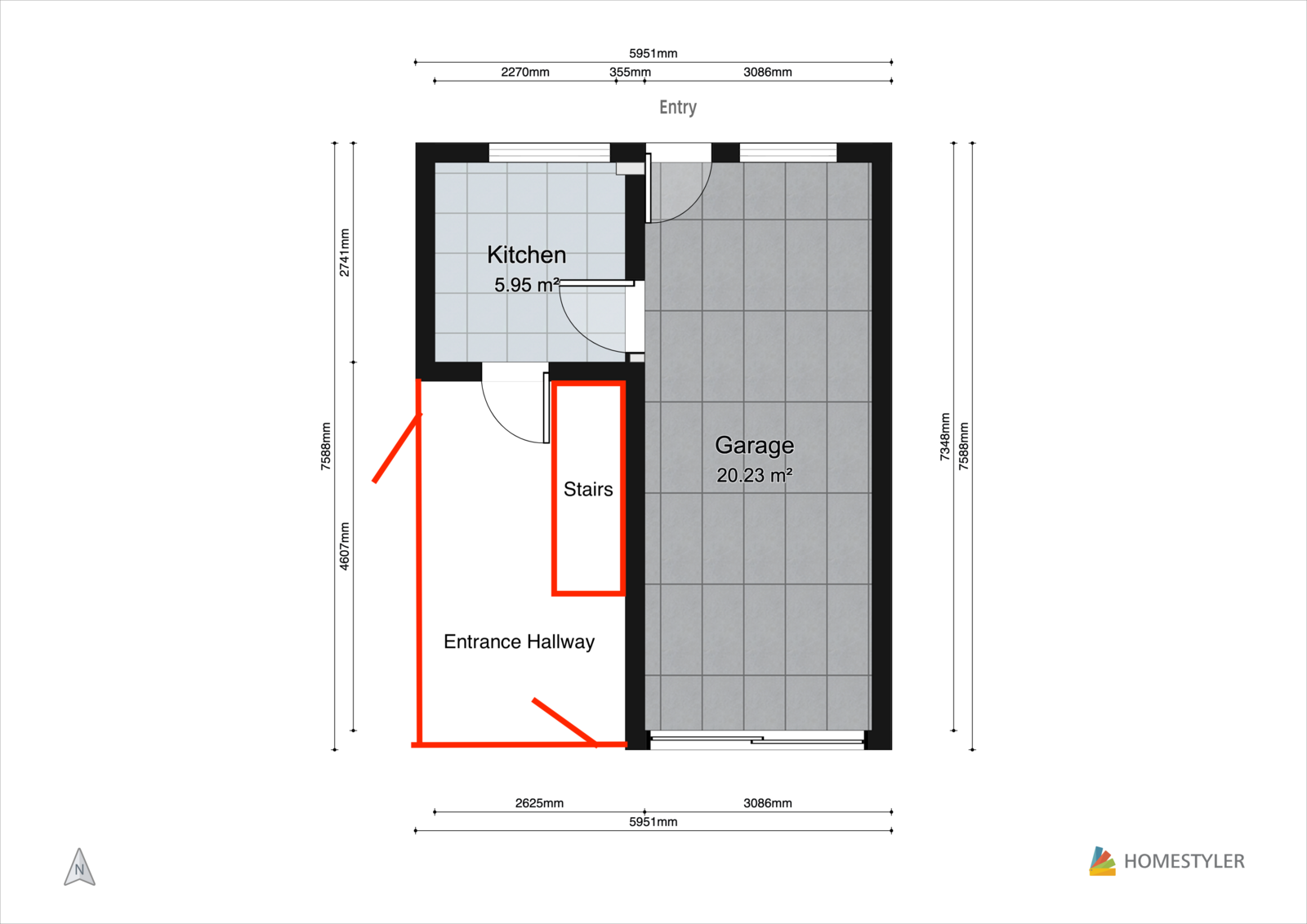

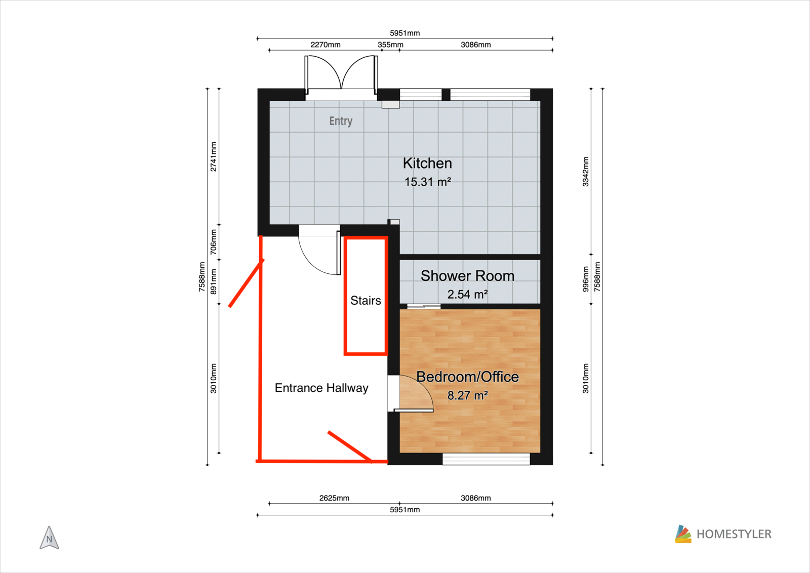

Hello, I'm in the process of having my garage converted. We're knocking through the kitchen to make the existing kitchen larger, adding a front bedroom/study and a shower room. (Please see attached before/after plans to show the rough outline).
I currently have no mains alarms in the house (plenty of battery ones), but understand I need a mains heat detector in the kitchen as part of the works. My electrician suggested this is all that would be required.
However, building control inspector suggested I would need a mains heat detector in the kitchen, a mains smoke alarm in the hallway and a mains smoke alarm upstairs on the landing - all of which should be interconnected.
Does this sound correct?

Not 100% sure but I think the building inspector is correct and given he is the one who will sign it off as habitable I would tend to do what he suggests.
I guess I'm a bit unsure as to why I would need to put one upstairs too as this work has no impact on anything above ground level - means of escape don't change (if anything they improve).

1.9 Smoke alarms should be provided in the circulation spaces of the dwelling in accordance with paragraphs 1.1 to 1.4.
As the new bedroom/office seems to discharge in to the ground floor hallway and the kitchen has a door directly to the outside I would say this requirement does not therefore apply in your case.
Having said that personally I would install the interlinked mains smoke/heat alarms even if they are not technically a statutory requirement.
