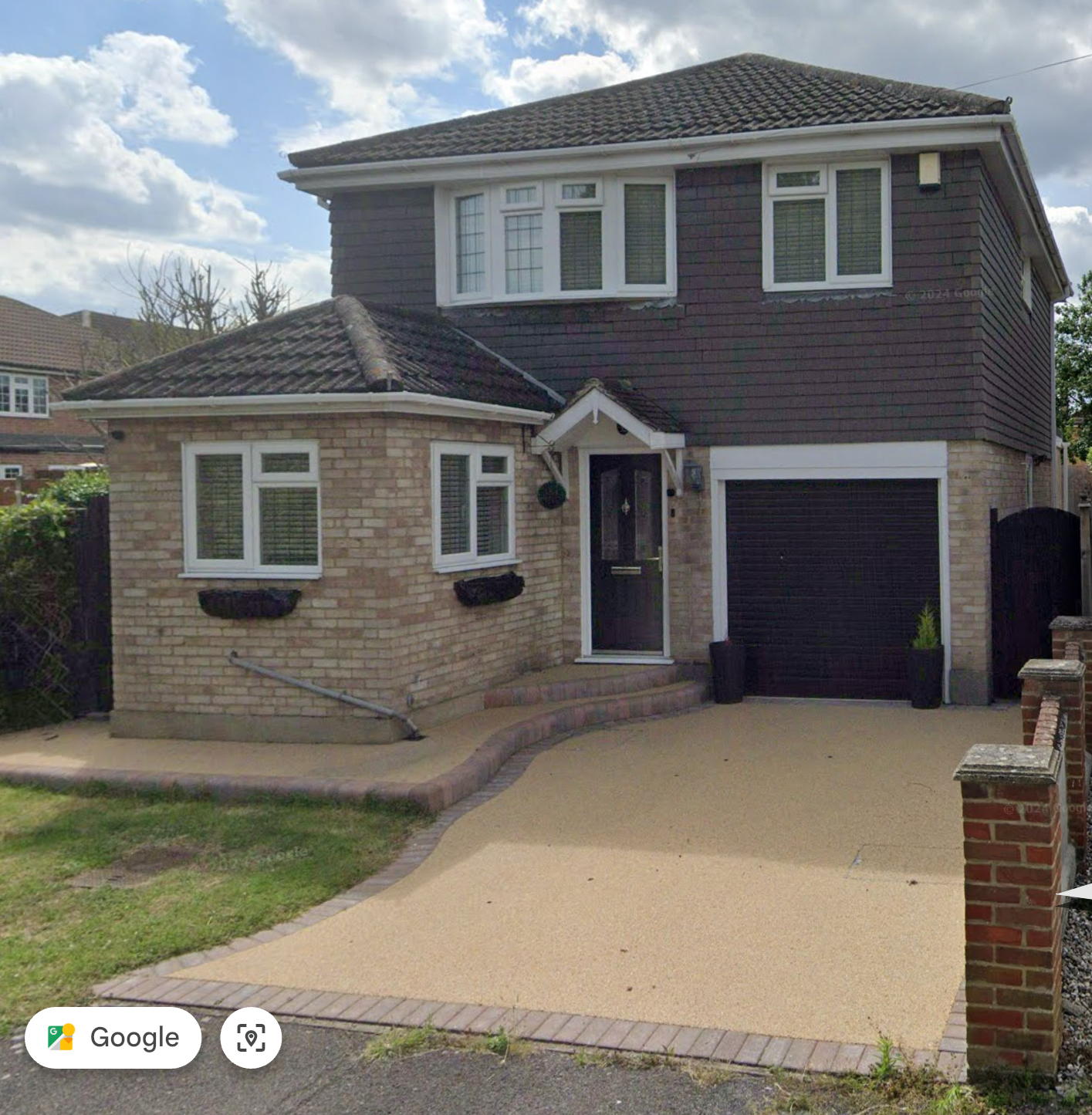

Are they 'permeable'? Mrs Mottie is selling her mums house, she had a resin drive laid about 3 years ago. Replaced a red brick type drive. Solicitor for the buyers are asking. She doesn’t know. It hasn’t got any drainage grids.
I would say no, but looking at that, the water would drain down the slope and away form teh house.

There's two types
Resin bound - stones mixed with resin - permeable.
Resin bonded - stones stuck on a layer of resin - impermeable.
If you can see the resin, it's permeable.
I saw someone laying the stuff on youtube, so I'm now an expert!
They put "no fines" concrete under it, basically 20mm gravel, cement and water. It's full of holes, they wacker it in. It sets hard but is probably more permeable than a lawn.

My neighbour had it installed recently and his is permeable. To a point anyway. I assume the rain will hit the clay underneath and then the pores will be full of water. I did wonder if this would ever cause it to blow in future with freezing. Impermeable might be better, subject to the water running off away from the house.
Anyway, I'd just say "we think it is permeable but are not certain". Leave it at that. Let them figure it out. If there is a concern about planning or whatever, you can always just pay the 80 quid for their future insurance against issues. Or they can pay it.
