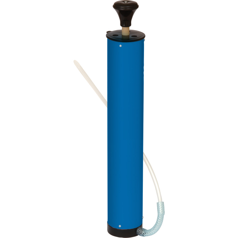

there's a lot to be said in favour of pilot-drilling a frame, getting it up into position (packed and wedged as required) then drilling through the frame into the stonework where it's been piloted. And those "Swedish" pumps are faster and more efficient than a vacuum:

Thanks. I searched "Swedish pump" and will now have those things cropping up in my targeted ads and Amazon recommendations. o_O:mad:

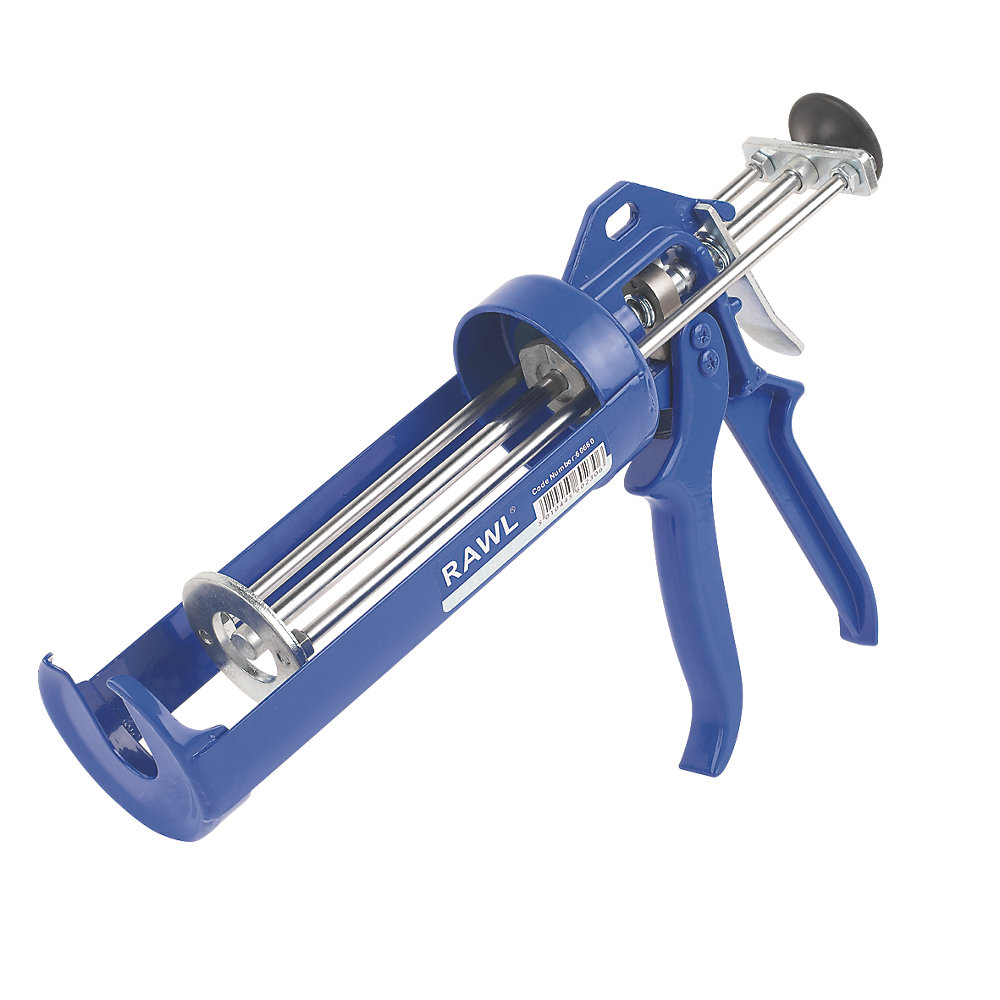

That's why when you are doing any quantity of the stuff it's better to go for one of the "big tube" systems and a matching heavy duty gun. Far less work...
The other reason is that the caulking gun size tubes can wreck lightweight caulking guns very, very quickly (that's the cheapo £1 guns I'm talking about)
