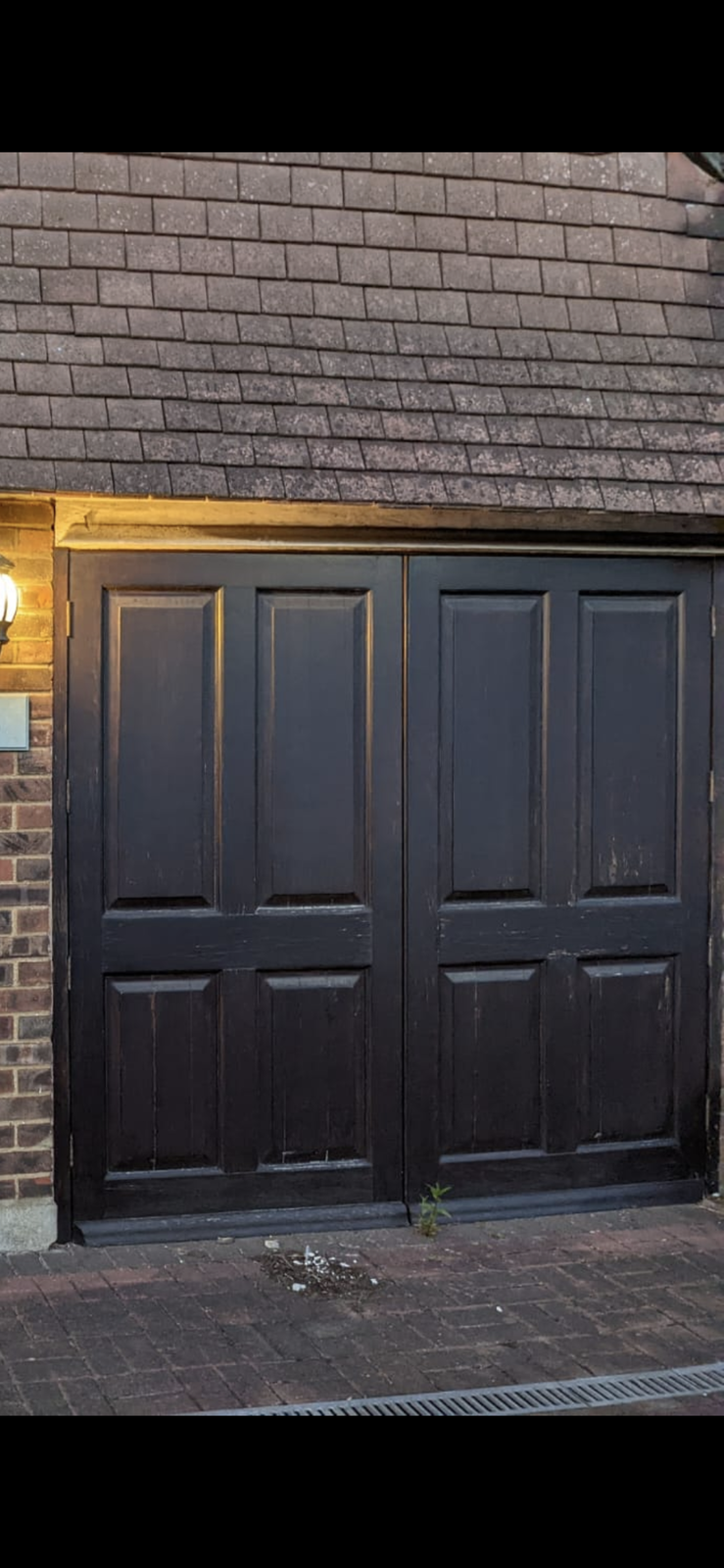

The wooden garage doors (in the attached picture) need to be resized or protected to stop them from repeatedly swelling in wet weather and then becoming stuck as they drag against the ground. Water tends to collect in a pool directly in front of/against the doors.
How best to do this, please?
I assume I remove them, shave a little off the bottom, and then apply a waterproof coating?
Or can then remain in situ, and a coating applied during the dry months when they work ok?
Any advice much appreciated

Thanks @HERTS P&D . Is it possible to apply a rubber seal of sorts? I don't want any moisture coming under the doors

You cannot stop wood expanding and contracting due to temperature and humidity, even internal doors do it - all you can do is allow for it. You need to have a few mm shaved off the bottom.

Thanks that's helpful. So if I shave enough off to allow for the seasonal expansion, is there a rubber seal which I could attach that offers a barrier against water coming in under the door?
Water should not be coming under the doors, adjust the driveway or fit a channel drain at the front of the doors to direct the water away into a drain/gully.

It is very unlikely you would manage to seal it with a rubber seal, it will creep past it. A more sensible solution is a dam on the concrete floor. You can buy ready made strips, which you seal against the floor, they were mentioned a few months ago in the forum.

Yes I think I've seen these, called stormguard or something. I'll have a butchers. Thank you!
