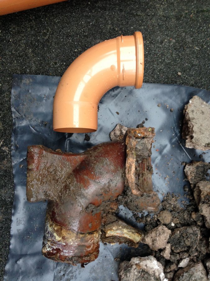

I know you need a rest bend or 2x45 bends at the bottom of a soil stack, but for a stub stack only serving a ground floor wc can I get away with a standard 90 bend? could have sworn I've seen this ok'd in the past but could be wrong!
reason is to reduce the depth of the pipe and lay after the footings are concreted ie avoid taking it thorough them. it will join a main stack about 2m away below ground.

I always (for the last 12 years) use a 90degree bend as a rest bend.
Reason being that all of the clay ones I replace are a very tight bend anyway.

I had to look it up and Building Regs Approved Doc. asks for minimum 200mm radius bend at base of a stack but not specifically for a stub stack. Its more to do with allowing the solids to easily go round the bend rather than hitting a sharp 90 degree bend and potential getting stuck or losing all the momentum.
What does BS 752 say? Especially in relation to any vertcal drainage - ie is there a difference?
