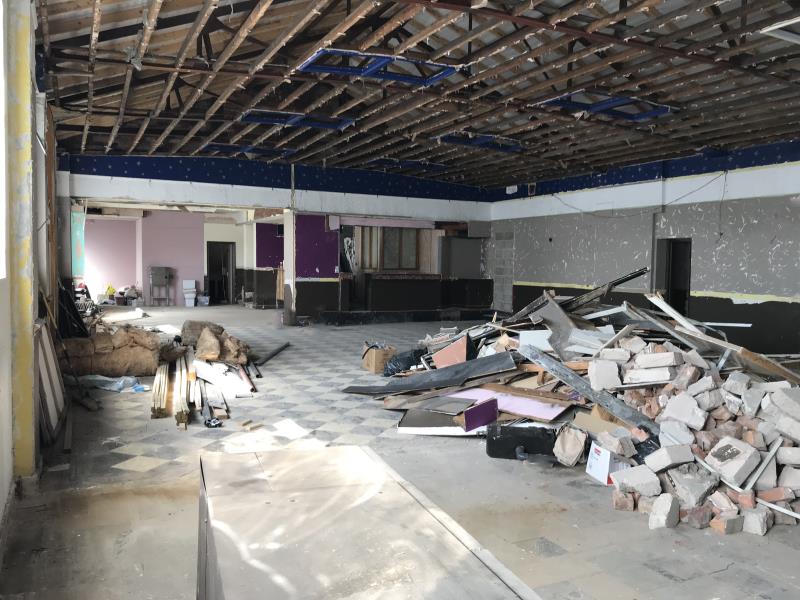

Just got this photo from an agent (going to view on monday)
What work and matirals do you think are needed please
boggington, good evening.
Roof looks like steel trusses, quite well apart, Asbestos bound cement covering? possibly "Big Six" ?
The timber supports for what was there look like 150 X 50???
There looks like the ceiling finish was plasterboard with rectangular lights set into the plasterboard??
Options are replace like for like, IE. Plasterboard + skim with insulation above, lighting ? up to you.
Or? suspended ceiling using metal frames and infill panels.
