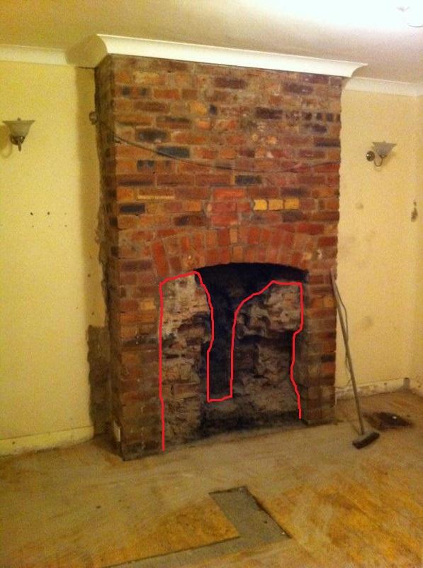

Hi new to this forum and a novice DIYer.
I have recently exposed a plastered chimney breast in my dining room and am looking on some hints and tips on cleaning up the brickwork.
I also need some advice as to whether it could do with repointing.
I have read articles about using milk paint to lighten the redness of the bricks a bit has anyone used this - any advice is appreciated.
I have uploaded a picture, red areas on pic to be removed at the weekend when I hire a breaker,
Thanks for your help.
Cheers
That brickwork is in excellent condition to be left bare, unpointed and untreated. Stiff brush it down, & accept it as it is. Painting or staining or (as some imbeciles do) varnishing will make the C/B look cheesy.
You dont need any "breaker" to remove those bits of infill brick - simply use a hammer and chisel to easily knock and pry them out.
The soot in the fire opening can be removed with a wire brush and its advisable to get the flue(s) swept.
Note: what are the dark smudges on the wall recess to the right?
Thanks ree,
The dark smudges are dirt marks caused when removing the plaster, the room is getting a full re-skim when all the major work is complete.
What about sealing the brick with a low sheen sealer after cleaning ?
