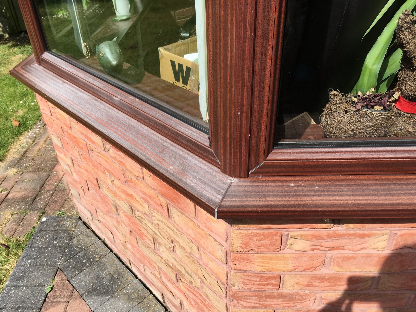

hi does anyone know the best way to restore sun bleached brown pvc please? The windowsill and frames on my conservatory and also on my front door are not looking good these days and need restoring.

Can you post a photo?
Without further information/photos I would say getting them professionally spray painted would be your only option, The bonus of that is you can have them any colour you like.
Armorall
The first time you spray it on, leave it to penetrate, and polish off the next day. In your case, you don't want it on the glass, so I'd apply with a soft painbrush.
Subsequently, after washing down, it's enough to rub it with a rag moistened with it. It's a sort of milky liquid that glosses and darkens the surface. Useful for rubber and plastic bumpers and waist lines on cars, also under the bonnet if you like that sort of thing. A spray bottle will last for years. You can use it on tyre sidewalls (not on bikes). Not on pedals or grips as it makes the surface slippery.
http://www.halfords.com/motoring/ca...cuums/armor-all-protectant-gloss-finish-500ml
or you can buy it in 5 litre or larger if you're in the car valeting trade.
It does not smell as much as WD40
Do the sills and doors, people may not notice dull glazing bars
BTW if you want to wash PVC doors etc, car shampoo and a soft brush (as used with a dustpan) is quick, mild and leave a bit of shine (but will not restore an eroded surface). Some household cleaners are much more aggressive.
Thank you all that’s very helpful and that ‘Armorall’ ,JohnD I willgive that a go.
