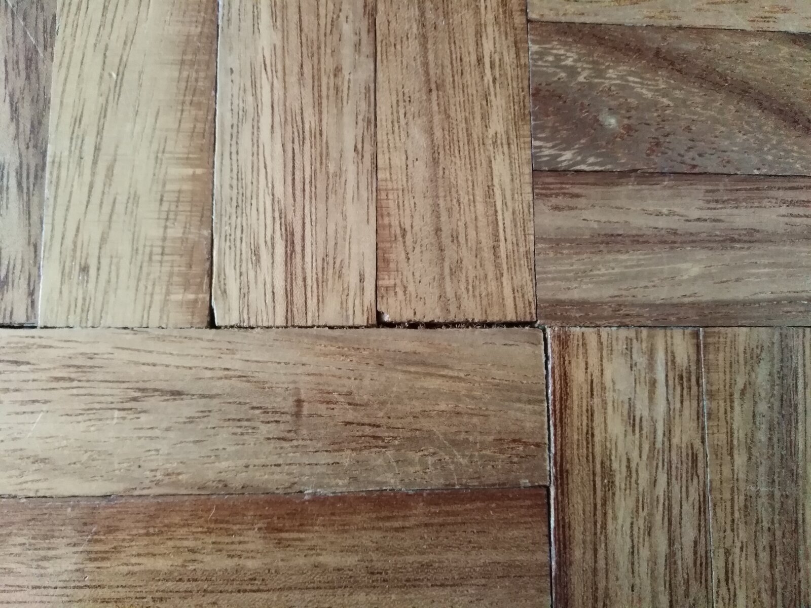

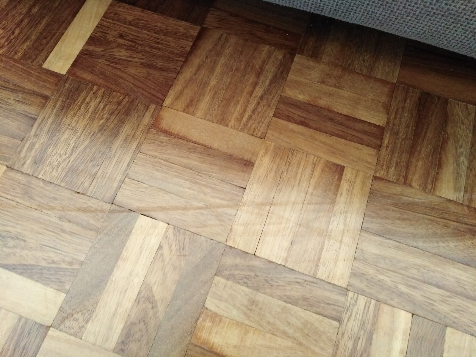

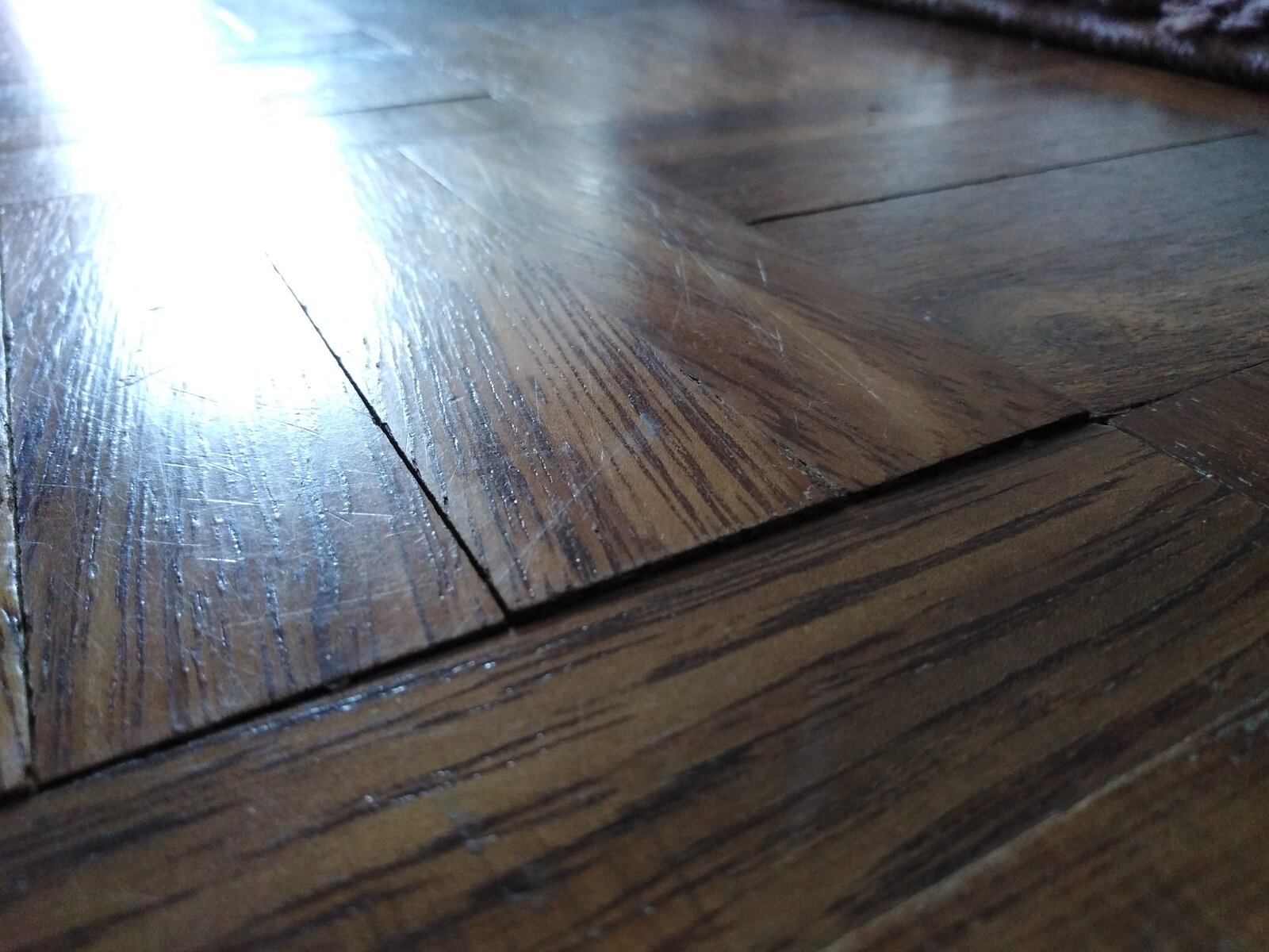

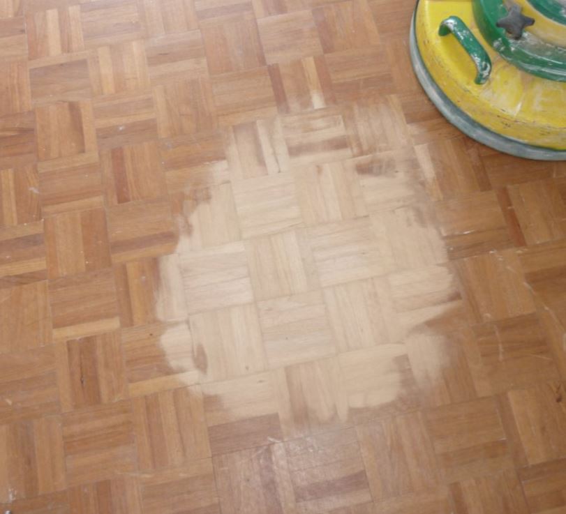

The following 4 photos in order show:
1. The general style and condition.
2. The biggest gap I have between pieces.
3. An example of a raised bit having come loose and been glued back down. The photo makes it look worse than it is. Its about 1mm above the level (so enough that I wouldn't expect a sander to level it out completely.).
4. An example of a scuff caused by moving furniture.
I didn't do the sealing step last time. I had panned to, but when the guy from the hire shop dropped the sander off he had a look at the floor and said the gaps were small enough that he wouldn't bother, suggesting that the varnish would fully seal them. It didn't fully do that, but it never looked bad enough to really bother me. Maybe if I had done it would stop some of the ones that come loose (although I think that's more down to the wife and kids walking on it with bare (sweaty) feet.

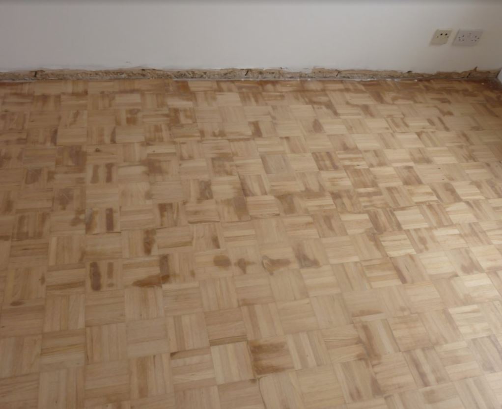

Well, Bison Products, the Sand Glider company, are still alive, well and living in Leyland, Lancashire. Why not give them a ring and find out which hire fleets buy them? Maybe also worth ringing around some local flooring distributors - they sometimes hire machines as well as supply consumables and finishes. I have to agree that it is easier to get good results with multiple head sanders like the Sand Glider
BTW sealing the gaps prevents moisture getting down the sides of the blocks and causing swelling/movement. It is therefore desireable

The one I have some experience of is Lecol 7500, which has the advantage (to me, at least) of being available, ex-stock, from local supplier. Have you found a local supplier, or can the hire shop help? It's all but impossible to tell, sight unseen, to even guess how much you'll need. Maybe ask your supplier for advice?

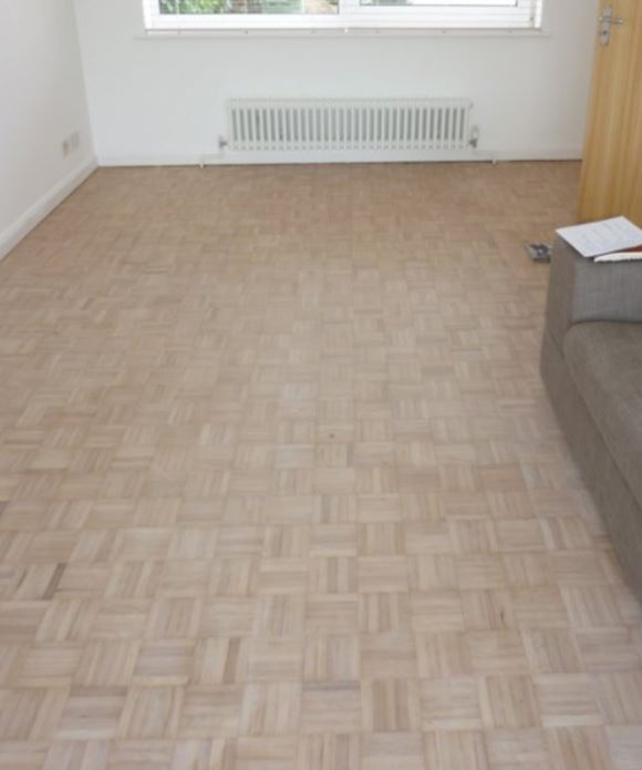

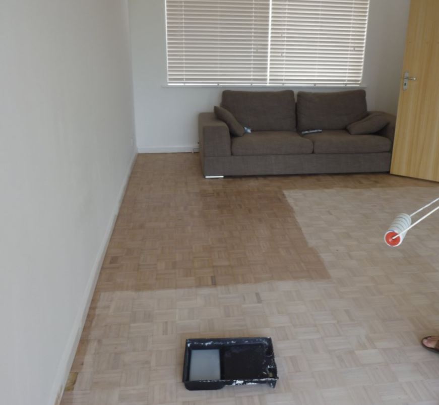

We did our floor about 10 years ago - we wanted a natural wood colour - not a varnished orange thing. We shopped around for products and literally everyone - said it was impossible and anything you apply to the floor will cause it to lift.
We went ahaead - sanded it down - kept the dust and used it to fill in the gaps in the floor - we used some sort of putty to mix with the dust - which matched the floor colour well.
We had our colour - as it was sanded down - and wanted to keep it - so we used a special wood bleach - and then sealed with a special sealer - the names of which have totally escaped me - but I have kept the containers - in case I needed it again - but 10 years later the floor still looks good - hasn't lifted and has kept its (natural) colour.
I can get the name of the stuff I used if needed.

Linseed oil putty is a good sealant for very light floors, but it won't work on dark timbers and it can't be stained
